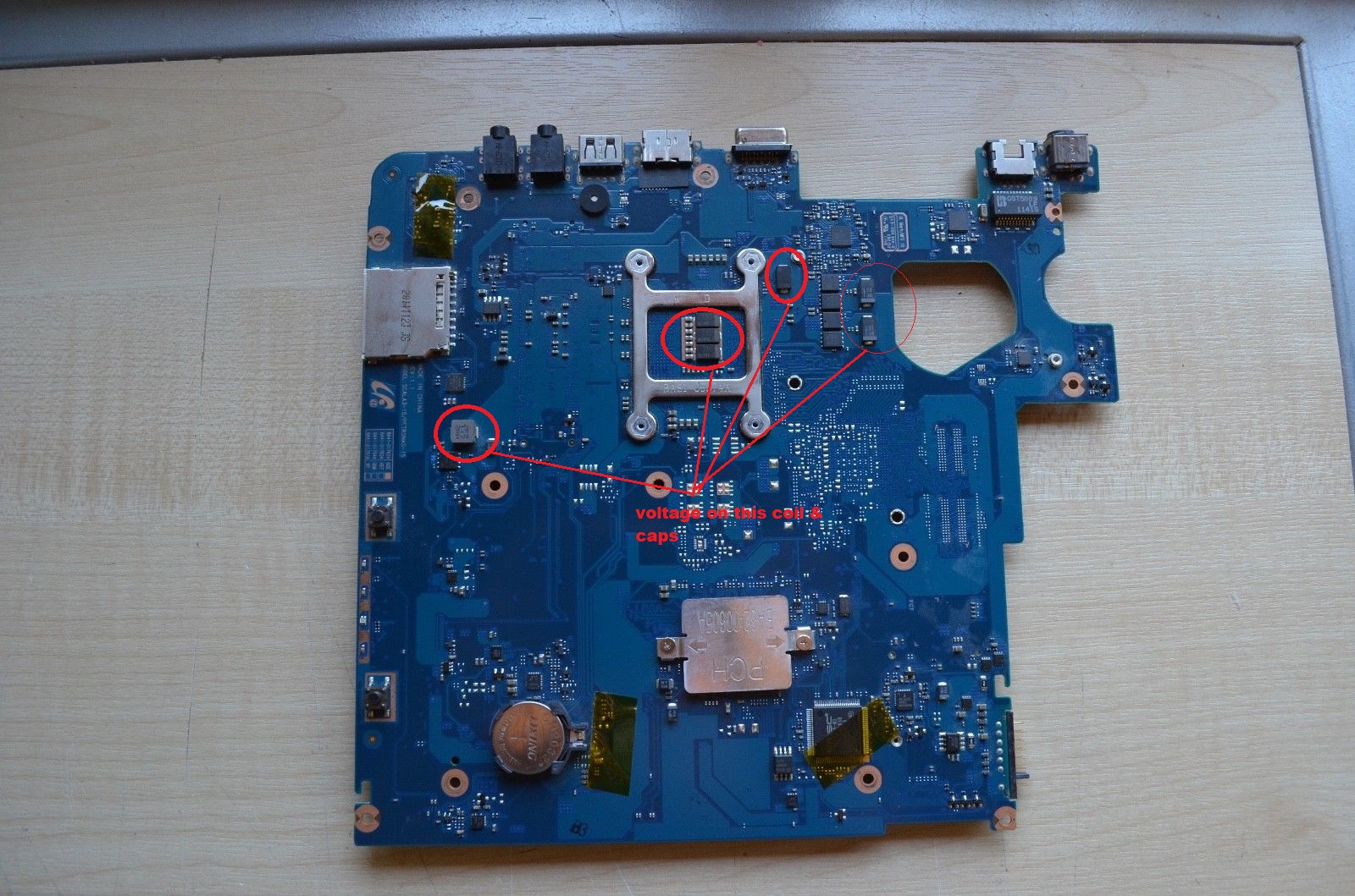

    clear memory card contacts
      Re: Samsung NP300E5A-A05ES doesn't start

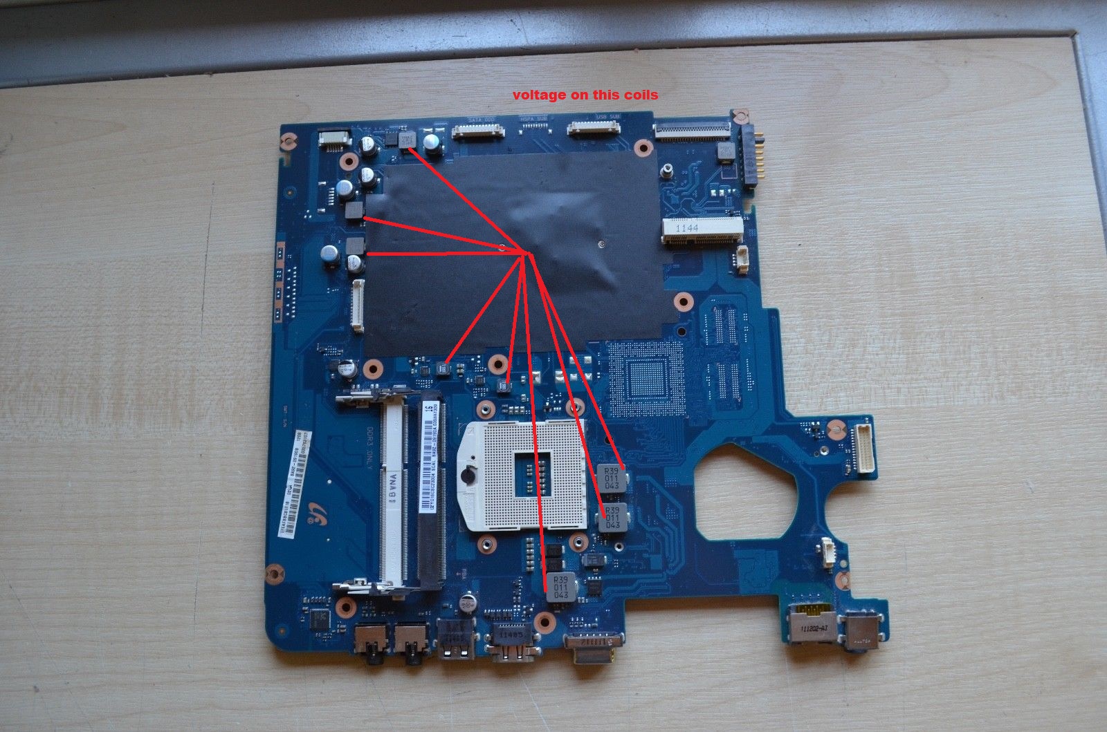

      Test the Voltage of each big Grsy Coils of the Mob and post it examples CPU CORE GFX ect with help of pic of MOB
        I've cleared memory card contacts, but i have the same response. I cannot check all the voltages because i don't have schematic of the board.
          if this your Mob come up with all voltages I have marked you can find similar schematic

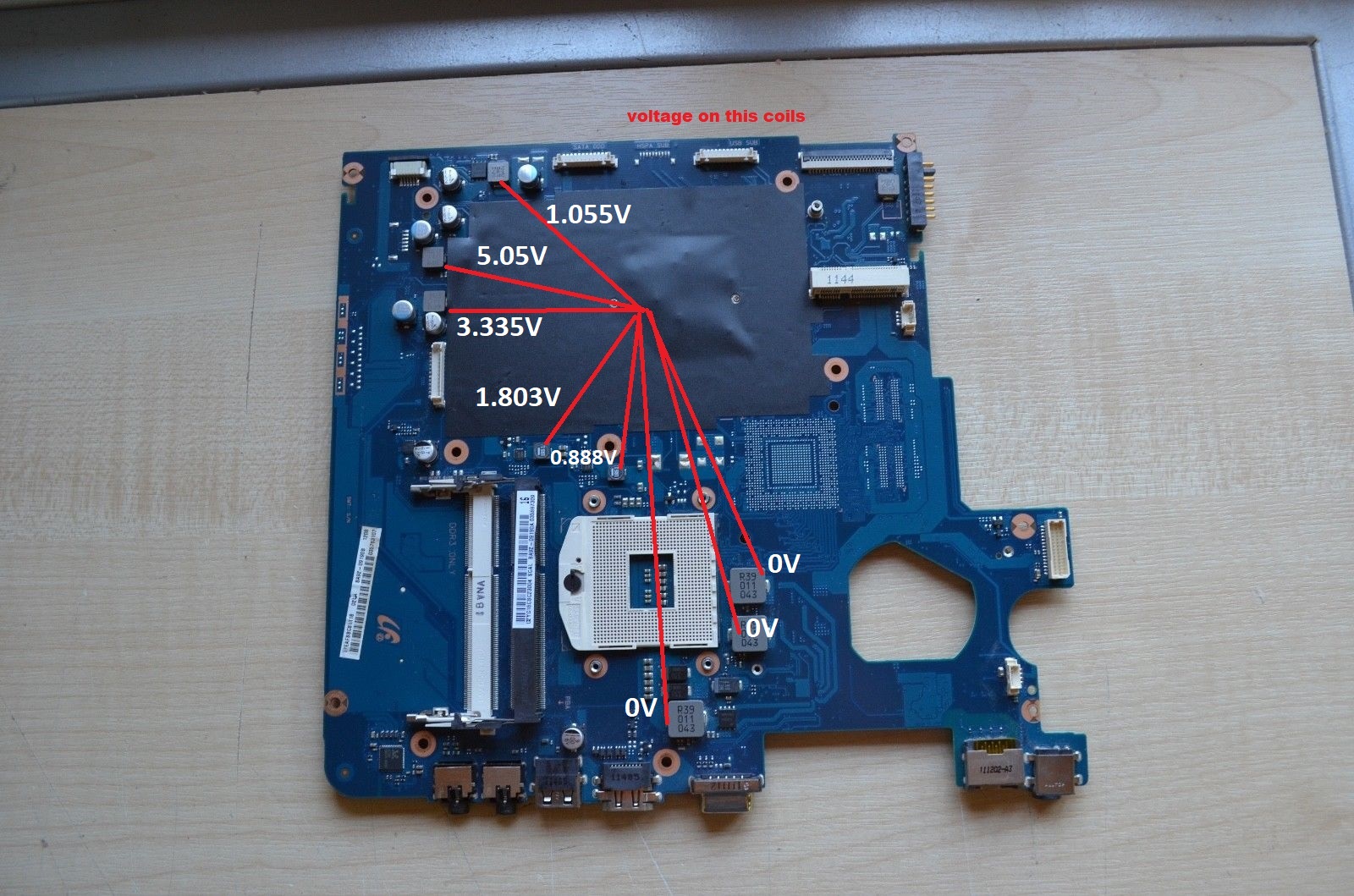

            These are the voltages i have readed, i also have reprogrammed the BIOS having the same response. There are 3 voltages of 0 near the processor that I think they would be bigger:
              Yes these three coils are all part of vcc circuit-two of these coils likely to be vcc core and 1 of these might be gfxcore. You need to find out why vcc core is not generated. Check KBC pin for VR_ON signal and vcore ic pin voltages. can be 'coz of missing run voltage also.

                  I have replaced the SPI memory an reprogrammed the BIOS with the .bin of this laptop and i have the same response, at start i have fan 100% working and any response, i don't have response in the screen and with a external monitor the same result.
                  Also I've tested the power comsumption and i have 0.2A at 19.2V, i think that the starting cannot be completed.
                  The processor doesn't get hot and the only response i have is the power off when i press the power off button.

                    Missing CPU VCore is definitely an issue.
                    You didn't report the voltage for the RAM supply on the backside of the board.

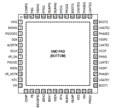

                      I've been investigating the lost voltage and i've found that there are 4 mosfet which have it's VGS=0V. I've also checked the RAM voltage obtaining 0.25V.
                      I've checked the mosfet controller and I've found that I've correct supply values on the controller (VR_ON, activation pin is 3.03V, VDD supply pin is at 5V, VCCP also is at 5V)
                      There are two pins on the controller called PGOODG and PGOOD which would be high for a good operation but the controller puts them at 0V, bescause i've cutted the track on the board, having 3V by the external side and 0V by the side of the controller.
                      I'm thinking of buying a new one.
                        You have to worry about RAM supply voltage before worrying about CPU VCore.
