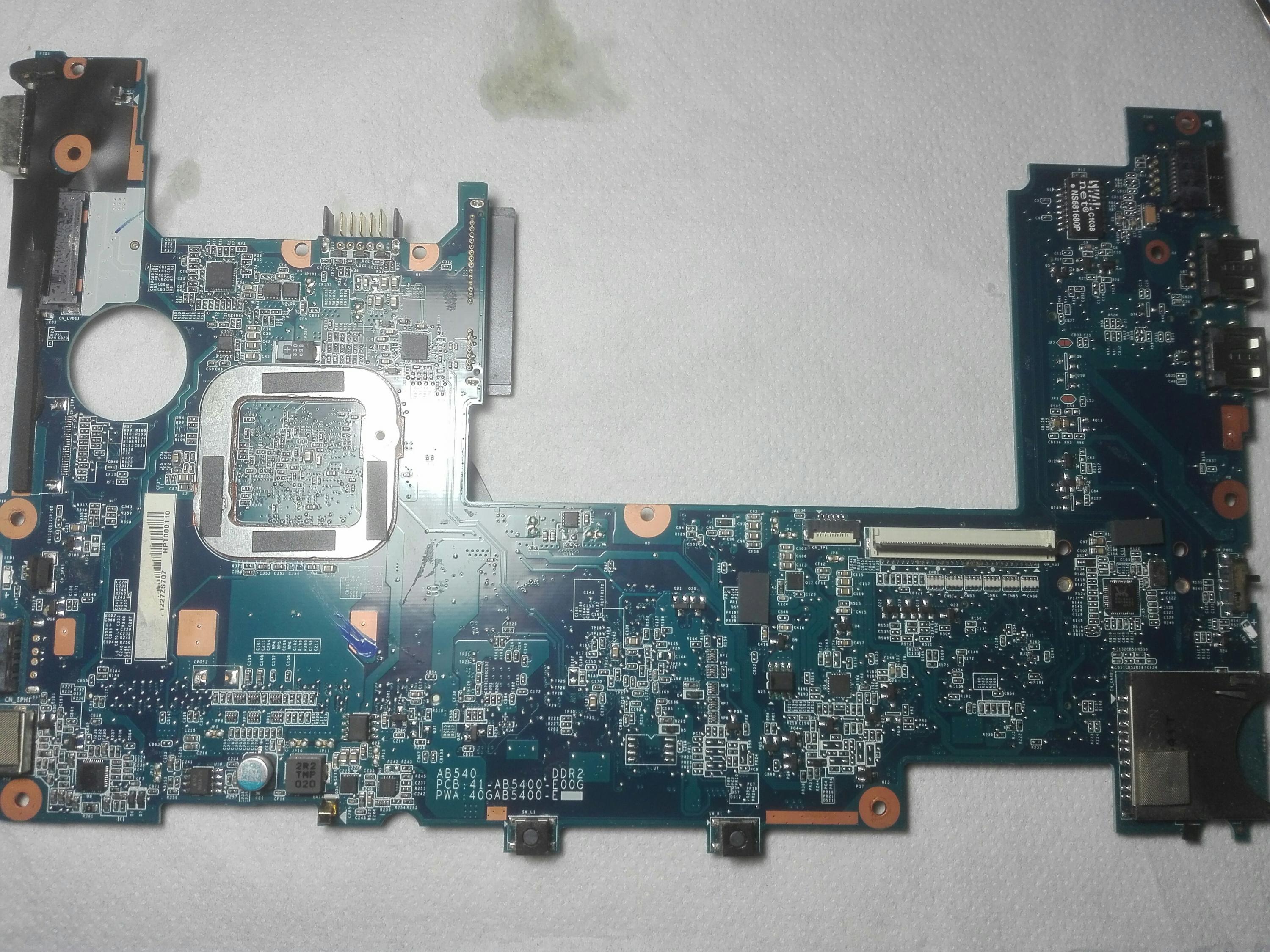

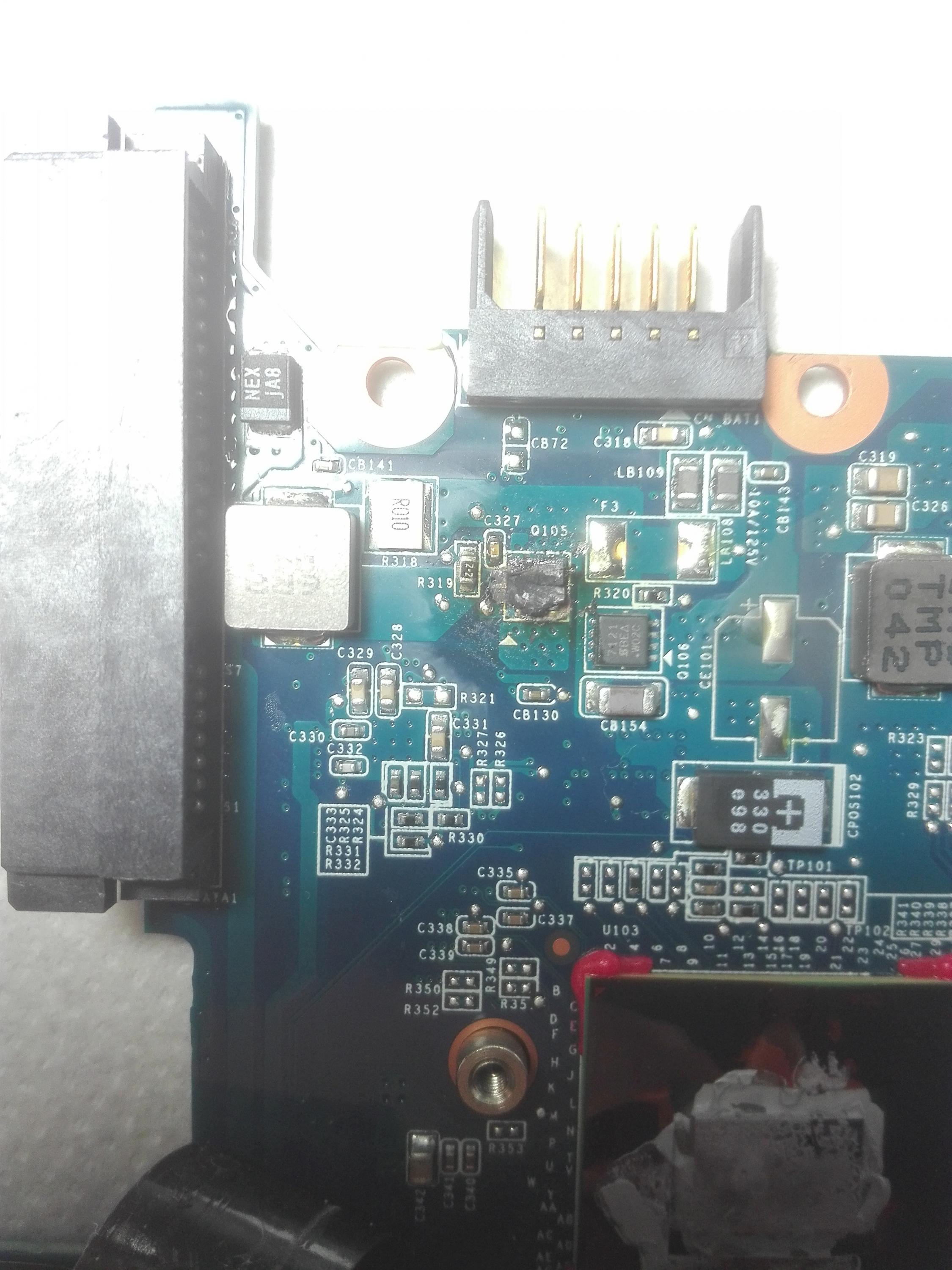

    hi, I have this motherboard with mosfet q 105 damaged, I can not find the correct diagram to identify, attached photos

    Re: Hp mini burned component
    as first try to remove it. looks like it will be welded to pads
      pads are good serves an electrical scheme for ab540 motherboard
      pcb 41-ab5400-e00g
      dead component q105

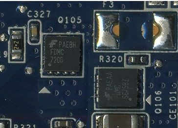

        Q105 = FDMC7200 (Fairchild)
          thank you so much
