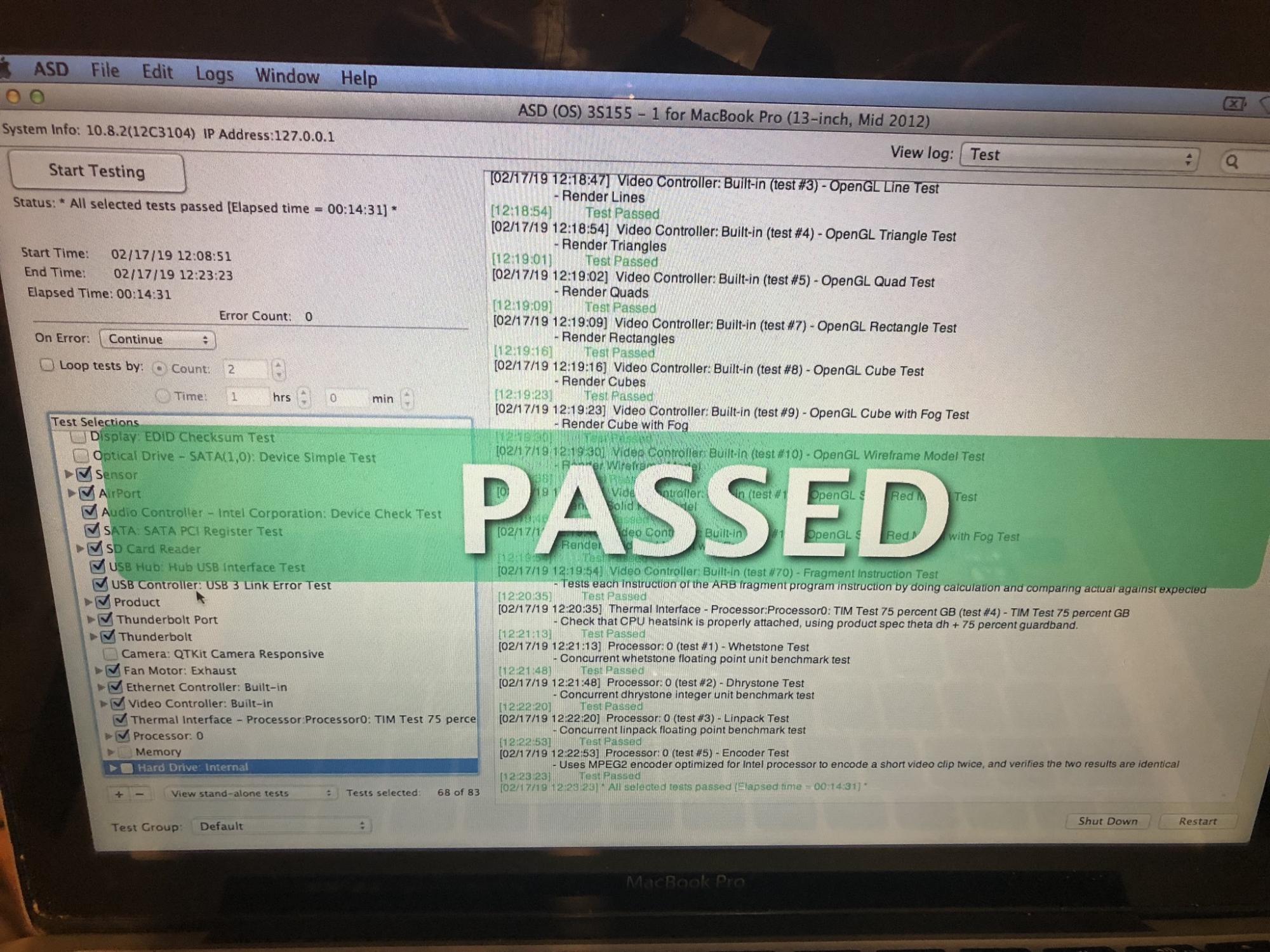

    Update, i've put the board inside an a1278 chassis and i had no backlight, i could see the screen is activated.
    I traced the problem and found f9700 blown. I replaced with a 0ohm resistor marked as fuse on other laptop board just to see if it works.
    Now i have backlight, board boots to os.
    I was able to run os test which it passes.
    It remains to put back a proper fuse, or this one is ok?! And also to put back a new u7770.
    Battery is charging, everything seems to be ok.
    No more green light flash or fan stop without ram stick, extremly wierd!!
    Boards shows apple logo after 20-25sec, is this normal? (Classic hdd with disk plates and 4gb)
    And another 20-30sec to shutdown...
    Another thing i really don't understand is why i get only 2.5v on l3895 pin 2 ppvin_sw_t29bst??
    I never seen 12.5v on that rail, and i have a few i5, i7 boards in working contition...
    Thanks!

      Re: Apple macbook 820-3115 stops working without ram
      Better put back a proper fuse for a good repair.
      Apple logo after 20 seconds is a bit slow, try PRAM reset and maybe try another drive…
      Thunderbolt power rail will only show up when a thunderbolt device is plugged in and request power.
