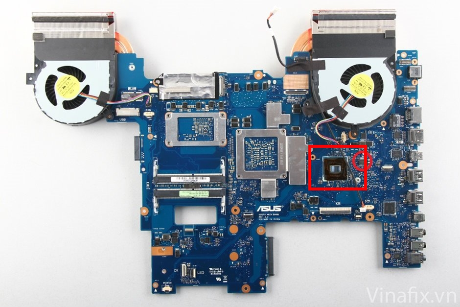

    ROG G752VY identify PCH
    Hi, No boardview available, only a G752VL repair guide and pch = SKL PCH-K. I have a G752VY motherboard with pch missing, it's a i7 6700 so I think the pch probably is an H170, someone can confirm me this. (I don't know if I can post the repair pdf because on every page there is a name of the site that share it). Thanks

    Not 100% sure .
    https://www.notebookcheck.net/Xotic-....158415.0.html
    Intel CM236 (Skylake PCH-H)

      Re: ROG G752VY identify PCH
      thanks
      cm236 -> gl82cm236 -> SR2CE -> QM170
      Now start the research of honest seller
      If mouser quote 53,37 Euro each min 725
      https://www.mouser.it/ProductDetail/...aiyqcGQR5pIg==
      how it's possible that on ebay or aliexpress new -> 25 euro each ?
        Because they are not new, they are pulled from motherboards and reballed. May or may not work…
          Agreed, thats perhaps true with every pch though
