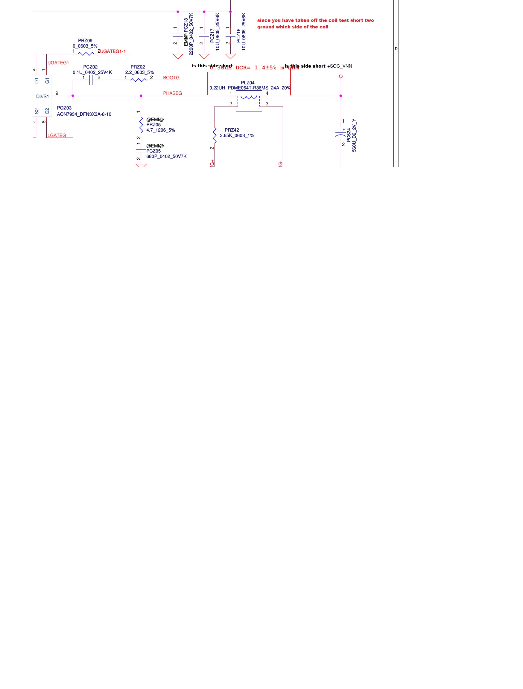

        desolder one pad of each PLZ03 & PLZ04 (pc623 & pc624 output line of the 2 Coils) and test witch side of the line is Short to GND after than you have to trace it back if you have the Schematic upload here to help

              I remove plz03 & plz04 and it power on but with no display

                PLZ03 & PLZ04 Line test witch side is Short to GND Ohm with out CPU CORE no Display that’s normal

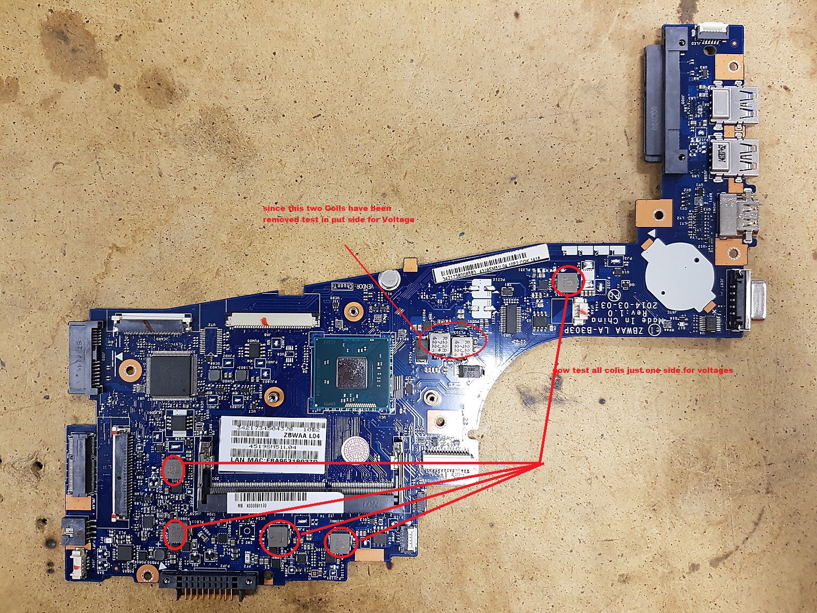

                            Originally posted by george_gpu
                            Plz01 k plz02 with ground 537 show both sides
                            now test PLZ03/PLZ04 both sides for with the help of multimeter
                            for the moment don't' connect the Keyboard we will come back later for that
                            look at the pic and test all that points
