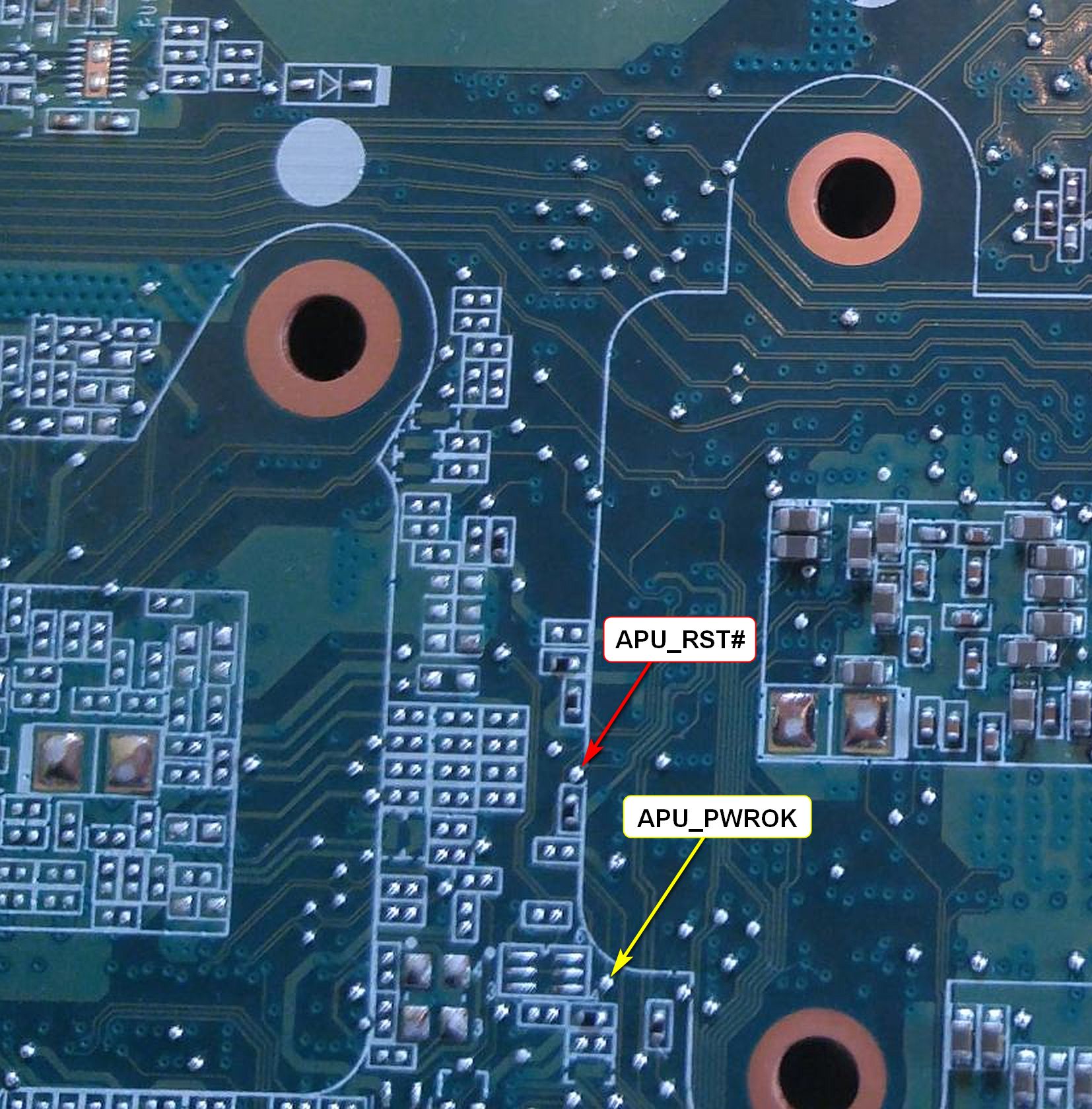

        See attached pics #16 and #17. All 3 arrows are pointing to test pads (not components). These are a few of the later signals in the power sequence.
        Expected values:
        SYS_PWRGD = 3.3 V
        APU_PWROK = 1.8 V
        APU_RST# = 1.8 V

          Will the 2 seconds the fan is spinning be enough to get the voltage measurements. Will get these tonight.
            Re: Hp Probook 455 G3 DAX73AMB6E1 blinking charge light, not turning on
            If it spins and stops, then just turn it on 3 times and measure each signal in turn.

                    I do get these exact values on the test pads.
                    SYS_PWRGD=3.1V APU_PWROK=1.8V APU_RST#=1.8V What would have to happen next?
                      That means it has decided the power rails are good and has told the processor to start, well... processing.
                      The next steps involve it loading the firmware (BIOS/UEFI) and then running it. The actual firmware chip must be getting power and working to some degree, since the embedded controller (EC) firmware is loaded from the same chip at an earlier point in the power up sequence.
                      This may be the end of the road, as the next troubleshooting steps involve buying and learning to use a chip programmer, or paying to ship the board back and forth to someone. And there's guarantee of success.
