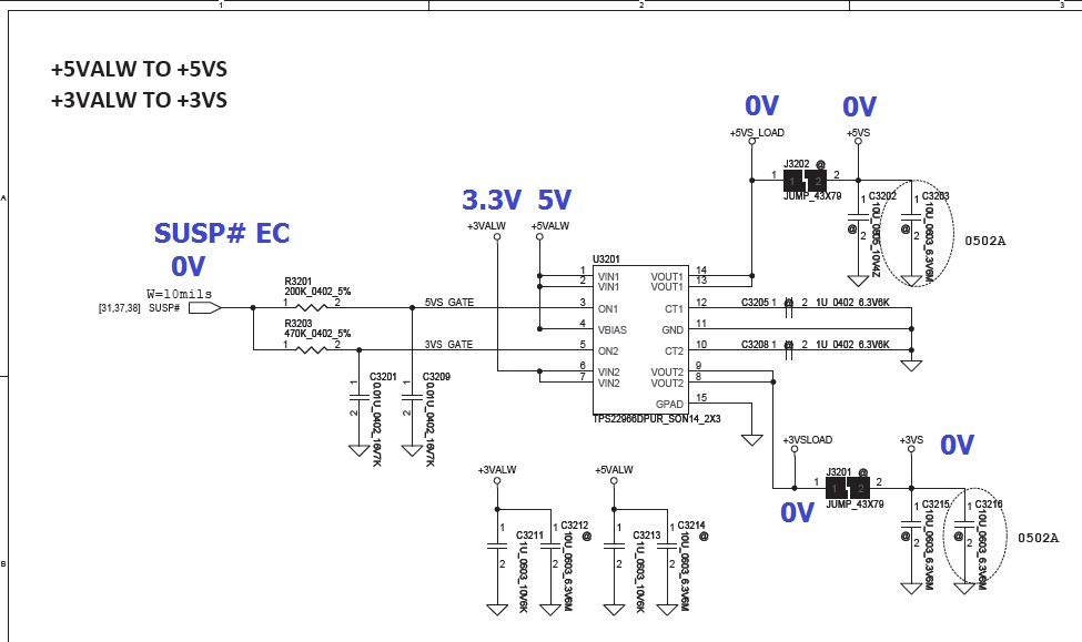

    Hi, I have lenovo yoga 12 motherboard code: ZIPS3 LA-A342P cannot turn on. Pressing the power button I have +3VALW and +5VALW but no display, no fan spinning etc, completely quiet with current comsumption about only 0.6A.
    I have tried reflashed the EC KB9022 but still the same, reflashed the BIOS just the same.

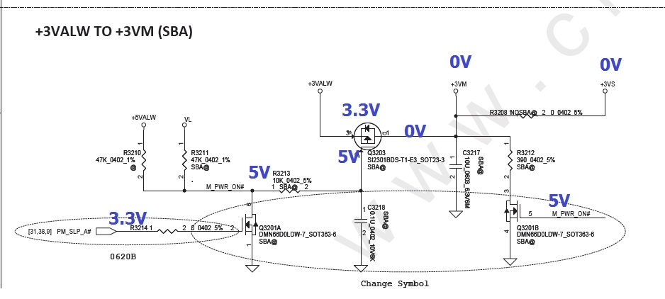

    Tracked the power distribution and found out NO +3VM (BIOS) and NO +3VS, the voltage measured in on pic 1.jpg.
    Further track and found out there is 0V on SUSP# signal on EC,so there is no +3VS and +5VS (pic 2.jpg).
    is this sign of bad ec ?
    or do I have to look at something else I missing ?

    Do you have RSMRST# at kbc??

      EC_RSMRST# is 0V

        U3601 Is ok ?
        Susp# EC should drive on1 and on2 check this line

          U3201 is ok, I injecting 3.3V on the SUSP# line and U3201 is active, +5VSLOAD, +5VS, +3VSLOAD, +3VS is immediately available.
          But still no EC_RSMRST#, no SUSP# signal from EC.

            We should check susp# line , post schematic.
