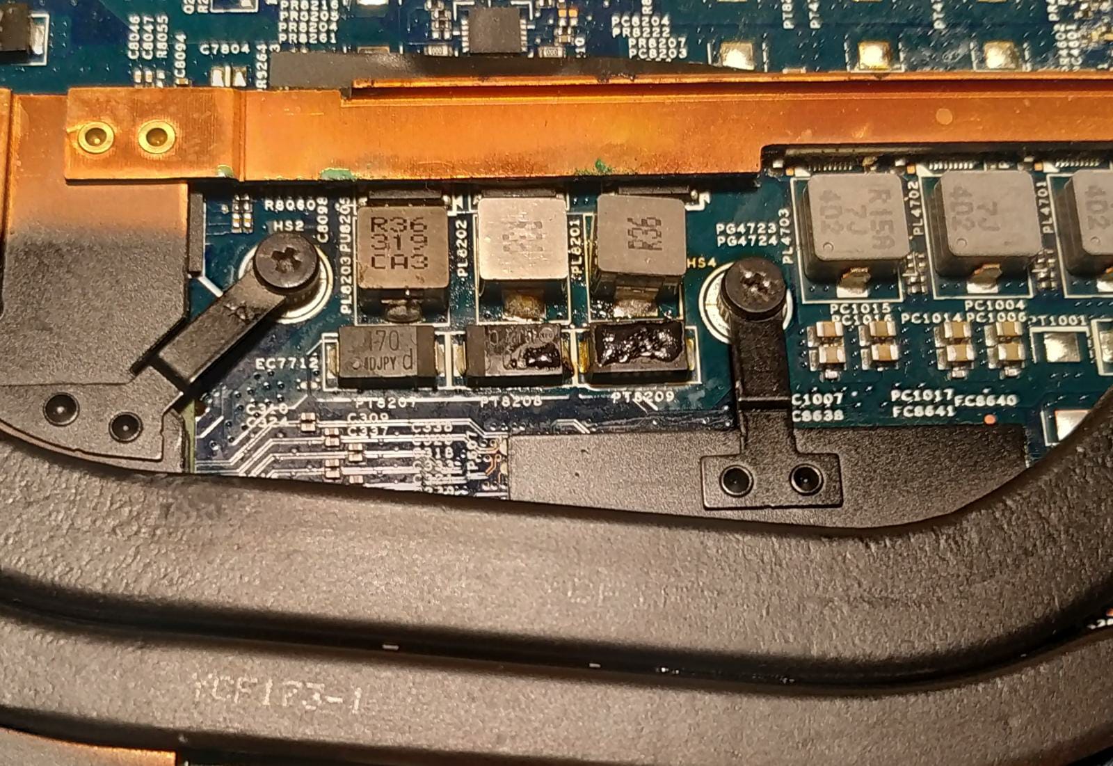

    I have Acer Aspire V17 Nitro VN7-791 model MS2395, Nvidia GTX960m with strange problem. Few days ago laptop suddenly shuts down. After some poking around, I find that GPU 3rd phase dual-transistor died and I replaced it. Laptop works just fine for 2-3 hours, but when I started some 3D app, it starts rapidly heating and that transistor died again.
    Every other passive components are probed with ESR tester and looks good. Any ideas? Anyone has boardview to share?
    TY

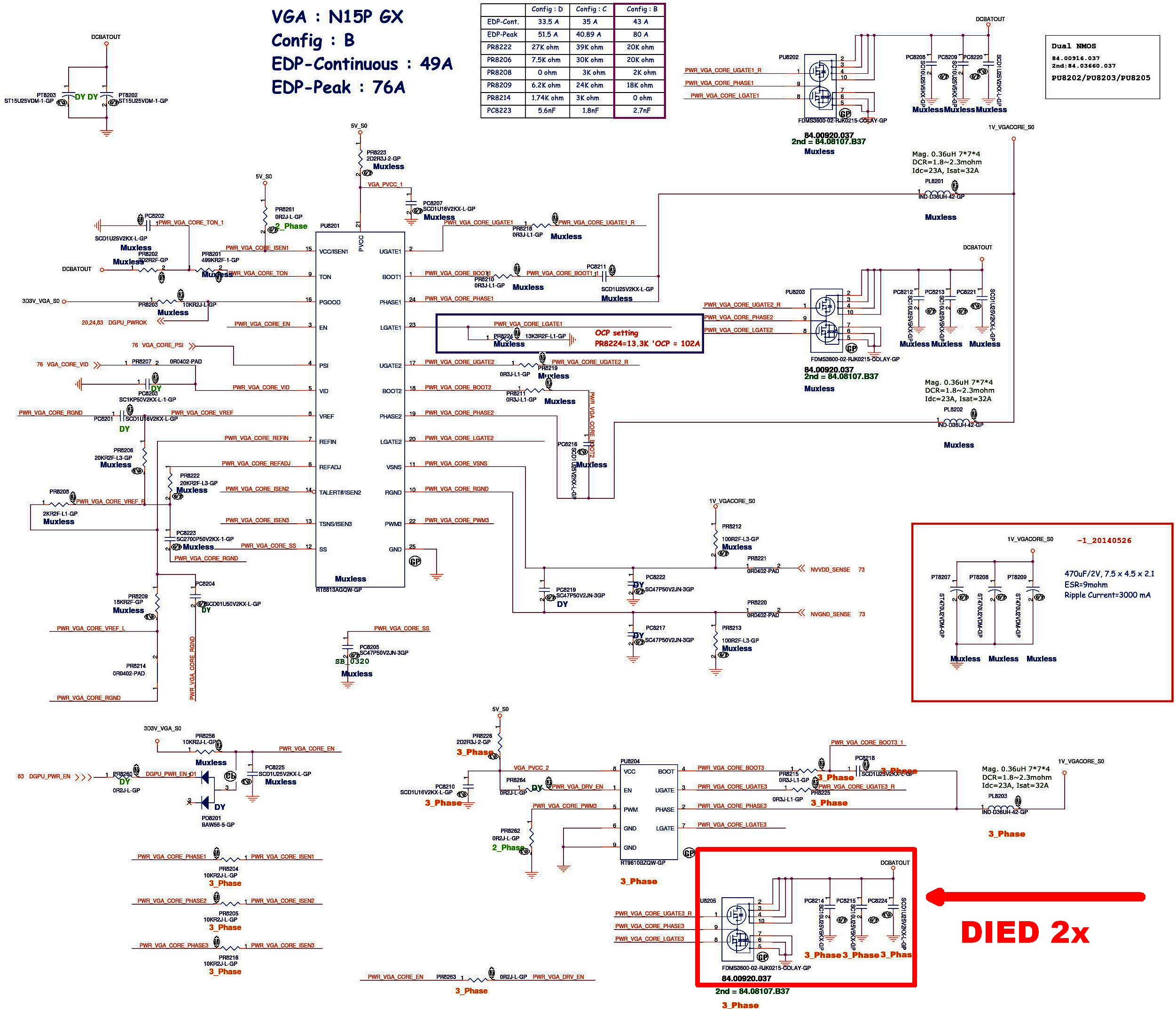

    Re: Acer Aspire V17 Nitro VN7-791 Nvidia GTX960m 3rd phase GPU died, boardview needed
    probably you need to replace both PU8204 and PU8205. have you replaced PU8205 by the same model?
      Match all the MOSFET for the GPU VCore controller with the same batch number, try to buy them new from reputable sellers
        TY so much for schematic and advices. Yes, I replaced only PU8205 with exact same one. It was my intention to replace controller also, but I didn't have it. As soon as they arrive I'll replace and test.

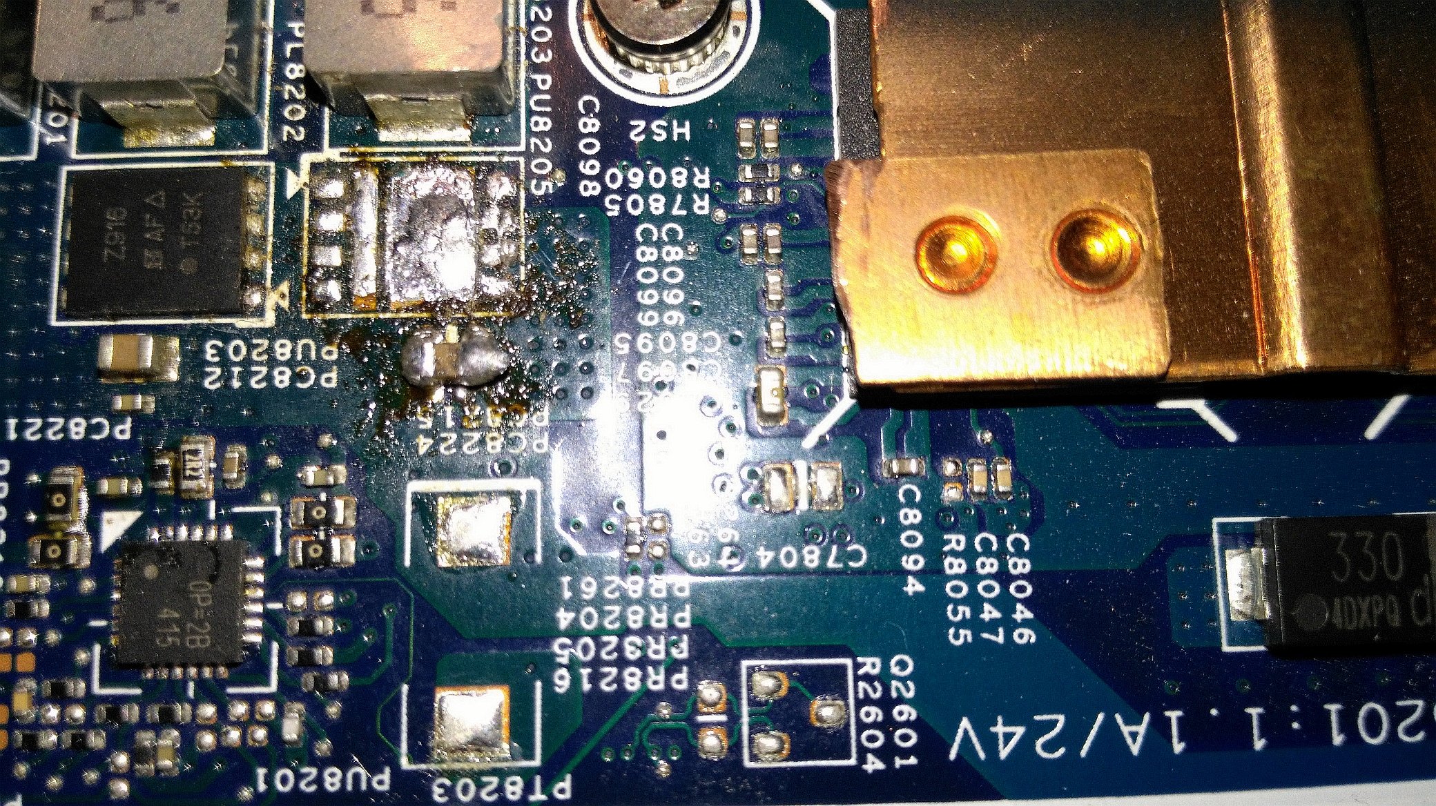

          remove PU8205 and measure resistance to GND on all the pads on which PU8205 was placed. then, report the measurements here. they would help diagnose the problem.

              The capacitor PT6207 is damaged as well .
              • kronikus
                • Feb 2015
                • 74
                • Croatia
                PT8207 looks bad but isn't shorted. It have same resistance as PT8208 and PT8209. Of course that I will replace all of them because that whole area was overheated.

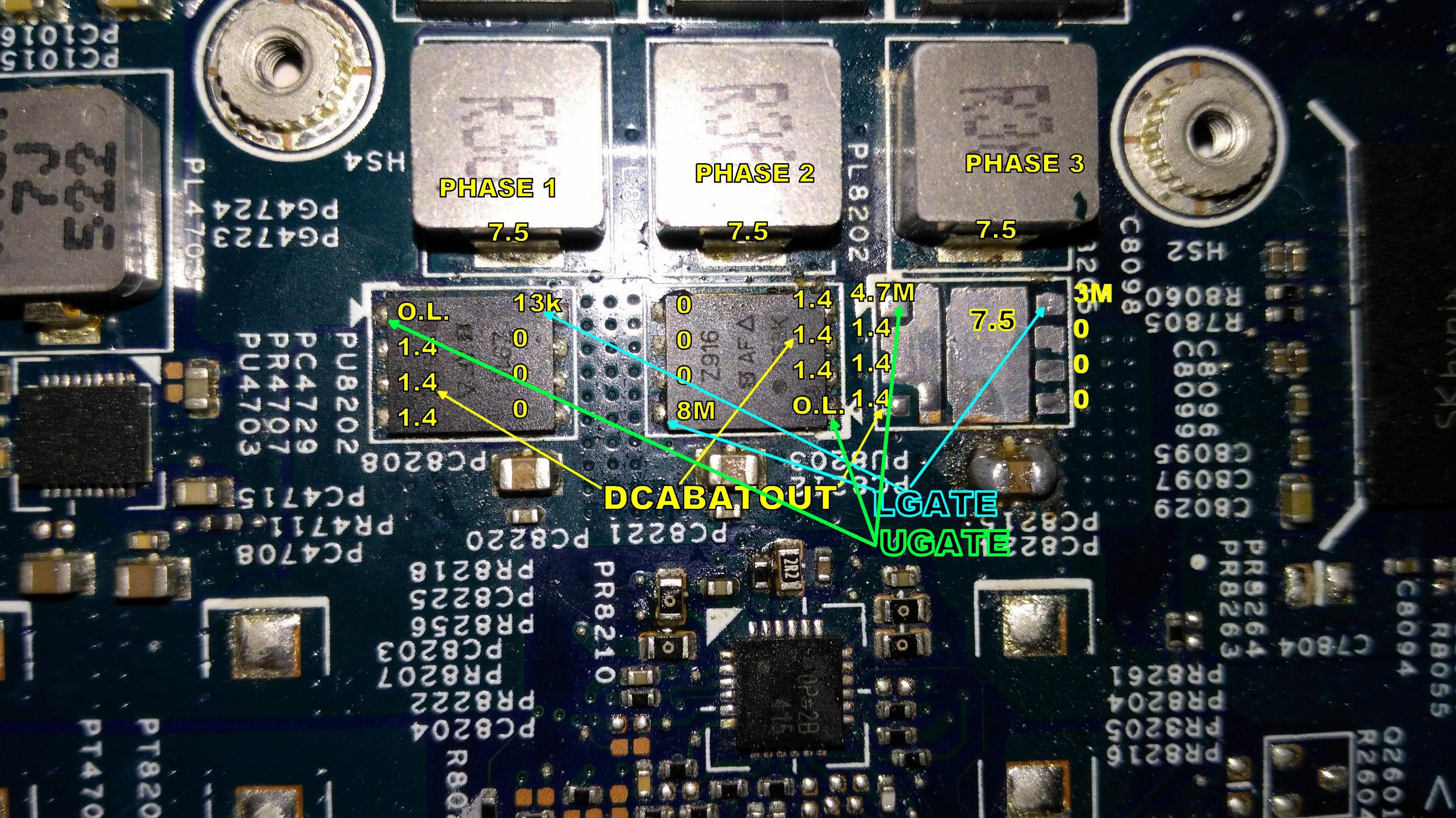

                  I think that removing 2 remaining mosfets may be good idea. That 13k resistance on PU8202 LGATE does not look good, is it?

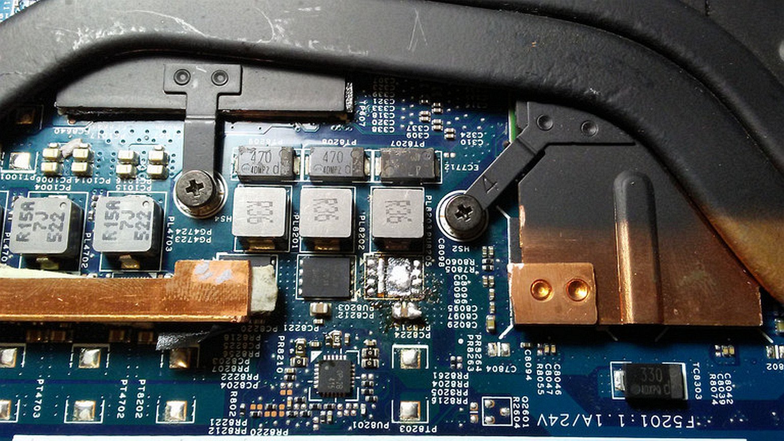

                        It is not clear on the picture does those two components looks burned or look like have some residue on. But it is not transistors but capacitors. And it is best practice to replace all 3 of them with good quality ones. You can find these parts in better electronic shops or online; Mouser, TME.... This tape is not insulation but opposite - thermal conducting pad, which has to be in firm contact with elements and cooler.
                        • sercanuzun
                          • Sep 2019
                          • 3
                          • turky
                          thanks for your concern @kronikus
                          it is not a residue i have checked it several times.
                          thermal conducting pad has been removed by the technician.
                          as far as i can find on the net, they are electrolytic smd capacitors
                          i have found some types from philiphs but the numbers on them do not match.
                          for example this > https://www.newark.com/panasonic-ele...tor/dp/01X1138 is the same type of component but the numbers on it do not match any idea how can i find the exact ones with "A4DJPY"
                          and i cant read the numbers on those two burned.
                          is there a way to know it? maybe chipset has a blueprint and it is possible to get it ?
                          my chipset is poseidon 448 02G08 001M btw with GPU 960M but the one you have posted have 02G07 which is designed for GPU 860M i don't know if there is any difference.
                                      Another thing to check. If PU8205 constantly blows (even if replaced with a new one) there is a possibility the driver IC (PU8204) is broken.
                                      In our case the pins 2 and 4 were shorted. You can measure that at PC8218, if it shows a short, the chip PU8204 is possibly dead and causes the MOSFET to blow. Unsolder the chip and if the short is gone, we have a winner.
