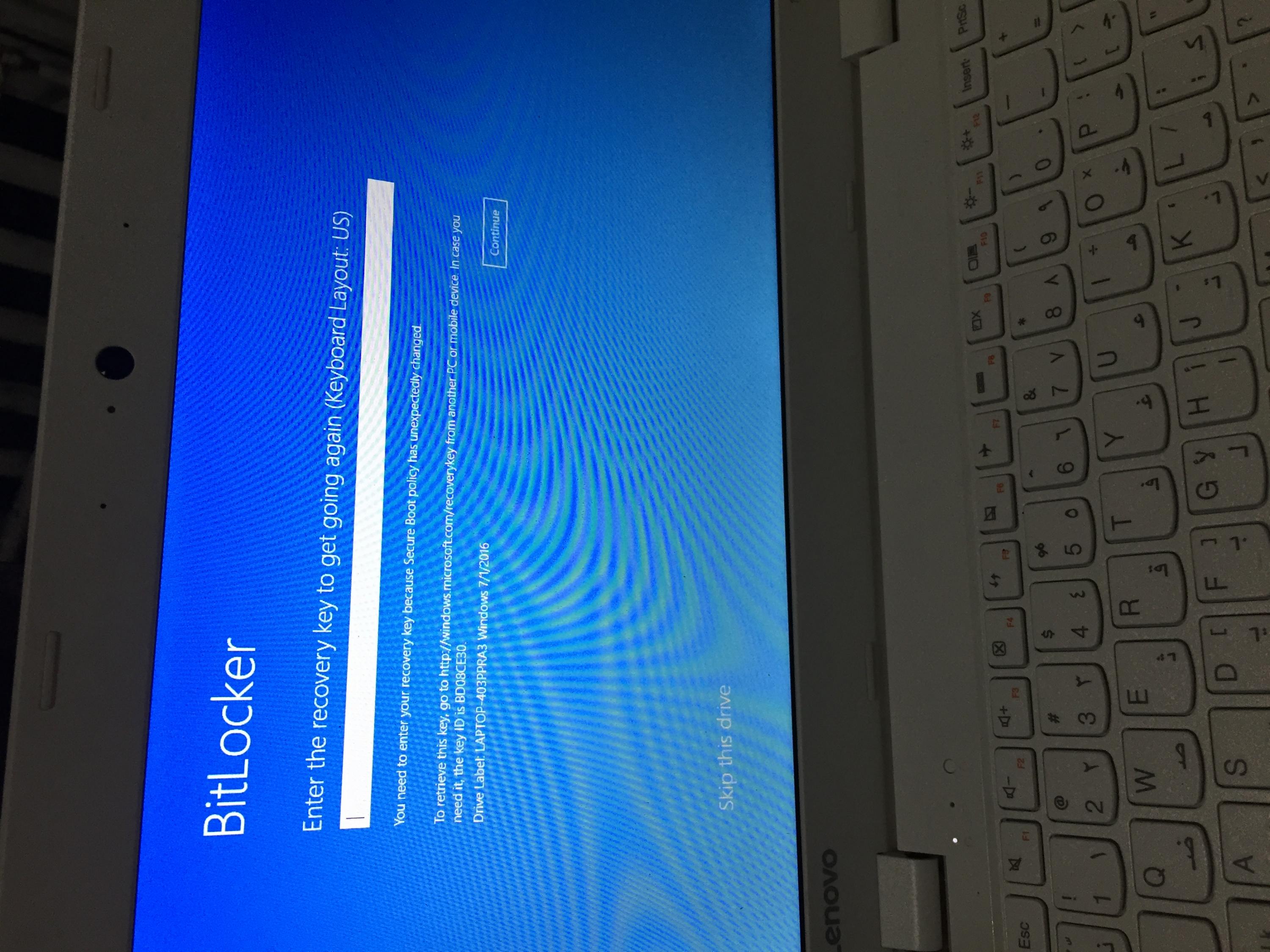

    I need help on thi lenovo ideapad 100s it shows drive is locked of bitlocker and i cannot reset because it shows recovery key, but i dont have one.anyone can help please on this

        Instal windows from USB ?

          i cannot install windows on usb because it says efi usb failed

            https://www.m3datarecovery.com/bitlo...overy-key.html

              boot with live winpex64(HBCD),delete all partions and that is all.Or you can use ubuntu x64.that supports uefi.

                  Search on google hirens boot cd winpe.this can be very usefull.
                  https://www.hirensbootcd.org/download/

                      Probably not worth the effort as these things usually fail... (depends on so many variables) anyways you can always give https://github.com/e-ago/bitcracker a shot...
                      But yeah other than that boot linux and redo everything

                        i downloaded the windows pe and make a bootable flash drive using rufus when i tried to boot up cannot find the flash drive. anyone please help

                            i downloaded linux but i cannot find a live version EFI 32bit

                                  already solved the problem, i just make a flash drive EFI windows 10 32 bit thanks all for the response
