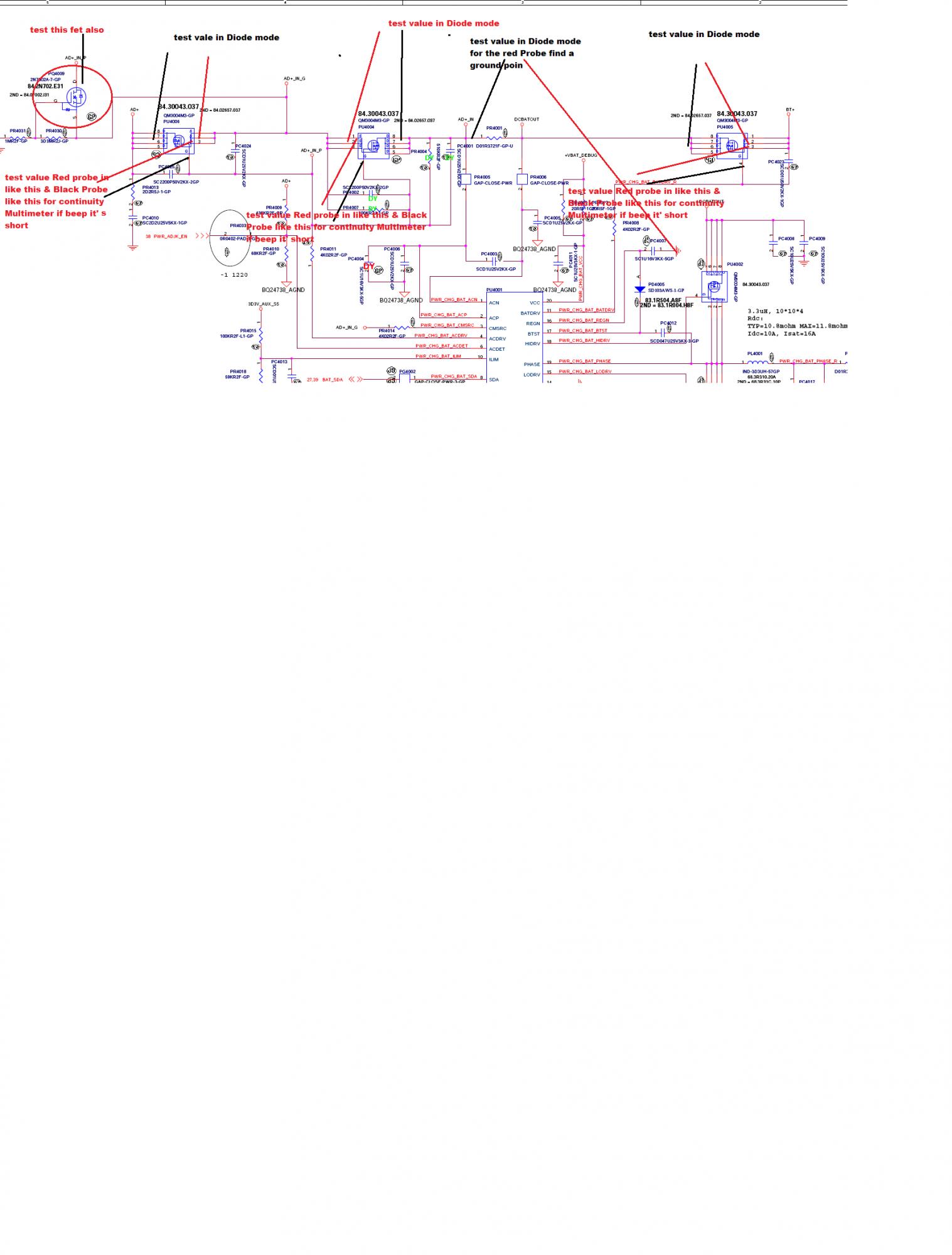

Re: HP dv7-7133nr No Video Problem Goya/Balen
mistake not PU4602
test
PU4006 PU4004 PU4005 PQ4009 PR4001 dont change any thing for the moment
Originally posted by alextech
View Post
test
