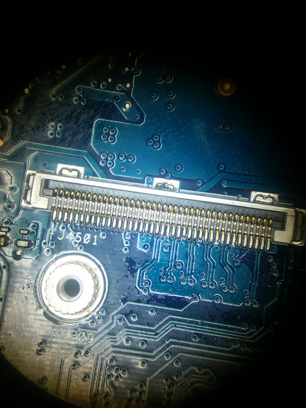

    I did some repear on mechanical part of the laptop. Unfortunately, I did not remove battery before.
    When connected the screen to mainboard, connector slipped and its metallical casing caused a short cut on screen connector pins.
    It seems that screen backlight was not working anymore. But... When plugging the external power supply, the screen was correctly ligthed at full power. When dimming the backlight, it started flickering. After some minutes, the screen was not
    backlighted anymore, with or without external power supply.

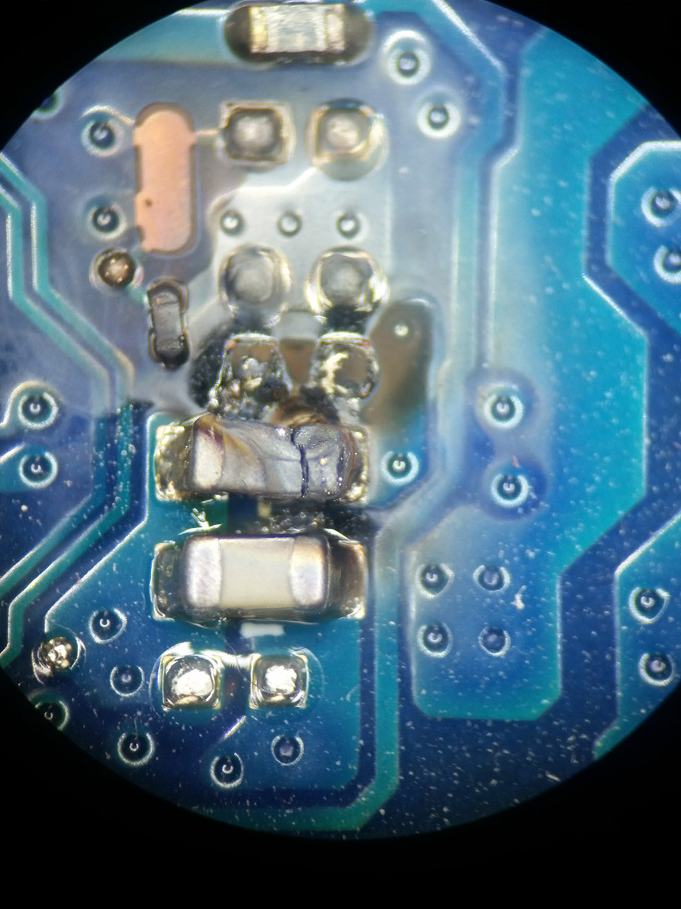

    I found out that, on the bottom of the motherboard, just under the connector.
    One component is blown. It looks like a 0603 capacitor.
    I would be pleased to change it instead of buying $300 refurbish chinese motherboard.
    Here are one picture right after the damage and one after some cleaning.
    Do you have any advice on which value to use ? I thought doing a trial and error, starting at 100nF and increasing 10x each.
    Thanks for your help.

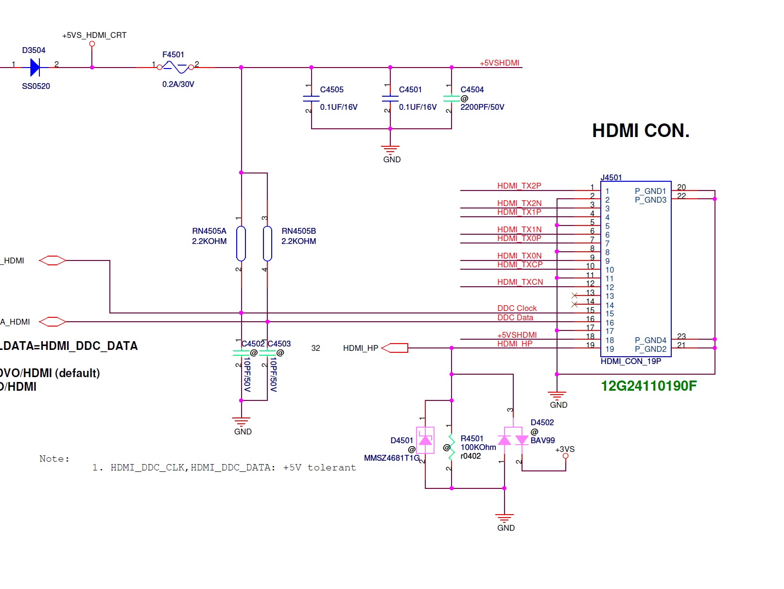

    Very interesting thanks.
    But I'm a bit confused.
    Screen connector is referenced as J4501 on my board and is a 40 pins
    connector.
    On the schematic J4501 is 23 pins and the pins that are grounded on the schematic are not grounded on my board....

      Re: Blown capacitor on asus zenbook UX303L motherboard
      Check on the boardview.

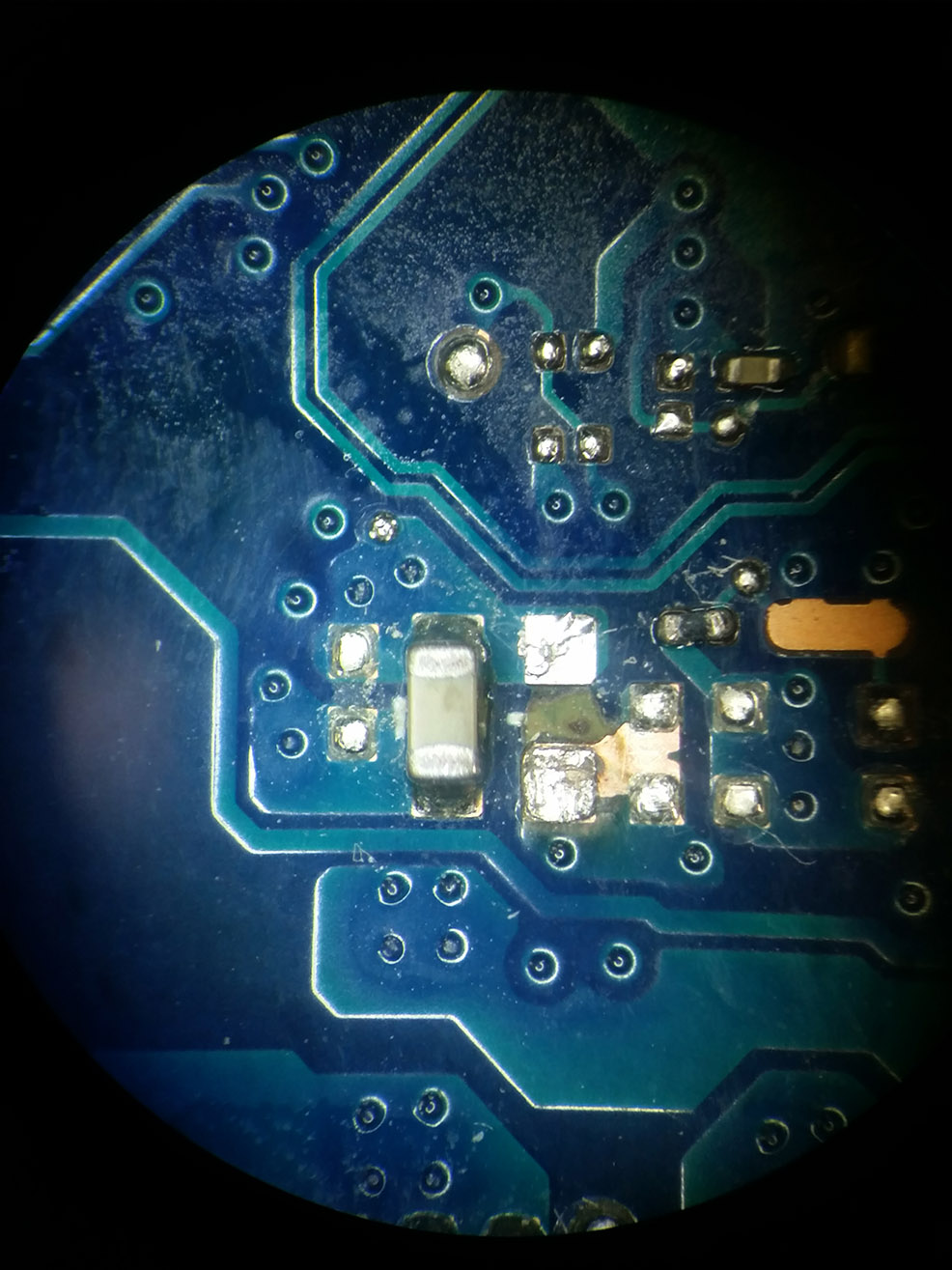

          • julienD
            • Aug 2018
            • 5
            • France
            It works!
            Never thought I'd be able to find this piece of information anywhere!
            total cost: 0.052 euro !
            Thanks a lot.
            Julien
