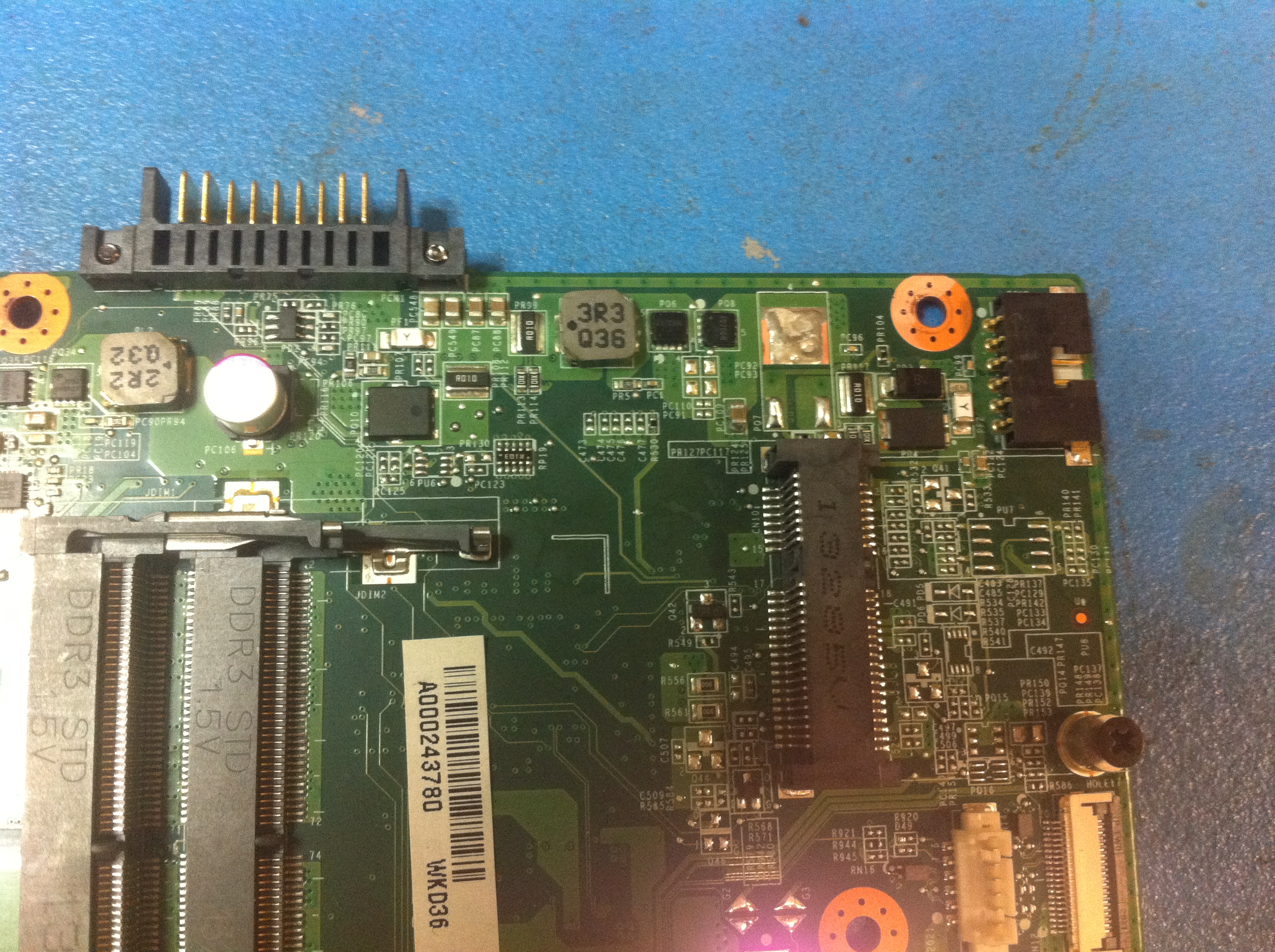

    Toshiba laptop L70-A-118(DA0BD6MB8D0 Rev D) when i connect the charger the led of the charger turn off, i find that PQ7 (AP4439GH-HF) is hot. I remove it and mesured with multimiter and i think is ok. Any help?

    PQ7 should not get hot. Check without battery. Measure resistance between drain-gate of PQ7, Measure resistance between drain-source of PQ7.
    Measure resistance to ground on PR117.

      drain-gate of PQ7 -> maximum resistance , drain-source of PQ7 ->0.490
      resistance to ground on PR117 ->0.498 on both sides of PR117

        i found that +vcc_core line is shorted.

            if the led of the charger is off when you plugin, its must can be ascertained if there is a short in line 19v
            and, not necessarily if the pq7 is hot, the component is a short.
            You can inject voltage in line 19v with a value of 8v to be safe. You can inject + values on black capacitors on the motherboard. after that, try touching the hand with the hot component. remove component and check with the mutitester.
            do not forget to check again on the track that the component is removed is still a buzzer or not, if it's injecting voltage again.
            until there is no buzzer in the path of the component being remove
