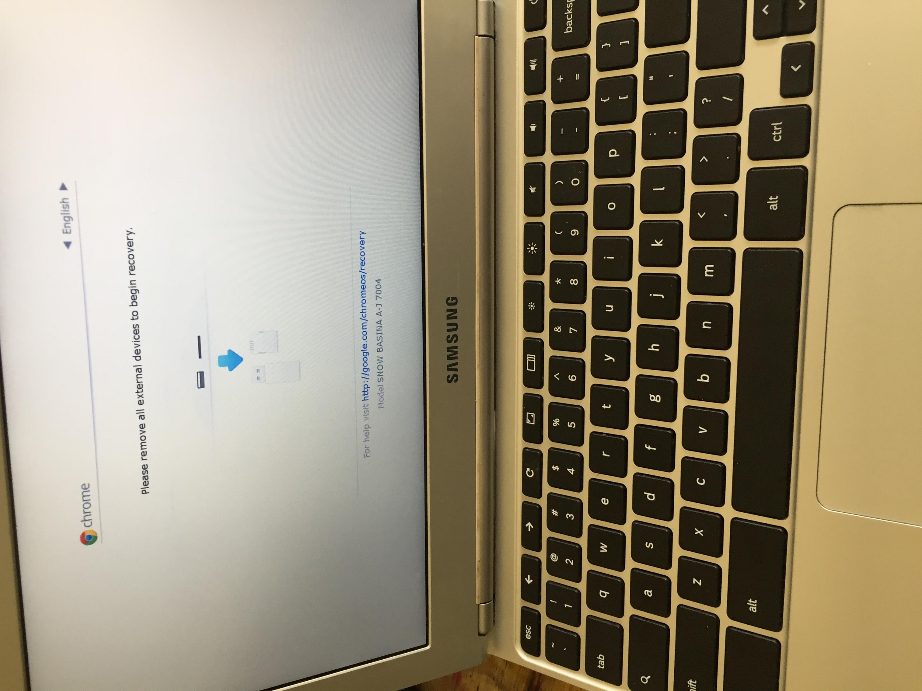

    I need help on this Samsung Chromeook (model XE303C12 with Chrome OS is missing or damaged" error. anyone know how to recover this or fix this please share

      Re: Samsung Chromeook (model XE303C12 corrupted
      i already tried the above method but it stack at this
          When you get to that screen again press the TAB key for more info ,see what the error message is .
            it shows 0x05 TPM error in read-only firmware
              Try this
              https://productforums.google.com/forum/#!topic/chromebook-central/cyJHScds4Rk;context-place=topicsearchin/chromebook-central/authorid$3AAPn2wQcbq1_aFL1esMbZ1Z7ongNDBOiiUPVK1dHQhXFVYSj4Ws4d8cGKUybR6xRp7kbN4KIJtD6I%7Csortate%7Cspell:false
              QUOTE:
              "You're facing a TPM error. This is a hardware issue that may not be recoverable. To troubleshoot this, power your Chromebook on, then hold the power button until it shuts off. Wait 30 seconds, power it on. Then repeat this about 30 times. This will either reset the TPM, or if it does not work, confirm the TPM has had a hardware failure."
                i cannot open the link above ill tried on and off for 30times and tried again still the same error
                    The TPM chip is an Infineon SLB9635, on the picture its the one with the red square around it:
                    https://d3nevzfk7ii3be.cloudfront.ne...oIrbej6yE.huge
                    You can`t replace the chip with a blank one,it might work with one from a XE303C12 donor board.
                      so there is no chance to reset this tpm error?or replace the chip and program it?
