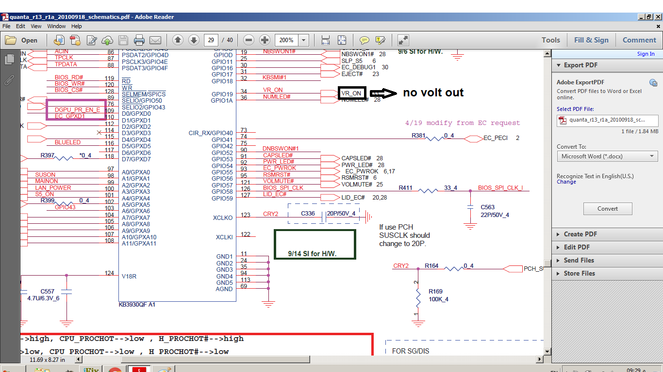

    ihave hp g6-1036ex power on for one second and power off
    all voltage on board ok except processor and vga voltage
    vr_on enable segnal missing on i/o
    ichanged i/o and flashed bios but still not working
    pls help me guys

    try replacing vcore ic and see if vr_on appears on kbc.

      i changed vcore ic and still same problem

        have you reprogrammed the i/o chip?

          this i/o is ene 930qf a1 not programable ihave two bios ic on board and already reprogramed it
