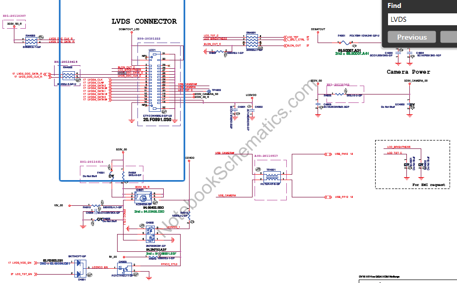

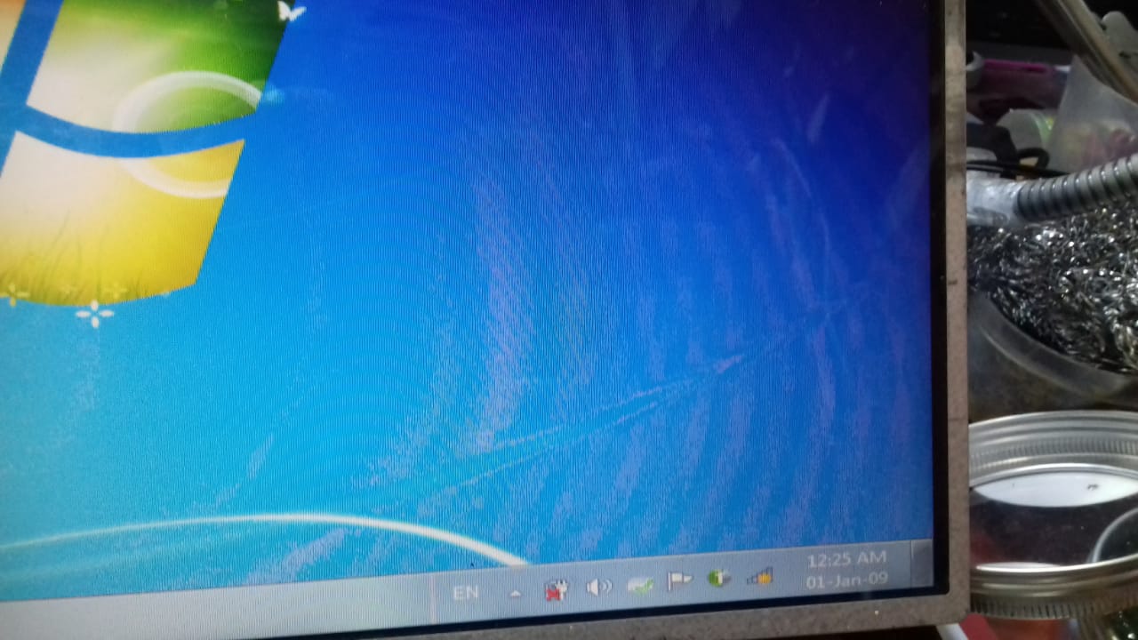

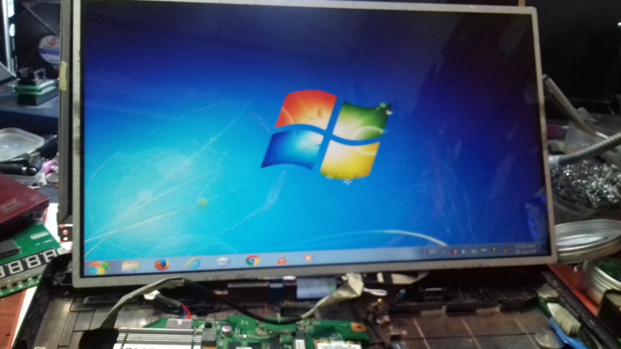

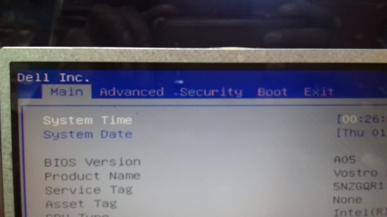

    I have this wierd problem ONE BOARD DISPLAY RED LINE
    IN BIOS AND OS
    (I REPLACE CABLE AND DISPLAY ITS SEAM RESULT
    PIN
    1 18.V
    2 18.V
    3 3.3
    4 2.505
    5 3.3
    6 3.3
    7 1.227
    8 1.189
    9 1.189
    10.1.229
    11 .1.069
    12 .1.339
    13 .065.5
    14 075.4
    15.0V
    16 3.3
    17 3.3
    18 3.3
    19 3.3
    20 .0
    21 0
    22 0
    23 0
    24 0
    25 0
    26 0
    27 0
    28 0
    29 042
    30 18 V
    what missing ING lvds any idea ??

    the measured pins seem fine. no clue can be found from them. how is picture on external monitor?
    • crowntoy99
      • Oct 2012
      • 264
      • india
      Re: Dell 5050 lvds red
      thank you bro
      its external monitor good working

        many such times, the problem is a loose lvds cable which is not properly inserted.

          Remove LCD cable and measure all data lines resistance to gnd. They should be approximately the same. Pin 13 and 14 show less voltage than other data lines?

            Pin4 should be 3.3v though that cant be the reason for reddish tone in display. You must be having a little bit less brightness. I faced this issue in dell n5010 and ultimately changing the pch resolved the issue. The problem was 100% identical.

              Try an mild reflow PCH und than messure Pin13+14 again
                thank you all ... happy movement
                its don i changing the pch
