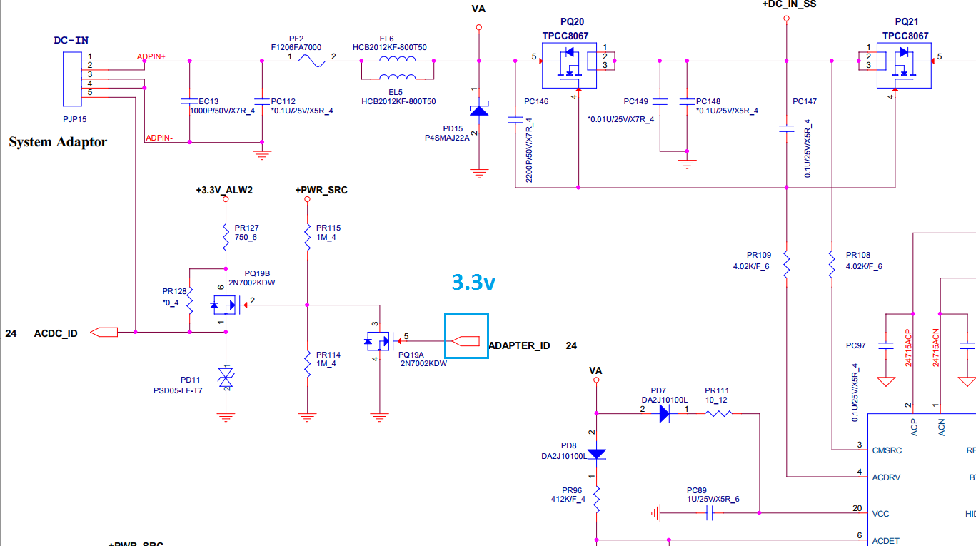

    i removed PU6 and so now i dont have 3.3v_ALW2
    but i can remember also with PU6 , dont hat 3.3v_ALW2

        What voltage do you get at the DC-IN connector, pin 5
        • kokono
          • Jun 2018
          • 203
          Re: LENOVO U330 DA0LZ5MB8B0 Quanta LZ5 REV
          0v

              i think this 0v ist normal for ID pin because i dont have 3v
              Originally posted by BlueMidnight
              There will be no voltage on the ID pin if the 3V switching regulator on the board isn't powered up. And yours won't be since your main power rail isn't working.
              • BlueMidnight
                • Jan 2015
                • 489
                There are some irregularities with your PU7 measurements that should be checked.
                - Pin 4 is designed to be raised ~6V higher than pin 3 to turn on the input FETs, but it's only barely higher. Which means it's not in the off state. But it's not fully in the on state either.
                - Pins 1 and 2 should not be higher than pin 3. The exit side of PQ21 shouldn't have a higher voltage than the entrance. Is voltage leaking through from the gate pin?
                If these are steady voltages (not jumping around such that the measurements on different pins aren't entirely correlated with each other since they were measured at different moments), then something isn't right in this area. Check for a gate-drain short in PQ21 for starters.
                If something like that were the case, then there would be voltage on "VA2", but there would be no actual ability to provide the sort of current the buck regulator needs to operate once it's connected to anything on its output.

                  YEEEES
                  PQ20 ist short

                    Yes, i was looking at the PQ19 area to see if that was pulling the voltage down. I`m glad you`ve got it sorted out .Whats the voltage out of PU6 now is it more than 7V

                      i replaced mosfet PQ20 and now i have 3.3v and 5v and when press start button , i can see that led blinking for 1 sec and shutdown
                      i think have short circuit.
                      any idea ?

                          Well that's progress at least. It couldn't hurt to measure PU7 pins 2,3,4 again.. just as a sanity check to make sure everything looks 100% okay there.
                          But also, make sure you check the power rails both before and after the load switches. For example, +3.3V_DSW becomes +3.3V_RUN, but only when PQ7 turns on. Likewise, +5V_ALW goes through PQ15 to become +5V_RUN. Etc, etc. There can be a short on one of those switched rails, and the board doesn't freak out until it actually tries to turn on the load switches.
                          This is also about the time the system firmware would come into play. There are a bunch of other possibilities really.

                            Pin4 = 26V
                            Pin2 ,3 = 20v
                            for test, i removed PQ7 and PQ15
                            ist same, LED blinking and after 1s shutdown

                                Testing for a short to ground on both sides of PQ7 and PQ15 is enough. Obviously, it won't want to turn on without them.
                                When the board wants to read the AC adapter type, it has to turn on PQ19B. To do that, it needs to turn off PQ19A. To do that, ADAPTER_ID has to be 0V. But it only needs to do that when it wants to determine the type.
                                The 2 component failures do seem related at least. When the capacitor shorted, it could have cause a current/voltage pulse that damaged the FET. The other capacitors in that area would be an obvious short, so they are probably fine. PQ21 seems to be turning on okay so far. PQ13 too.
                                So maybe PR102 could have been damaged by excessive current. If its resistance has increased slightly, the board might think there is too much current flowing and shut down.
                                But there isn't much else in that area to go bad without noticing it easily. So the problem might be elsewhere.
                                What happens if the board is turned on with battery power only? (assuming you have the battery and it has enough charge) And if the AC adapter and battery are plugged in together, does it charge the battery?
