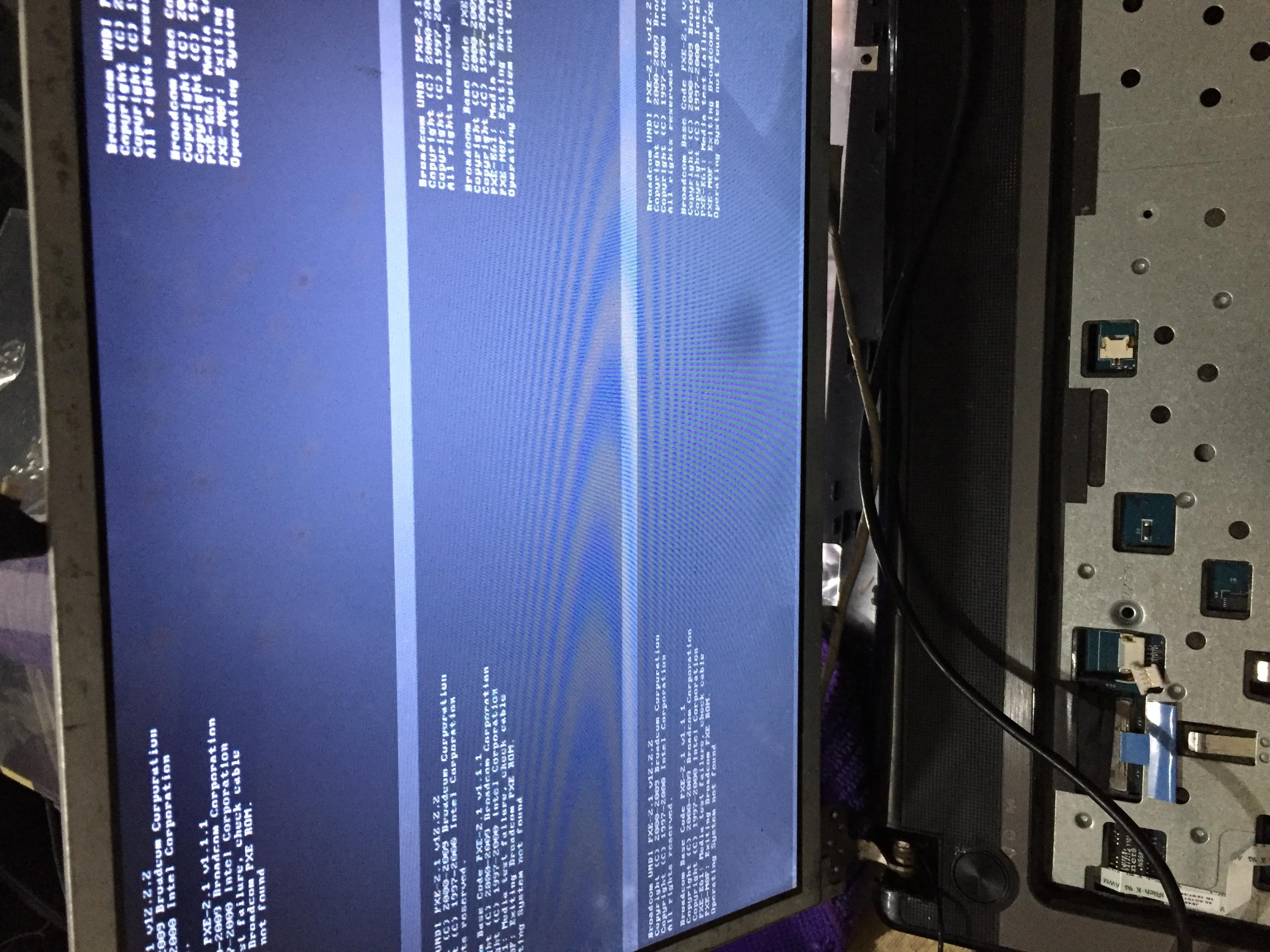

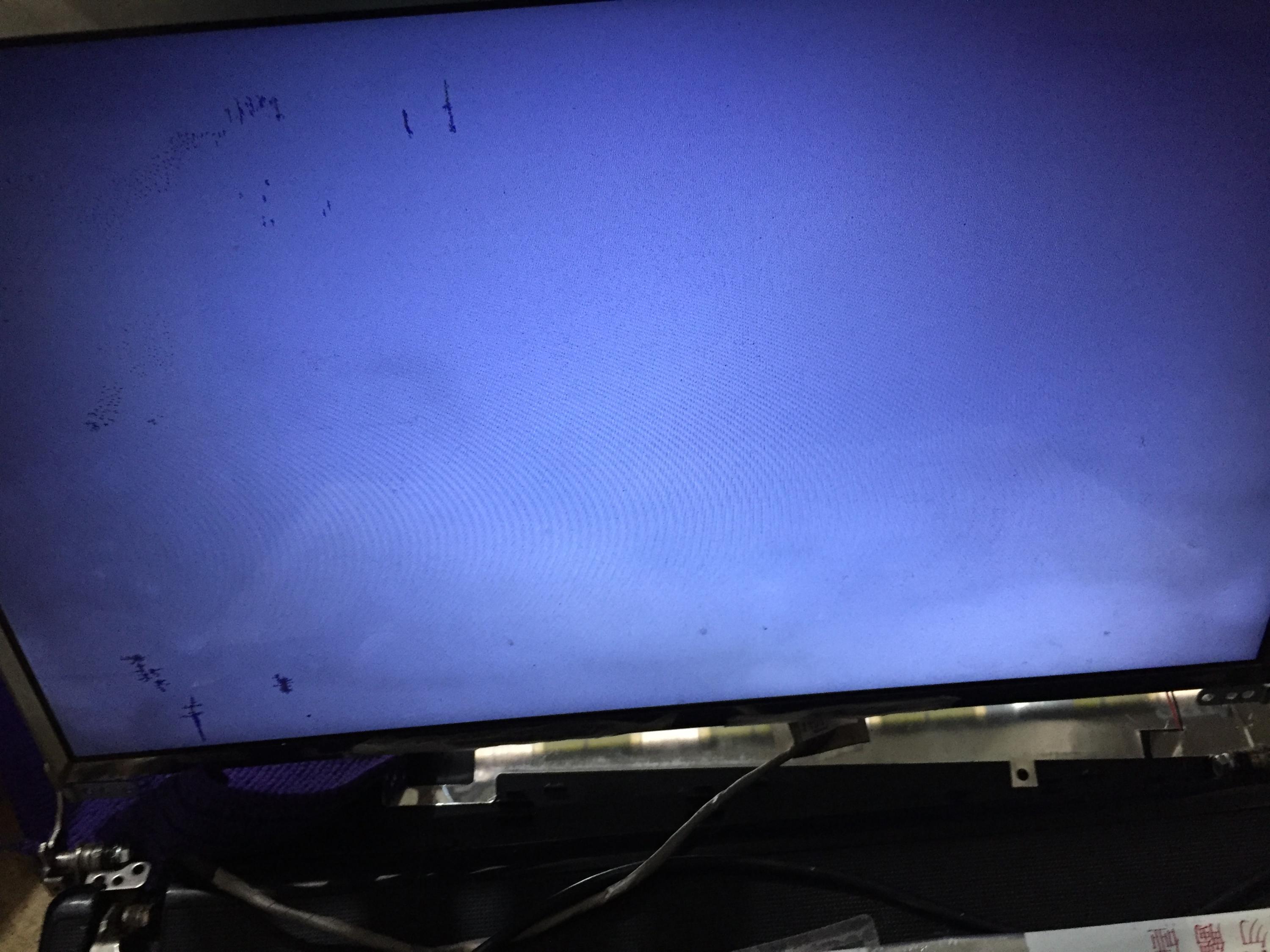

    Hi friends, I need help on this.I have an acer aspire 4741g core i3 and nvidia graphics.the problem it boots fine and when i connected to external display comes ok.but when connected to original internal screen it shows 6multiple images,I tried replacing a screen with a good one it shows light but no image, already tried many different working screens still the same.but when i plugged back the original screen the same as before it shows 6multiple image.I have attached the image look of the screen.can someone please help on this and advise please. the first image is the original screen and the second image that is came from a working and good screen

    Dear String2016, you have 900+ posts still you cant make it that this is bad graphics issue?? have you forgot famed hp dv2000/6000 nvidea giving same problem.

      @Mcplslg123 this is not a graphics issue my friend ill tried using external monitor display is good

          I still beleive this is a graphics issue. You reflow the graphics chip and test display on internal screen

              Before i reflowed im asking an advise for this,beacuse i still believe this is not a graphics issue because when i connect to external display display is nomal and good.only if i connect on internal screen the original have 6multiple display,but when i connected a working screen no image,sometimes screen becomes green,red.please anyone help on this

                  Could still be GPU issue, sometimes it's good on external display but you won't have image or backlight on internal.
                  Some laptop won't recognize a non-original display. You'd have to swap the EDID ROM.
                  Also make sure the LVDS cable is good.

                    Good display on external monitor does'nt mean its not a bad gpu. Have seen a lots of Hp dv2000 with good display on external monitor and 4-6 split display on internal screen coz of bad gpu.
                    If you dont want to beleive that, thats your choice but i'll try a mild reflow of gpu first.

                          but how come if i replaced a good working screen it does not show images?anything than reflow should i replaced first the lvds cable?

                            @mcplslg123 i think you are right i tested the original screen to another board it shows good image.does this mild reflow can last longer?

                                  Hardly matters how you reflow as it wont last beyond a couple of days. You need to either change the graphics chip or look for new mb as i've already said.

                                    @mcplslg123 reflowed the graphics still the same issue it gives multiple display and no image on good screen if i replaced
