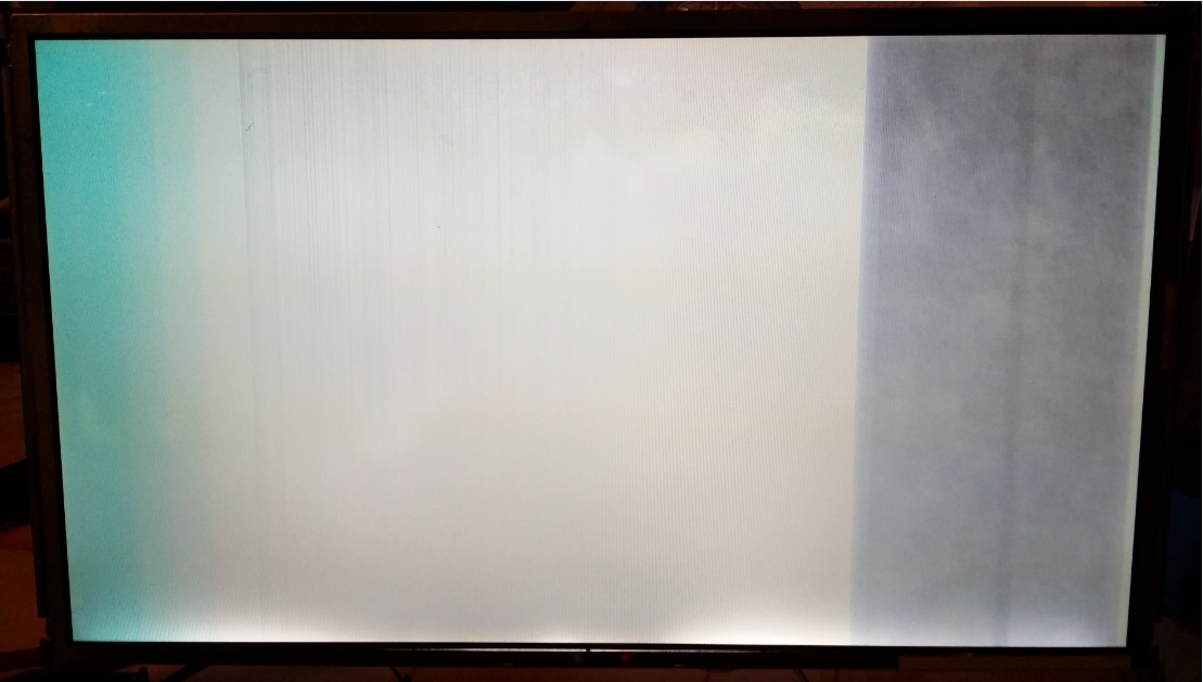

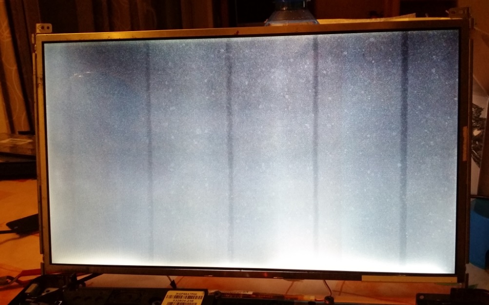

    I have a display issue which looks like shown on the attached pictures:
    Description: after power-up backlight illuminates itself, the display is black as if everything gets fine. However no bios message is displayed. The display remains black for a few seconds, then starts slowly to get brighter so that the initial perfectly black picture slowly fades out to become some gray color (first attached picture). Some pixels appear green like if they were hot pixels. After lets say 2 minutes the display stabilizes itself as on the second picture (the left edge is blue).
    It seems that something is wrong with the LVDS signals. The display works perfectly when attached to another computer.
    I first thought it was an LVDS controller issue. However, once the display initialized correctly and worked fine for let's say 30 minutes. So I powered the PC OFF and ON, to see if this was not some bad contacts issue, but I got this issue again...
    Can it be related to a slowly dying LVDS chip which sometimes works again?
    How can I test the LVDS signals? It requires some fast scope, right?
    Thanks a lot for your help

      It would have made sense but I forgot to point out, I just replaced the lvds cable by a new one as the backlight power supply wire was cut off somewhere in the middle of the cable. When I first turned on the PC after cable replacement, everything worked correctly, then I switched OFF the PC and on tomorrow I got this issue.
      So I tried the display unit on another PC which prooved the LCD was OK, then attached the lcdback to the CQ61. After power up the display worked again but when turning OFF and ON again, the problem was there... And now it is visible everytime.

                    I tried connecting another display with slighltly smaller dimensions and, surprisingly it works. The image is not displayed on the whole area most likely because of the smaller size and maybe different aspect ratio but this prooves the LVDS signals are still there. This therefore invalidates the faulty graphic chip option.
                    So:
                    CQ61 display on another computer: working
                    Other display on CQ61: working
                    Original display on CQ61; not working.
                    I already checked display's power voltage which is 3,34V. I'll check its raising time with the help of an oscilloscope as a slow raising time could mean the display is badly initialized.

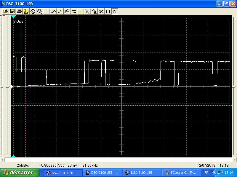

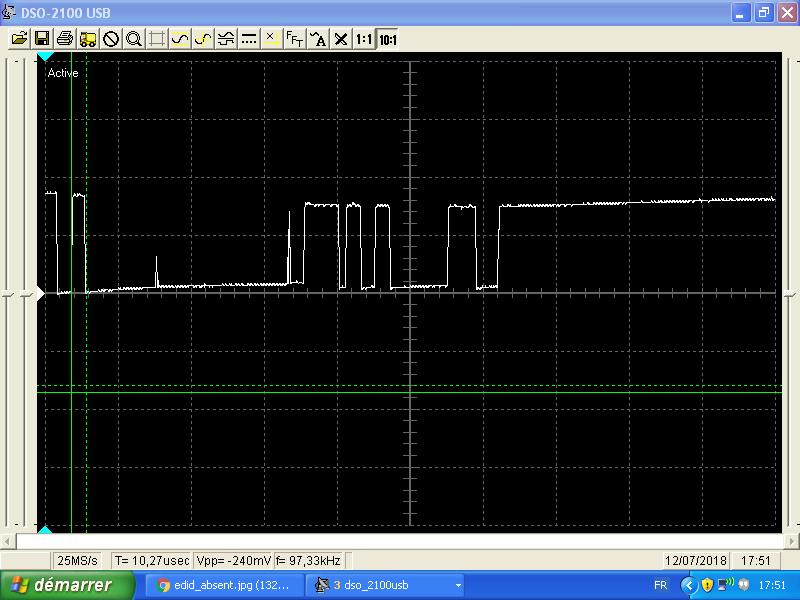

                      I made recordings of the EDIDCLK and EDIDDATA signals at power up with:
                      1/ the original display which does not initialize properly. The communication lasts for about 300 microseconds then stop.
                      2/ another display which initializes properly. The communication lasts for about 11ms.
                      I am a bit confused in understanding the exchanged data. The first byte is the address 50h then the displau outputs the first byte of the EDID header?

                        Re: Compaq pressario CQ61 display issue
                        I finally succeeded in solving this issue which was due to broken soldering joint at the EDID VCC (3V) LVDS connector pin on the motherboard.
                        Some displays seem to not care about if EDID data is returned or not, but the original display simply doesn't initialize when no EDID data is received.
