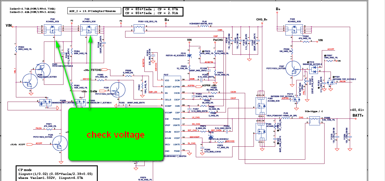

    thanks for the response i tried that by putting the ground black probe and red to each pin of isl chip only pin12 and pin13 is beeping on the schematic it shows gnd and pgnd
    • String2016
      • Nov 2015
      • 2229
      • philippines
      Re: ACER ASPIRE 5733 Voltage flactuating
      i found only PR353 and checked on continuity it shows 0L and in diode mode is shows 0.393v
        Black probe to motherboard gnd.
        Red probe swipe through each pjns
        Change isl chip

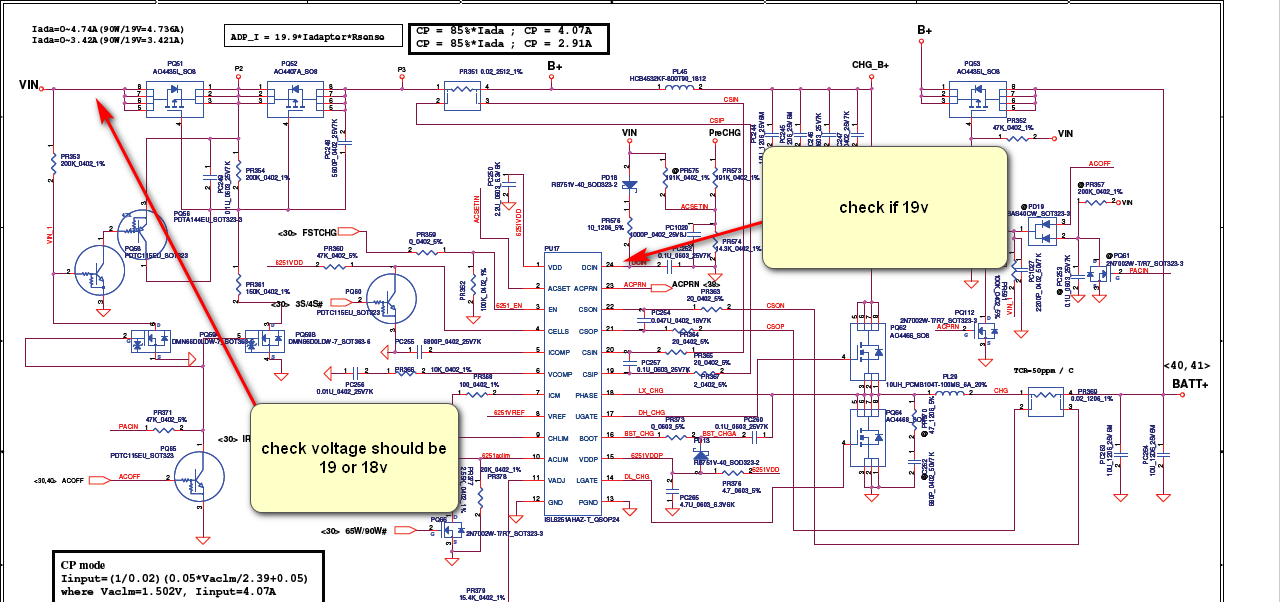

            1: check VINN voltage line near pq51pin 8,7,6,5 if 19v.
            2: check voltage on pq51 pin 1.
            3 pq52 check pin4 and pin8.
            4 pu17 check pin24 voltage
            Work from. Here

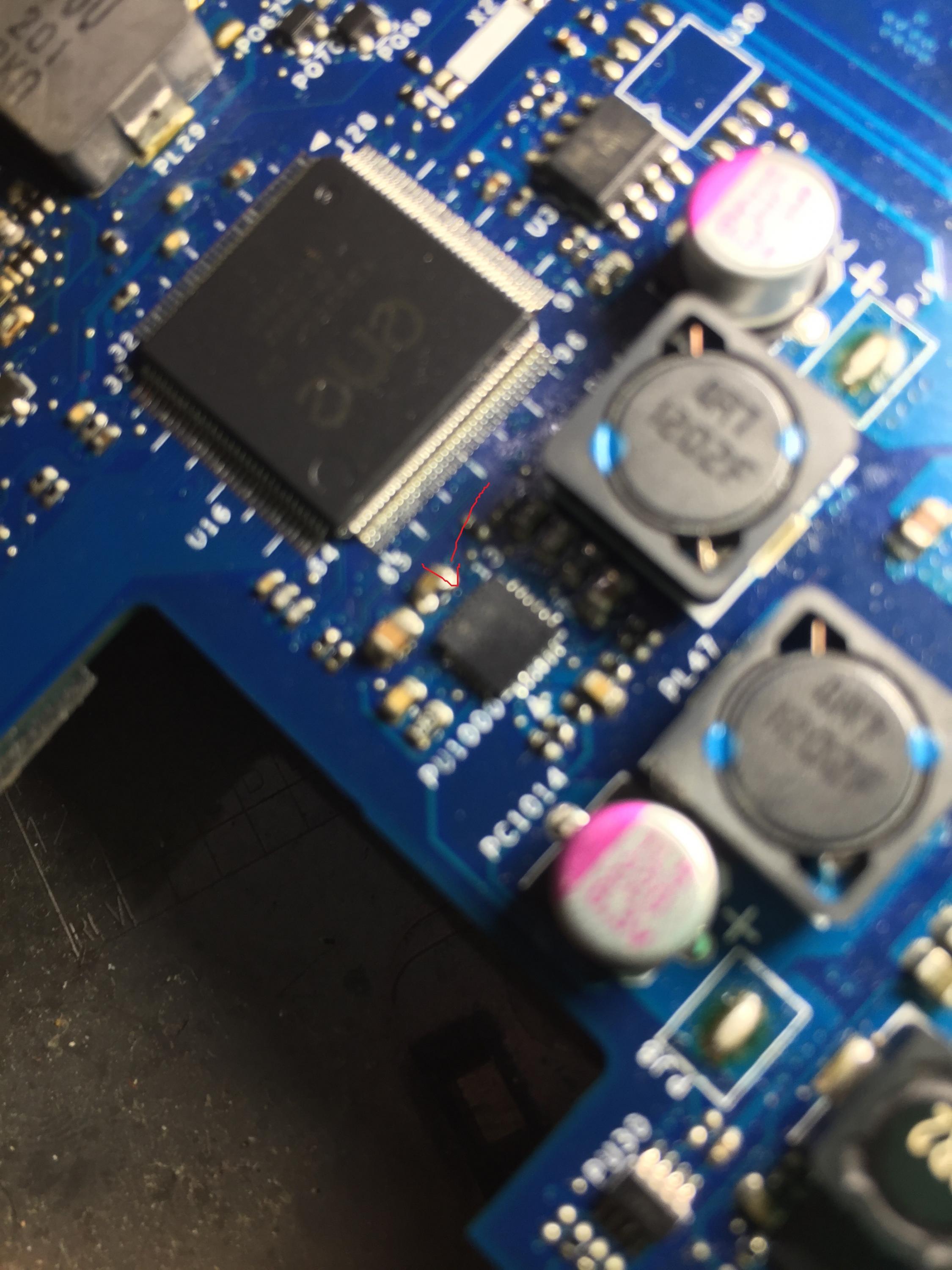

              now its stable voltages on pq52 i just replaced it again with new one mosfet but there is another problem if i plugged the charger it taking 0.240amps on bench lab but when i touch and measured this cap near SIO chip, it drops to 0.001 amps and can turn on and goes off back to 0.240 amps and when i touch with the probe again it shows 0.001.maybe someone replaced this cap here is the image of the cap if i touch the ground side with probe it goes to 0.001 and can turn on the laptop then goes off and back to 0.240amps
                  The small IC below the cap, what part number is that on the board, PU ? . The small IC ,what pin is connected to the cap

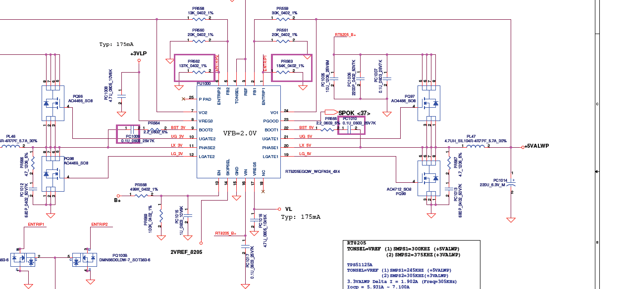

                    here is this small ic
                    test the volages on pu1000 vin.
                    also se if all pins shorted with gnd like before, u can try replace this.

                      #30
                      the chip is PU1000 the other side of the ceramic caps connected to PIN16 of PU1000

                        #31
                        @steve2001 I already done replacing the pu17 isl chip as i mentioned on my previous post.the small ceramic cap is PC1017 one side connected to PIN16 of PU1000 and other side is connected to ground.if i touch with the probe the ground side it goes to 0.001miliamps and can turn on the laptop and the goes off and back to 0.240amps.
                          and i noticed also from 0.240amps if i touch with the probe the black to ground and red to ground side of cap PC1017 if i steady touch it goes to 0.150amp if i release it goes to 0.01miliamps and if i touch again it goes back to 0.150amps and if i removed goes back to 0.01miliamps and can turn on the laptop and goes off and back to 0.240amps
                            change PU1000 the PC1017 is connected to vin pin of that ic.
                            replace the ic and se

                              #34
                              in the board that chip is TPS 51125A but in the schematic it shows richtek RT8205E does this chip defective?

                                #35
                                TPS51125 Dual-Synchronous, Step-Down Controller With Out
                                -of-Audio™ Operation and
                                100-mA LDOS for Notebook System Power
                                Wide Input Voltage Range: 5.5 V to 28 V
                                • Output Voltage Range: 2 V to 5.5 V
                                • Built-In 100-mA, 5-V and 3.3-V LDO With
                                PU1000 change it
                                    RT8205E = TPS51125A These are pin compatible . You can check the datasheets,or look for a IC compatibility list ,theres some here on badcaps https://www.badcaps.net/forum/showthread.php?t=33846
