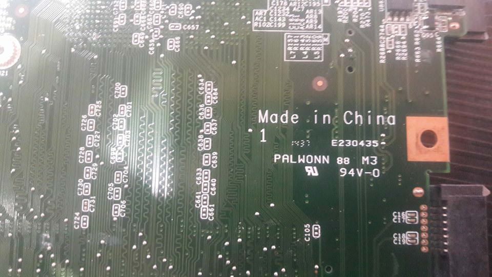

    My problem with this device is fault power and is charred and unknown model...

    i don`t think a schematic is available. check this on chinafix it might give you some clues to which parts you need to replace

      Re: cyperpowerpc fangbook hx6 not powering
      thx bro SMDFlea
      clues from chinatopic >>
      may be OZ8690LN ic ... is appropriate but not sure
        Theres no IC on that part of the board. Look at some more images for reference . My mistake ,there is,unless theres different revisions.
          U50 looks burnt, can you clean it up and get any part number from it
            I think U1 is a OZ8690LN ic , and U50 is a NB671L
