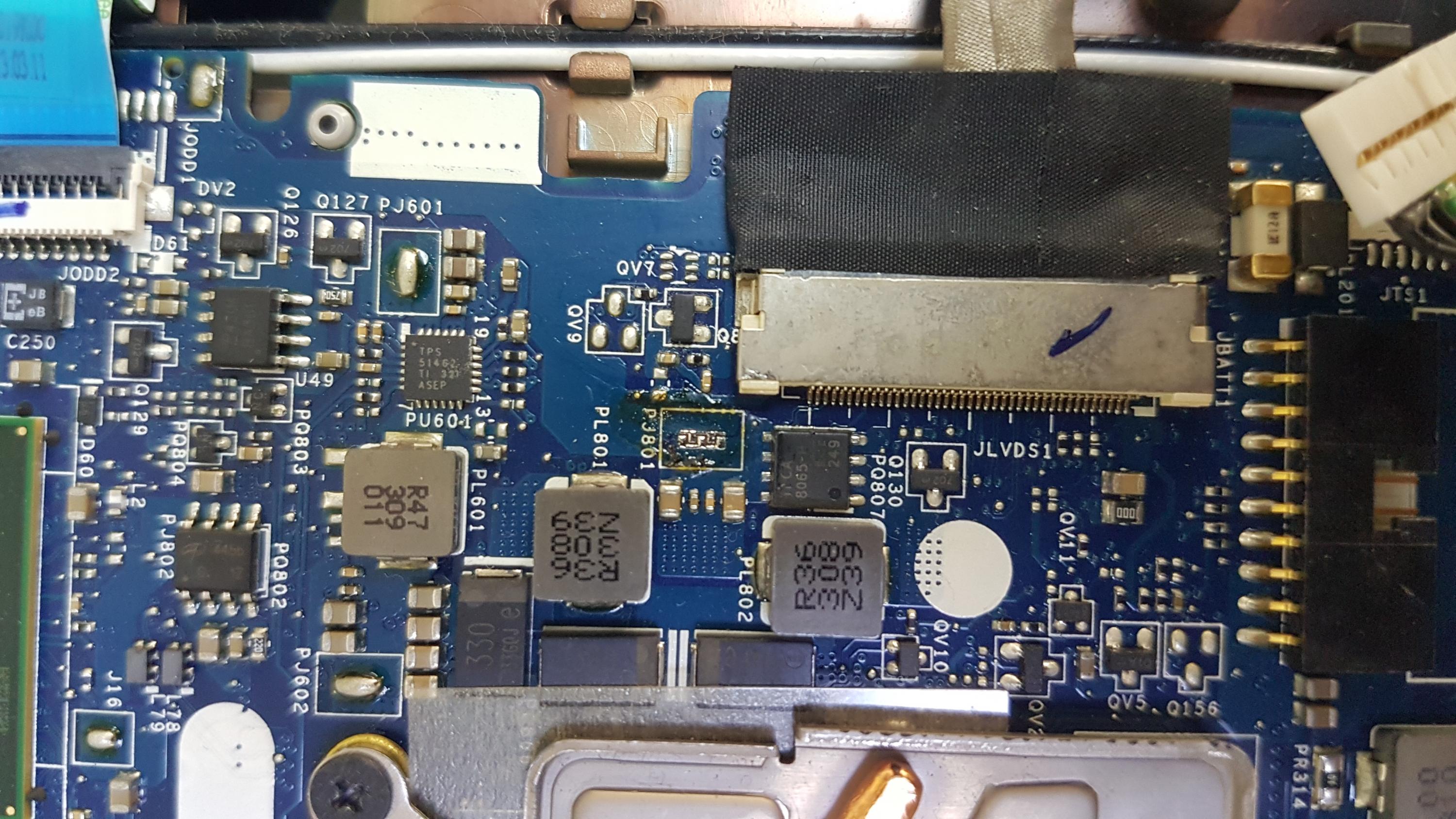

    Dear Technicians,
    I have got a Lenovo Z500 LA-9063P with Discrete graphics chip.
    Does anyone know how to convert it to UMA graphics?
    thanks
    this is the link to schematics:
    https://www.badcaps.net/forum/attach...4&d=1475419816

    Re: Lenovo Z500 Dis-to-UMA
    Try by removing graphic coil first. If it doesnt work the shift
    R708-R711
    R298-R246
    R703-R705
      thank you
      Removing the graphics coils did not work. I need boardview of Z500 to locate those resistors on the mainboard. But I did not find the boardview.
        Does anyone have the boardview of Z500 or know where the resistors (R708-R711-R298-R246-R703-R705) are located?
          • 21907
          try these injstructions,use google translate ,right click on image open in new tab . This is for la-9061p
            http://www.rom.by/forum/Peredelka_Le...A_otklyuchenie
            Caspian , going by this article, my advice seems to be correct though i never tried conversion on this mobo.
              thank you, SMDFlea and mcplslg123. I will try and report if it works.
                Clear PJ801 jumper
