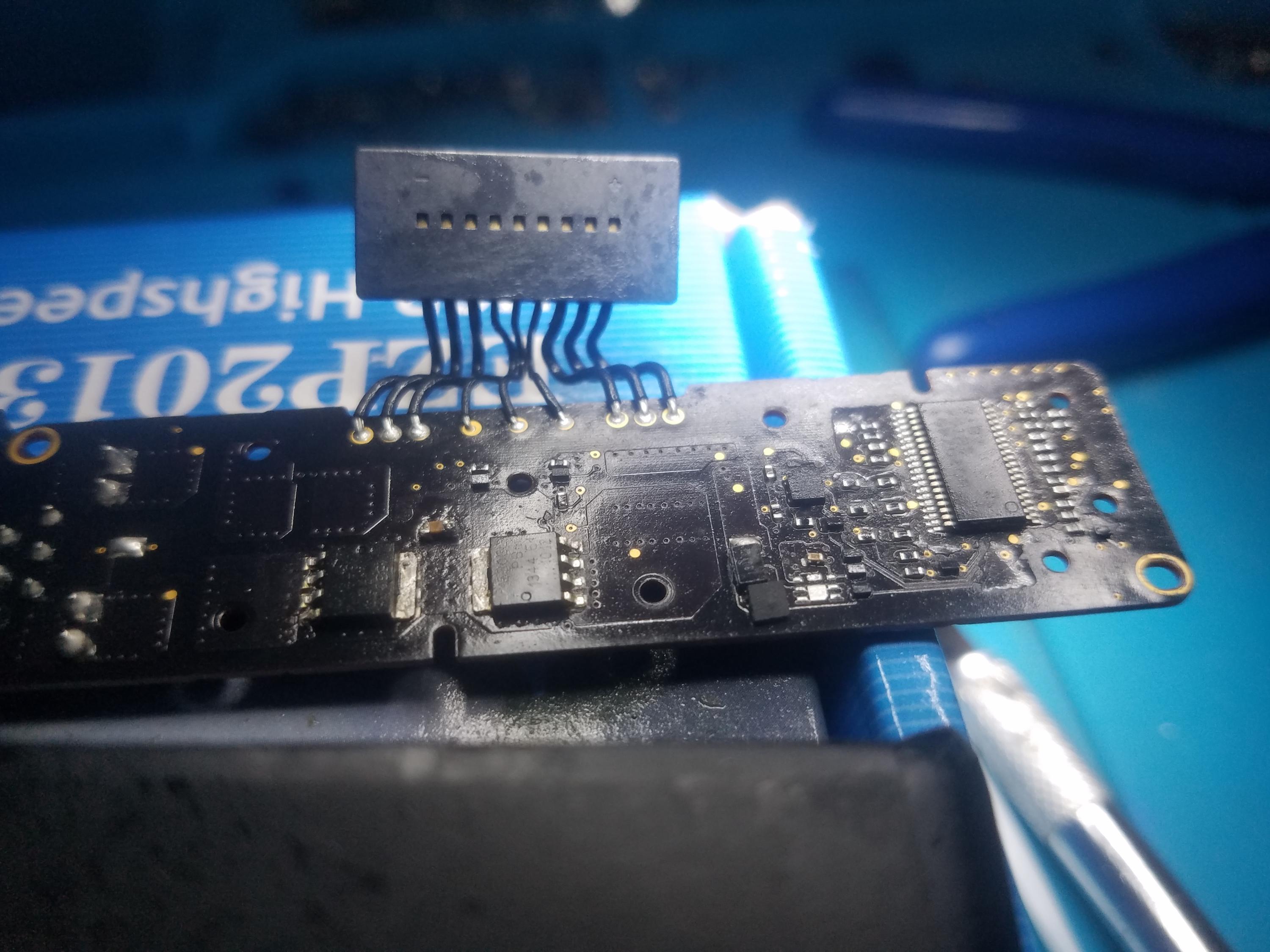

A1530 X on battery not charging, off when unplgd,FOUND ISSUE just need to Identify.
  • Blacktek
    • Nov 2014
    • 250

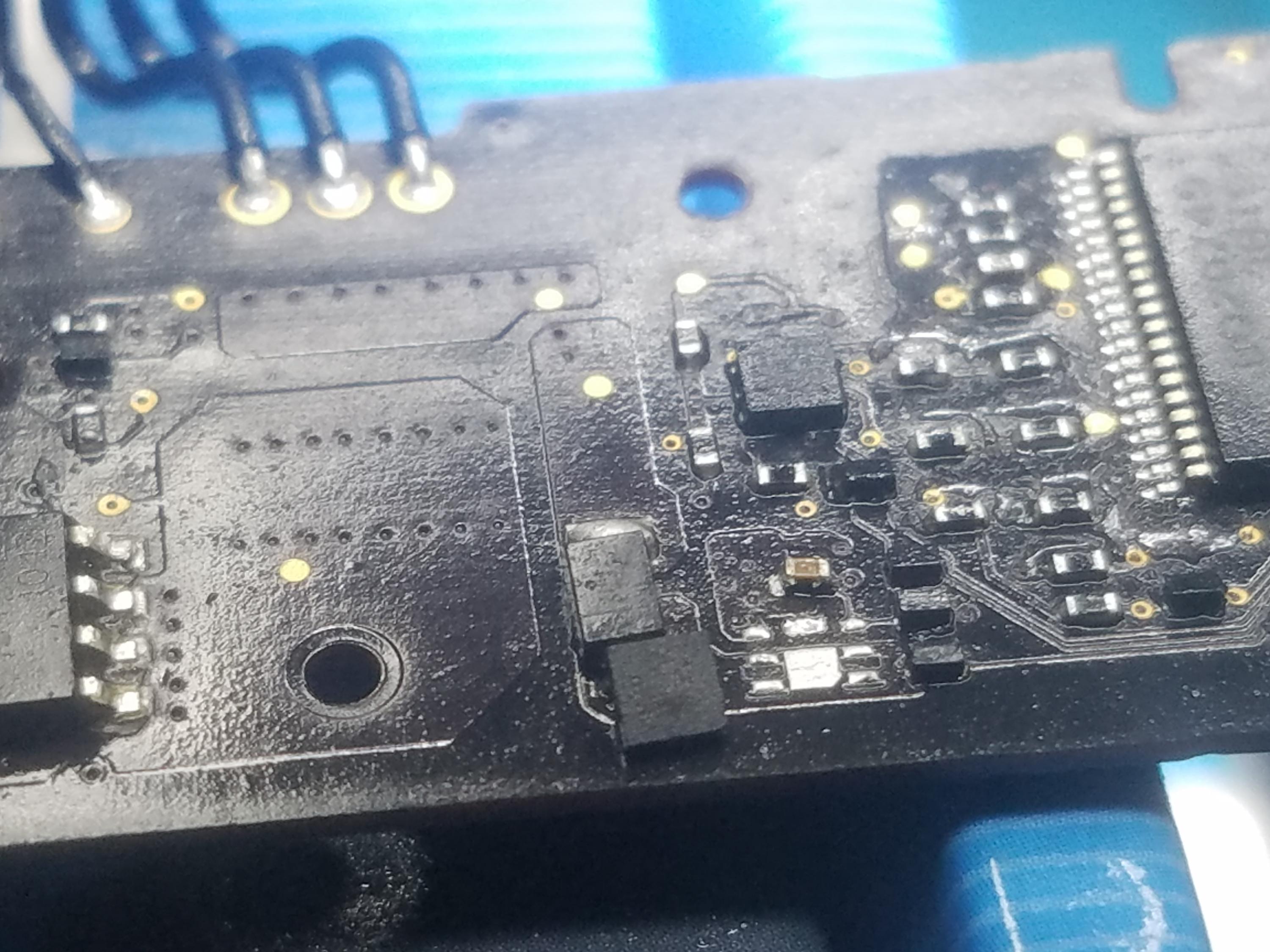

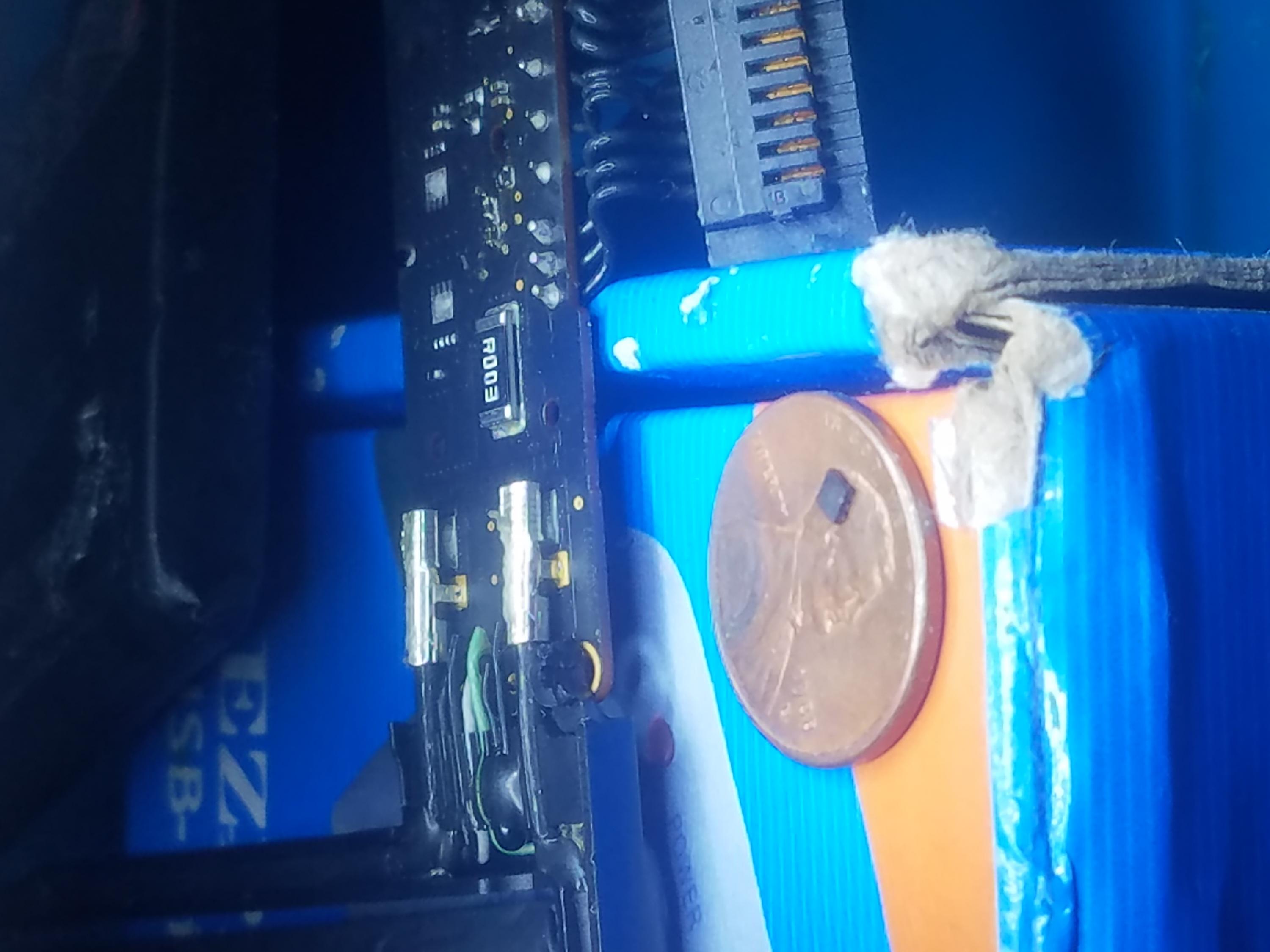

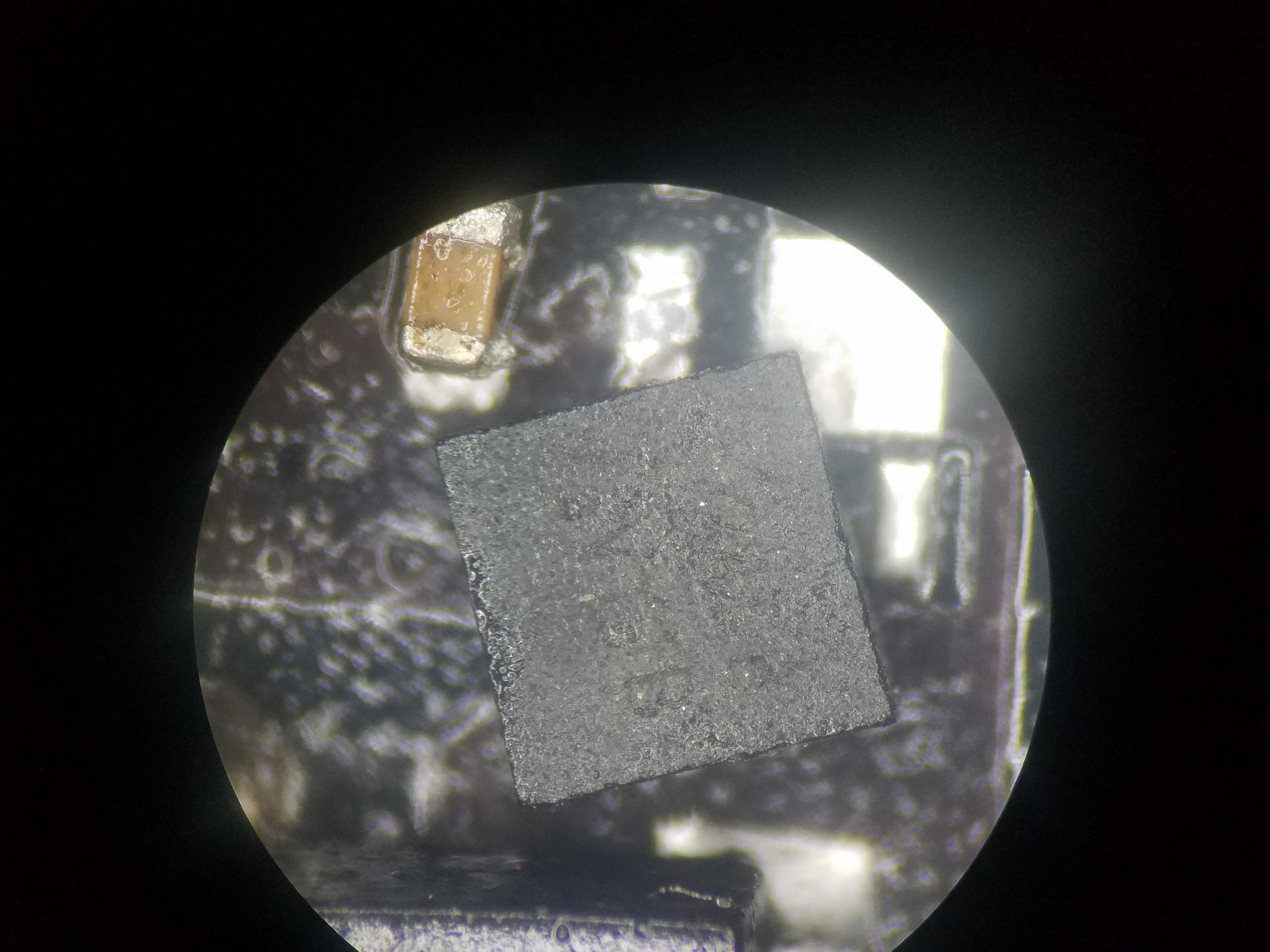

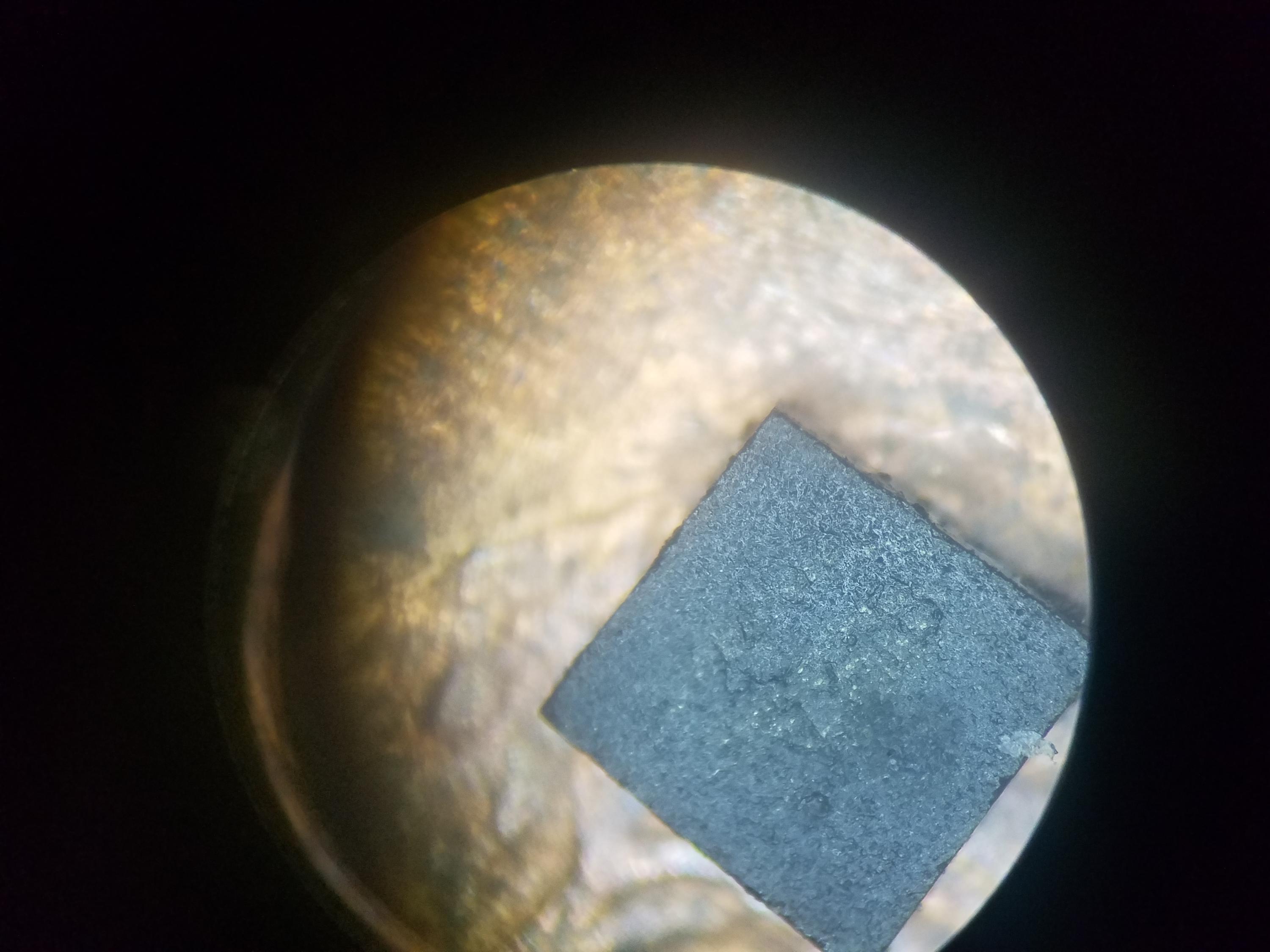

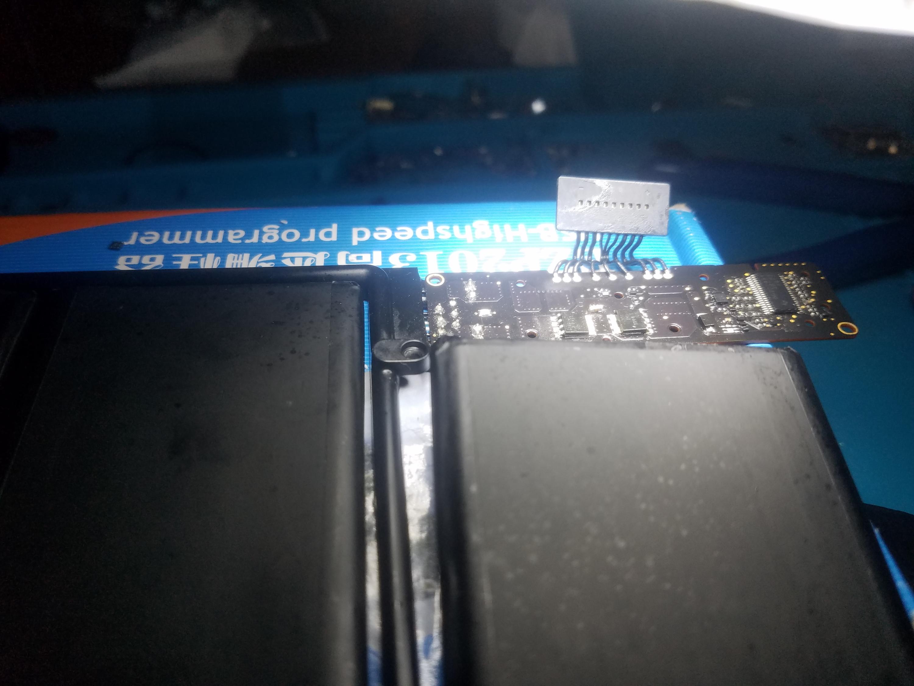

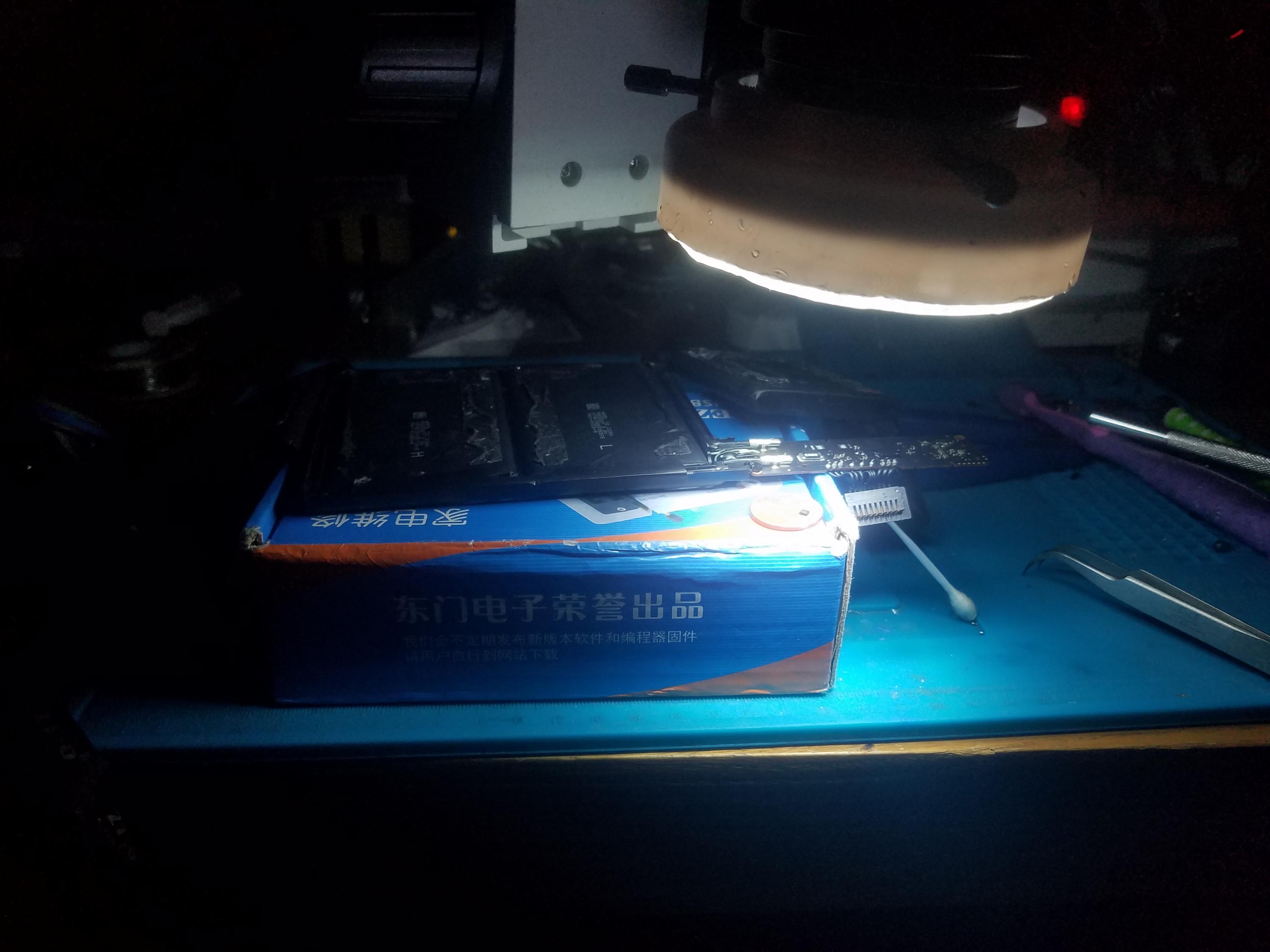

    Hi guys , After a couple Hours at cleaning, reflowing/retouching corroted spots, and even repaired/reconstructed trackpad ribbon cable because the mouse was out, would not move. So NO NEED TO BUY NEW BATTERY OR TRACKPAD
    Long story short, im gonna attach photos of this little bugger that took me a while to find.
    Please let me know specifications or datasheet to see if i can replace with somthing else, all suggestions are welcome.
    By the way there is no shematic for the battery pack board 820-3503-A, had Shorts everywhere, so must've taken about 7 components that looked critical on its circuitry, i almost gave up.
    anyways, any input is appreciated!
  • Blacktek
    • Nov 2014
    • 250
    Re: A1530 X on battery not charging, off when unplgd,FOUND ISSUE just need to Identif
    Sera que le hago un jumper? alguna idea?
    • Blacktek
      • Nov 2014
      • 250
      Never mind guys, even though the battery is now putting out 10.40 approx, it still shows the interrogation triangle, so something else must be off. i guess ill check the current sensing and the charging ic.
