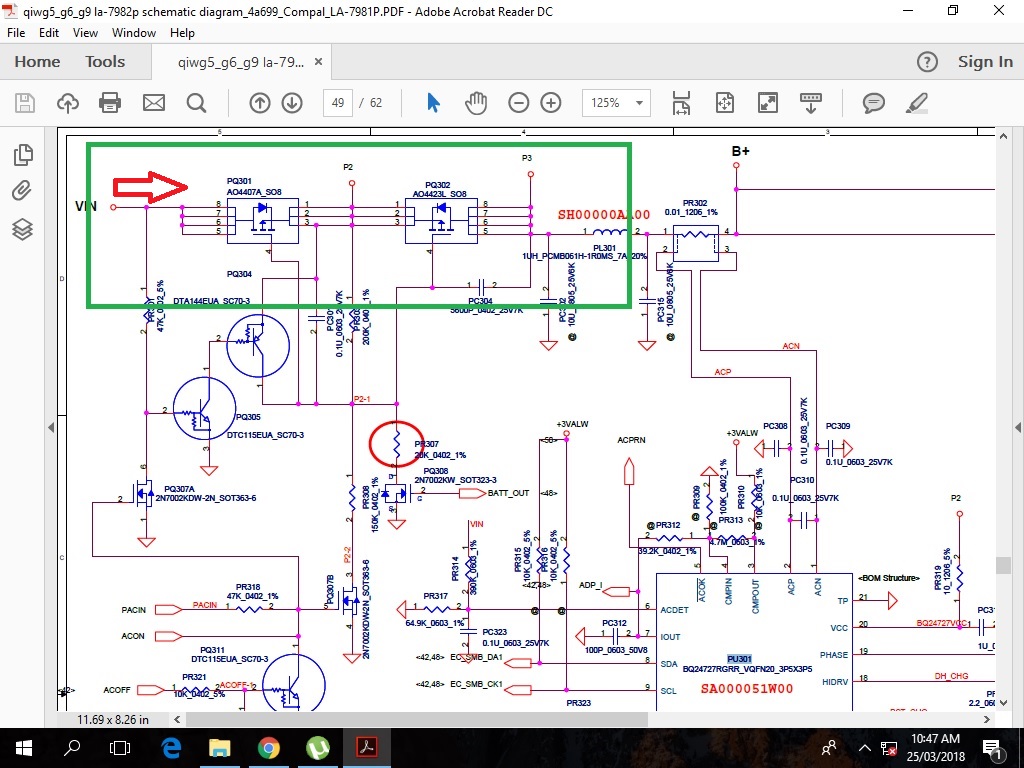

    Unit model: Lenovo G480
    Mobo PN : QIWG5_G6_G9 LA-7982P
    REV:1.0 2012-01-17
    synopsis: this unit bring here no power already repair from another shop costumer tells technical render need to change a motherboard (MOBO) also we need a 2nd opinion about her Laptop. i told her need to check actual. she allowed me to do. 1st. i open the unit. I saw already repaired (Tampered Unit) and 2nd. have a history on Water Damage ( have Corroded on area of EC "Multi I/O Chip"). i explain to do and process of my repairing. now she agreed repair.
    - i wash the Mobo make it clean. then to wipe out the dirt and stain, flux , corroded. luckily no parts missing
    - i blow dry the mobo to dry and i inspect the open circuit luckily no. but on the EC Multi I/O Chip have . i proceed to do what i can. remove and check the trace. then i re installed the EC "Multi I/O Chip".
    - yes have a Power now But No Display Fan spin and stop the spin then stop.
    let me know how to fix this. but i check the main rails
    lets take a look this image
    the here is my measured on main rail Mosfet
    PQ301
    AO4407A_SO8
    PIN 5-8 (19VDC)
    PIN 1-3 (19VDC)
    PIN 4 (5.8VDC) ????? Question it is normal?
    PQ302
    AO4423L_SO8
    PIN 5-8 (19VDC)
    PIN 1-3 (19VDC)
    PIN 4 (5.8VDC)????? Question it is normal?
    i think Gate low Voltage? Any Advice
    TIA

    main rail mosfet are ok. you can try reprogramming KB9012.
      do you have a Firmware or bin file for this?

        Here is the kbc dump for LA-7982p.

            Check display jack voltage if present.
