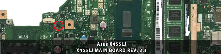

    Good day everyone.
    Need help to identify type of ic power asus x455lj..
    part marking is 2N=3E
    What's the type of ic?

    Hi, 2N= is the marking information for this RT8249CGQW chip from Richtek.
