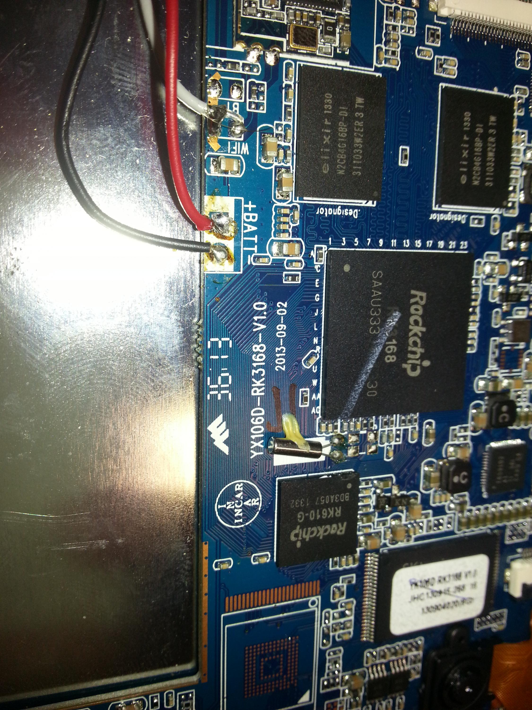

    Good day folks. I'd like some help with a bricked tablet I got going on here. It's technically a Serioux S1081TAB, but I've seen this exact same one under many other brands and models, so it doesn't really matter.
    The problem is as follows: when I got it, the Serioux logo would come on and then it'd display "no command" with the android on its back with a red triangle above. Simply resetting it didn't yield any results. After a lot of searching, I DID grab some firmware files that SUPPOSEDLY you write onto a card with PhoenixCard, put that in the tablet, power it up and it loads the firmware, but of course this didn't work. I wrote the card OK each time, but the tablet didn't do anything different: it just ended back on the "no command" screen, so this was definitely not the way to go. I handed it over to my buddy who's more vexed with tablets than me and he tried a different approach: using the RockChip Batch Tool. He grabbed a firmware (.img file) that, again, was SUPPOSEDLY compatible with this tablet, despite being for a different model, the RockChip tool accepted it and flashed it to the tablet but now the problem got worse, since it no longer turns on AT ALL. All I get is a backlight and that's it. The thing is the tablet COULD actually be booting up, just not displaying any picture. He tried a bunch of different other firmwares from different tablets, chinese, generic ones, but it was useless: it simply won't display anything anymore......
    Having a look inside, I decided to go by board model rather than by tablet model, since this exact board could be used in several other tablets, so have a look at the pictures and see it rings a bell. The model on there is a YX106D-RK3168-V1.0 If so, I'd much appreciate some help. I'm close, but just can't hit the sweet spot. Cheers and thanks.

    Chek this
    http://chinagadgetsreviews.blogspot....-stock_13.html
      Re: Rockchip tablet firmware help
      Think we already tried that one.
      Wattevah...
        this one ?
        https://docs.google.com/uc?id=0BzQuM...xport=download
        ty this one i think this is your model
        http://forums.easy-firmware.com/show...IRMWARE-rk3168

          Will try those last two ones as well, since I don't recall seeing them so far (unless my buddy somehow find them while I was away earlier today).

            Second one has a password....

              Try this one
              https://www.dropbox.com/s/sng7buobgu...-v1.0.rar?dl=0
                Well I tried all of those firmwares, but they do not work: same issue as before, it loads but doesn't display anything, so I'm not gonna bother with the last one for now because I doubt it will be any different....my buddy says he'll take it to another buddy of his who can flash it with an infinity....something box thing a majig
