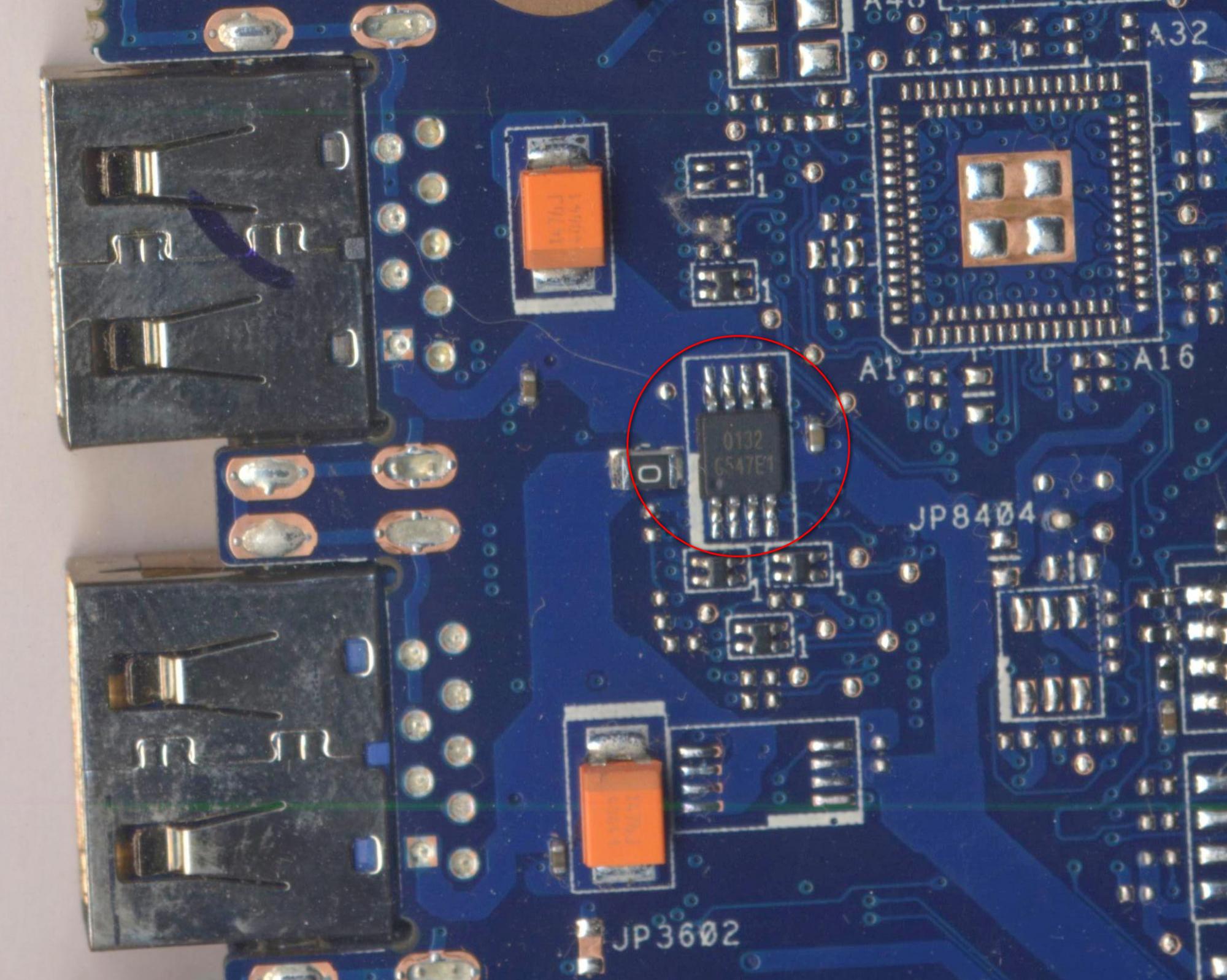

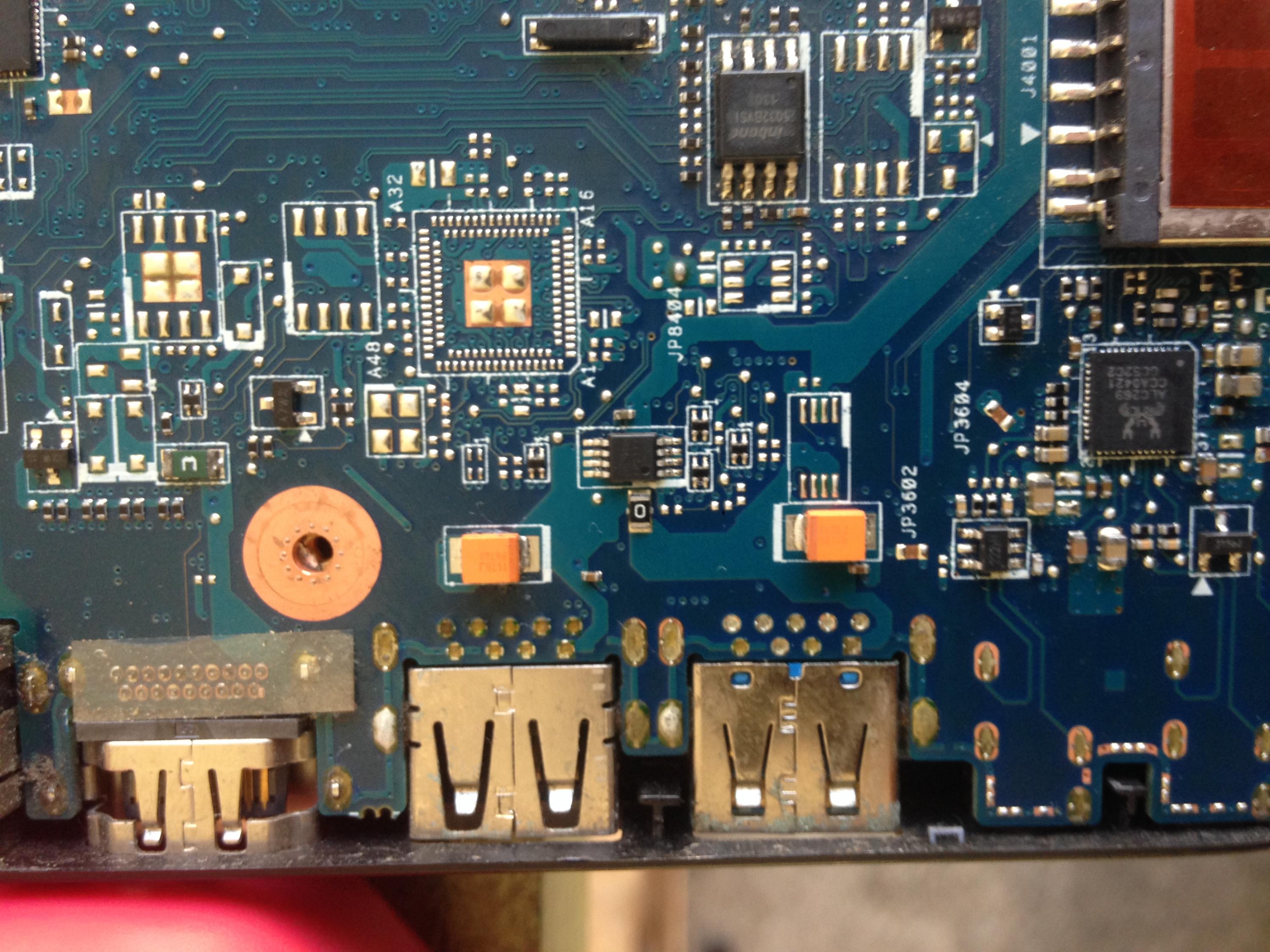

    I need help on this Toshiba Satellite C850-B907 BOARD ID:PLF/PLR/CSF/CSR UMA MB REV:2.1.The laptop works fine then suddenly all usb ports not working.so, i checked first all ports for voltage but there is no 5v on all usb ports.Can you help me on this please

          Re: Toshiba satellite C850 all usb ports not working
          I can't find a free schematic for that board. But there is a switch IC next to the USB ports. It has 8 pins and the pinout is as follows:
          1 - Ground
          2,3 - Input voltage
          4 - Enable signal (5V = enabled)
          5 - Overcurrent signal (0V = overcurrent/overheating condition detected)
          6,7,8 - Output voltage
          When the EN signal is set high (3-5V), then voltage from the input pins is allowed to travel through to the output pins.
          Check to make sure there is 5V on the input pins. Check to make sure the chip is getting the 3-5V enable signal. If both of those are true, and if 5V is not appearing on the output pins, then either the chip is bad or there is a short circuit on the output.
          On the other hand, if there is no 5V on the input pins or if the enable signal is not 3-5V, then you need to investigate why.

            thanks for the response i found the chip and checked it, pin 234 have voltage of 5v but on the output pin 678 there is no voltage. could the chip be bad or there is a short circuit on the output?anyone please help

                      thanks for the respone bluemidnight i double check again the written on the chip i was wrong sorry its AP2111.and checked again with beeping mode pin 678 not beeping to ground

                          i have attached the image of the chip.i checked with continuity from the output on pin 6 and 7 connected to two caps at 1 resistor with mark 0
                            Yeah, you're going to have to start removing components to isolate the short. There aren't that many possibilities, so it's the easiest way.
                            I'd start by removing the IC. If the short is gone, then just replace the IC with a new one.
                            But if the short is still there after removing it, remove the 0 ohm link resistor next. That will divide the 2 USB ports so you can see which one has the short. Then, you can check the capacitors on the shorted port.
