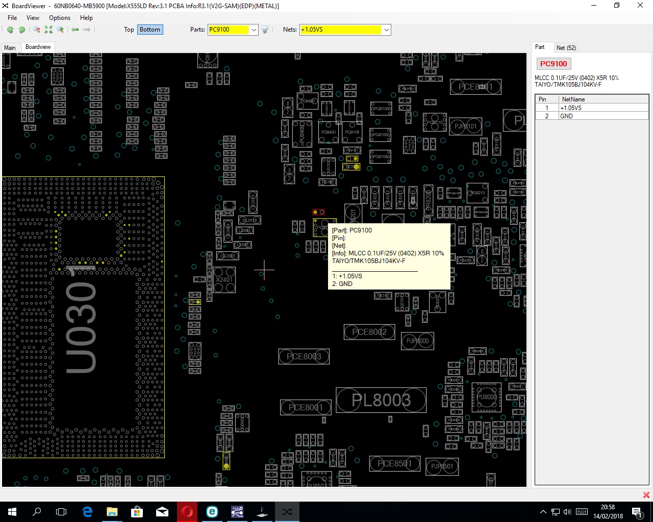

              i have the capacitor PC9100 in short. i remove the capacitor and the short to be continued.

                How much resistance to GND is on 1.05vs ?
                • jp_jota
                  • Feb 2018
                  • 48
                  • portugal
                  Re: asus x555ld not turn on.
                  pin 1 3.10
                  pin 2 0.09

                    Did 1.05vs exist on pin1 before removing this capacitor? I mean how much voltage on pin1?
                    it would be better solder the capacitor back onto the board.

                      no, i just remove and test the line, and put it back again. not power on without the capacitor

                        its normal the cpu have 1.08vs without the power on the botton on?

                          when the laptop is off, 1.08vs should be 0v. Does the fan spins? Any LED gets on or blinking?

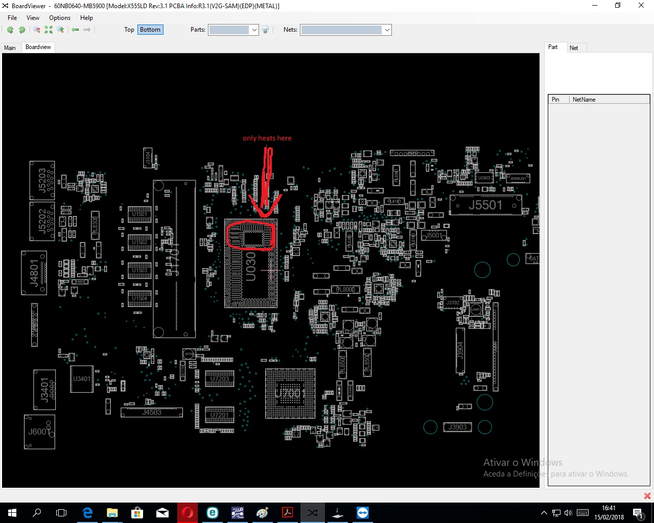

                            i think the same, but in this case the cpu heat up after i plug the ac.
                            no leds and no spin, and i have the 3.3v in the botton on / off

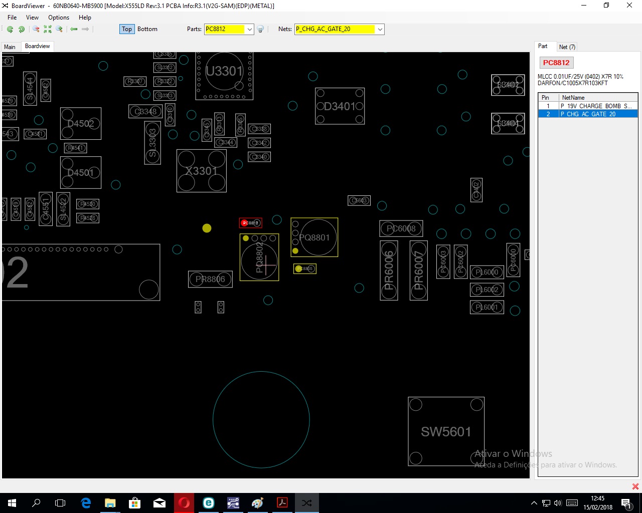

                                thanks for the help. its get warm to burn your fingers. but I found something strange, I have in the gate of the mosfets PQ8801 and PQ8802 24v, I already went to measure to the pwm and leaves the 24v from there. should be 19v
                                    its correct, 19v. only gate get 24v. in the boardview say 19v in the gate, and i have an equal board here but damaged too and it leaves 19v of pwm PU8800.
                                    yes i have a heatsink installed for the cpu not to heat too much, it only heats in the small part of the cpu, in gpu I think.
                                    gpu nvdia not heat.
                                    on the whole board is only heated in the cpu.
