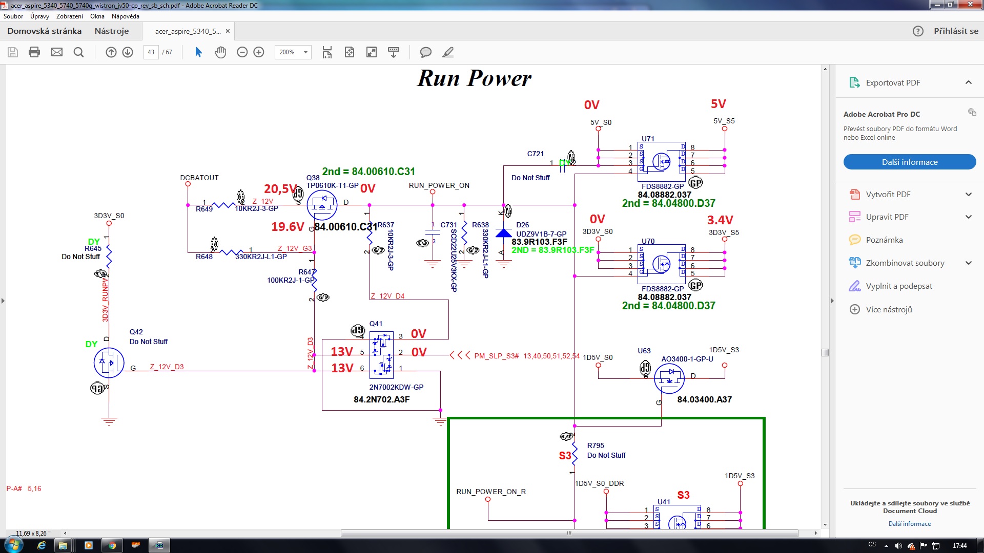

    Guys, I have troubles with Acer Aspire 5740g. When changed burned U72 TPS51123 for 3/5VALW I cant get 3D3V_S0 a 5V_S0, see picture. What could be wrong here?

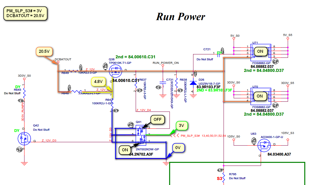

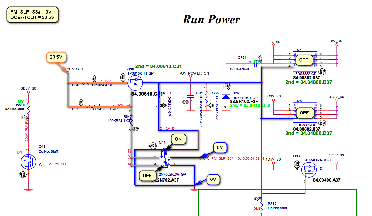

    The S0 power rails will only be active after the power button has been pressed. After pressing the button, PM_SLP_S3# should go to 3V. Your picture shows you measured 0V. That will keep U70/U71 turned off.
    But that 13V doesn't look right. That tells me current is flowing through that path even though the bottom FET in Q41 is supposedly turned off.
    You measured 20.5V, 19.6V, and 13V. If the bottom FET in Q41 is off, you should measure 20.5V at all three of those places. If the bottom FET in Q41 is on, you should measure 20.5V, 4.8V, and 0V in those same locations. It is acting like Q41, and possibly even Q38, have shorts. Either that, or they are pulsing on and off quickly (which they shouldn't be) and 13V is just the average voltage.
    A pulsing voltage can be checked for using the AC volt setting on your meter (or an oscilloscope). If none is present, then Q38/Q41 can be removed to check if all three voltage measurements rise to 20.5V. If so, one/both of those is bad.
    If a problem with that circuit can be ruled out, and if pressing the power button does nothing, then you will have to find which prior step the motherboard is not doing properly.
