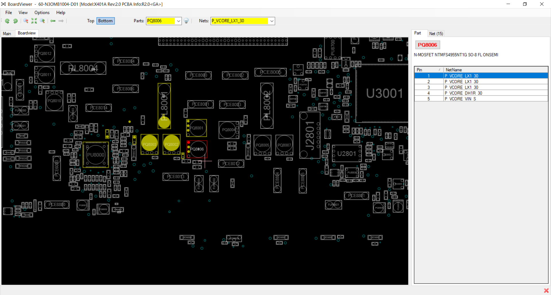

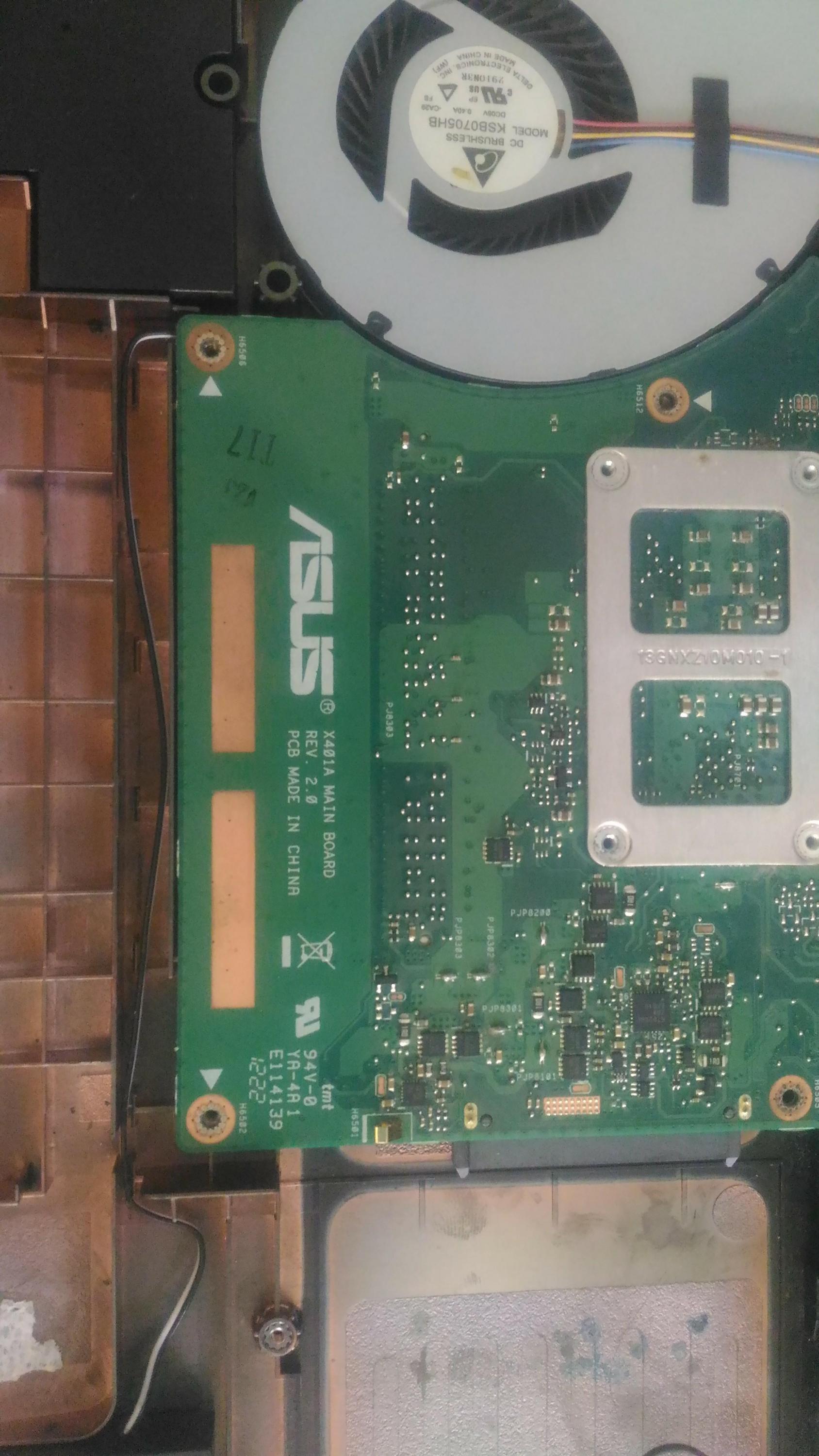

Hi good day to all! Just newbie in laptop repairing, can anyone help me about this ASUS X401a having power but no display. I have notice that Vcore Mosfet PQ8001 and PQ8006 including the caps are getting very hot but having 1.06V output... Can somebody help me solving this laptop issue... Thanks in advanced!
ASUS X401a No Display
Re: ASUS X401a No Display
What's the resistance to ground of the VCore line?
What's the voltage on the CPU reset signal?OpenBoardView — https://github.com/OpenBoardView/OpenBoardViewComment
