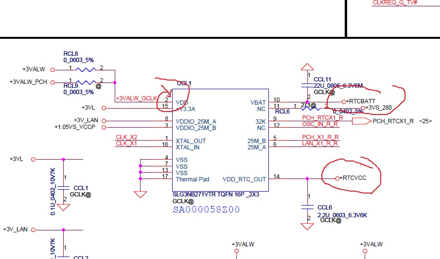

help me please toshiba qfkaa la-8391p
  • mustafa007
    • Apr 2017
    • 3
    • turkey
    toshiba qfkaa la-8391p rev 1
    power 5 seconds led worked with close
    vcore not voltage
    vram not voltage
    there are 5v and 3v

        Re: help me please
        UCL1 check pleas

                          Re: help me please
                          Originally posted by vedoza
                          UCL1 check pleas
                          No power on these pins... none

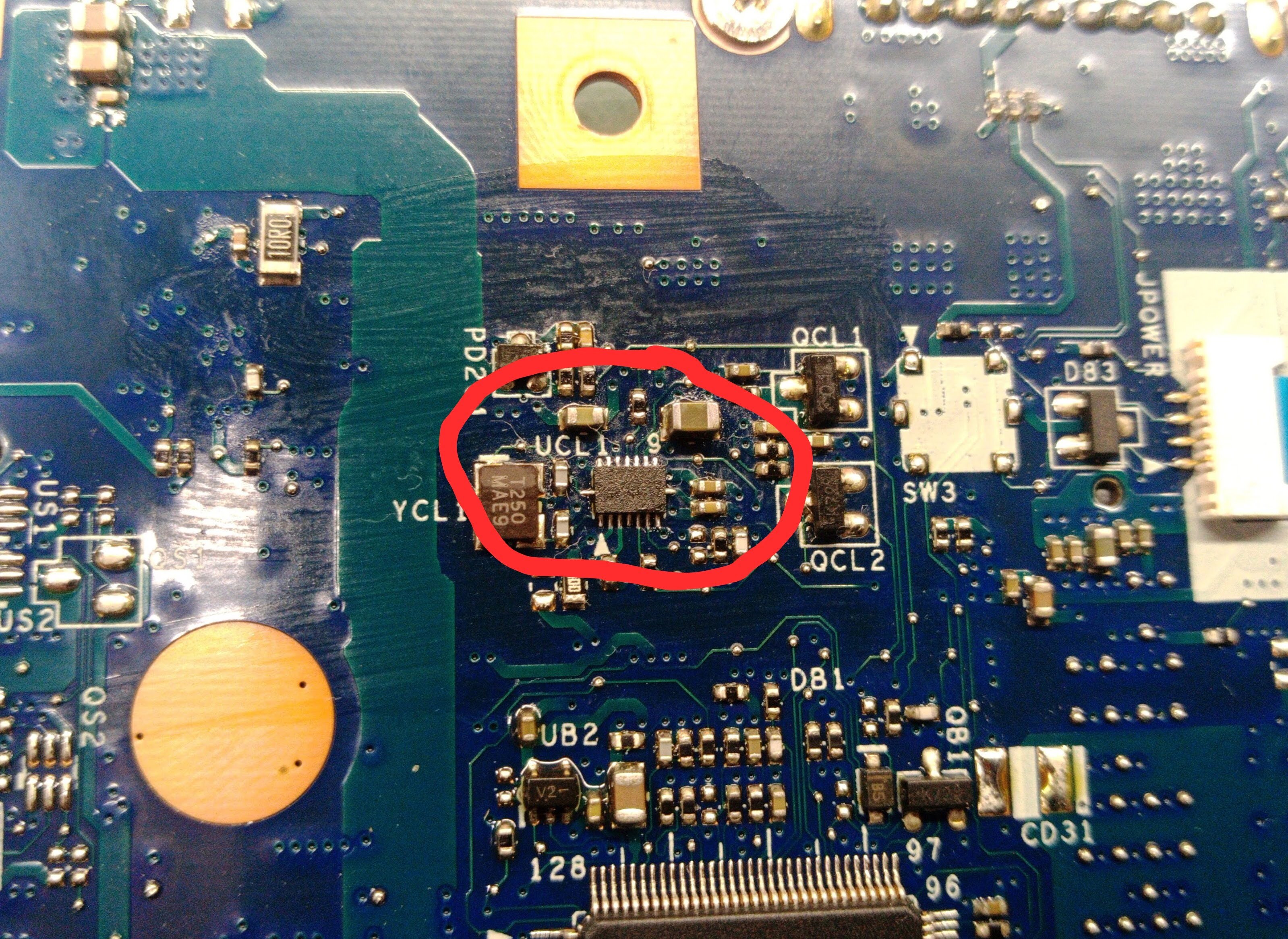

                              Hello, i have this problemfrom the discussion, I realized that it’s a good option to resolder ucl1, but I don’t understand where it is located on the motherboard, even according to the diagram that was thrown off above (an ordinary stupid student who wants to bring his only laptop back to life)

                                Re: help me please toshiba qfkaa la-8391p
                                Search for a small rectangular black chip that will have 4 solder pins on each side. For a total of 16 contacts.
                                This part will be 2mm * 3mm in size.
                                It is a TQFN package so will be a thin height, quad flat shape with no pins but with flat solder tabs under the chip itself.
                                Post picture of anything that may resemble this shape.

                                  Another Toshiba P850 that works after soldering UCL1
                                  This chip provides clock signal for the RTC​
