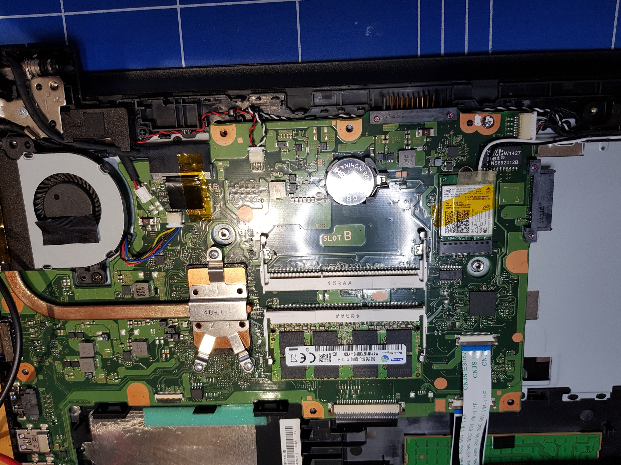

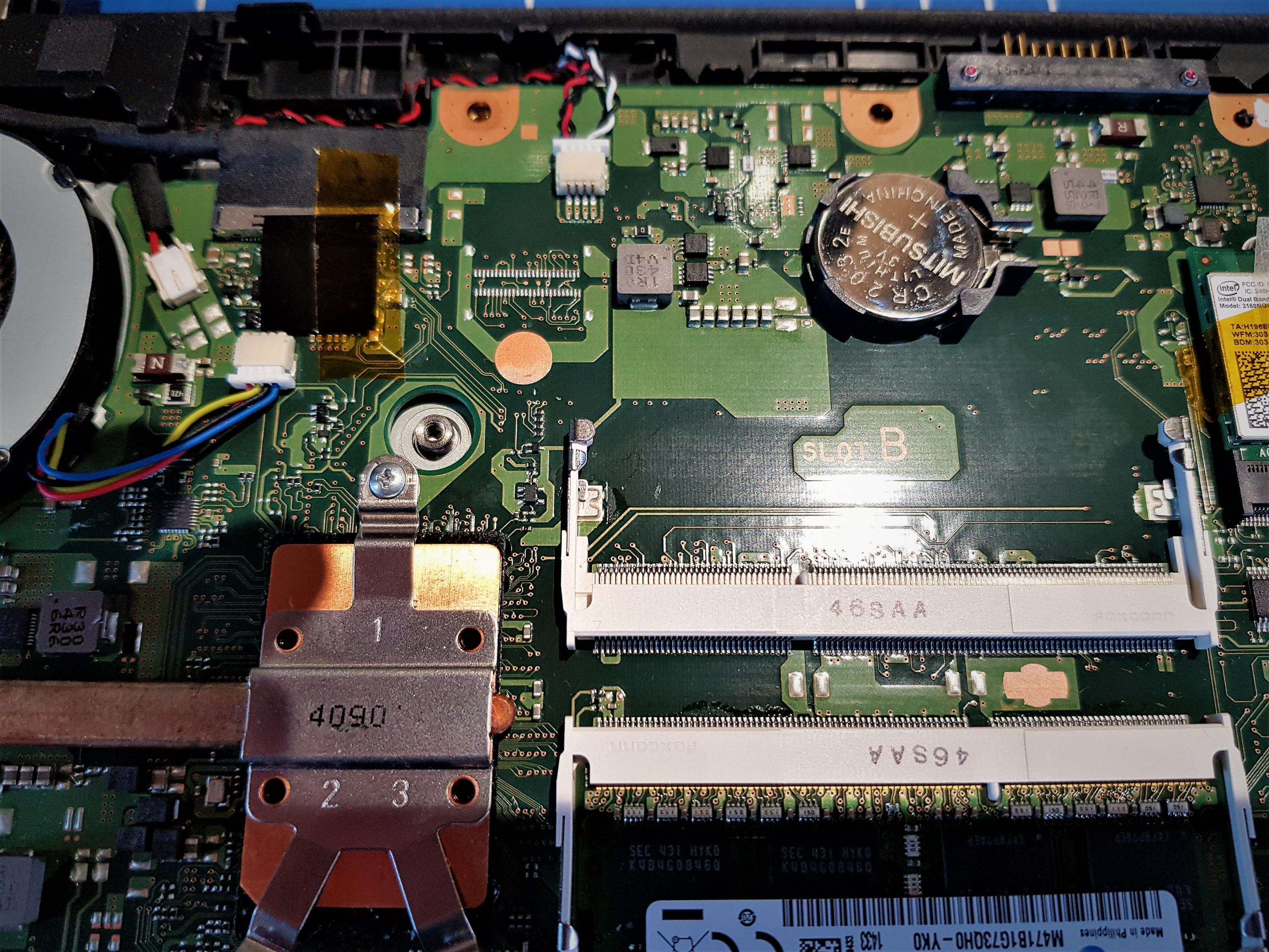

    Hi, just been given a Toshiba R50 B 123 that had water spilled on it. I have cleaned it up and all appeared OK apart from the keyboard (Cheap fix i thought) However although the laptop works it doesn't charge or run from mains. Runs perfectly from battery until it runs down. My question is could anybody help me with this issue. Is it just a fuse? if so could someone help me locate it, if not what other options are left. I have added pictures of the board.
    Thanks in advance

    I guess that the fuse you're looking for is the brown part with an 'N' right next to the power connector. It can also be a shorted DC-in MOSFET (I don't know which ones are they, you would have to trace out the circuit with your multimeter in continuity mode) or a dead charger IC for example.
