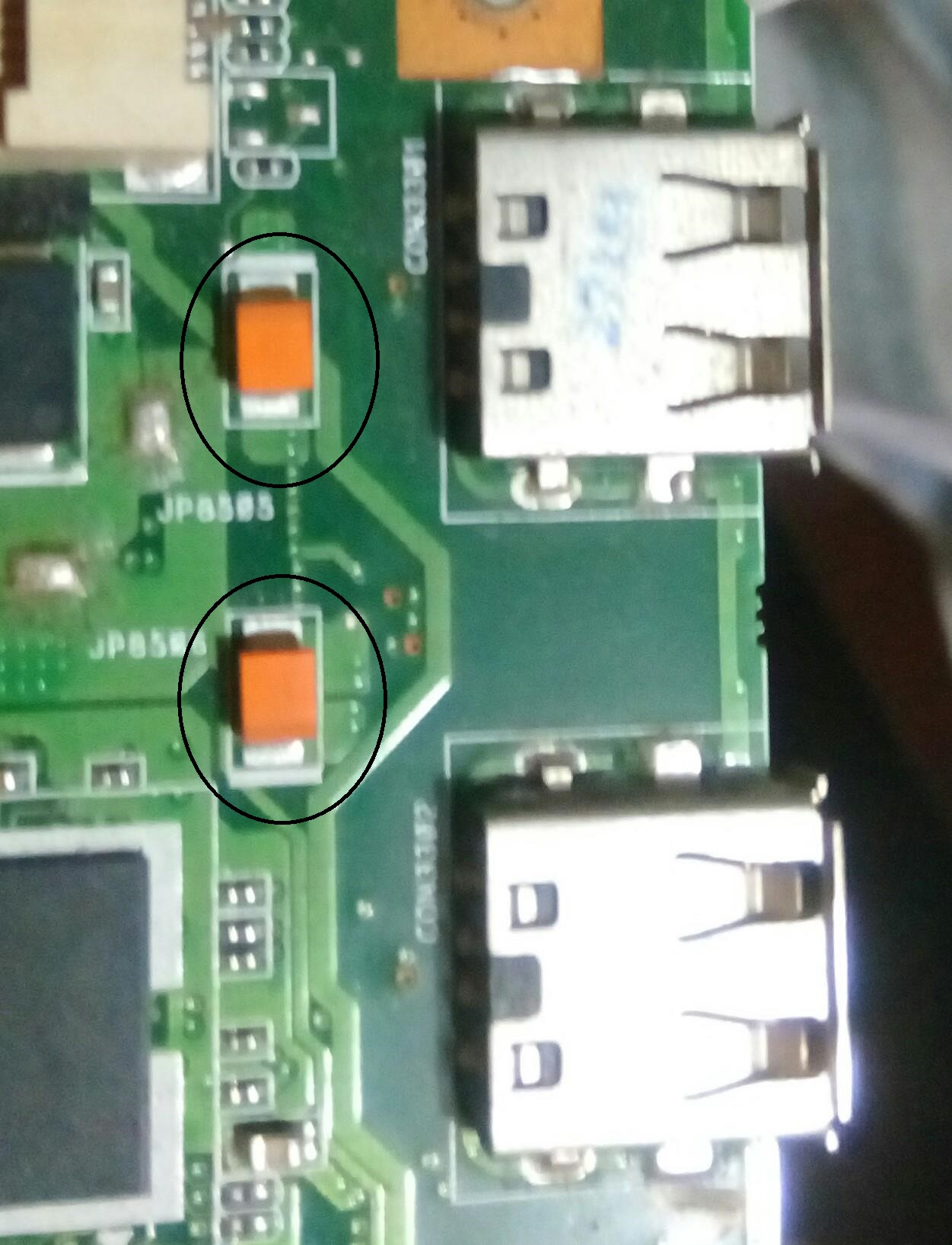

                  try replacing filter capacitors PC46 and PC58 with tantalum caps take from USB port.

                      @fddizon thanks for the response kabayan i just want to ask what value of tantalum caps?
                        Re: acer aspire one d270 no display
                        Should be 220uf 6.3v
                        but you can try 147uf 6.3v coming from USB caps

                            @fddizon i cannot find 147uf 6.3v but i have here in scrap board 157uf 6.3v and 227uf 6.3v which should i try?
