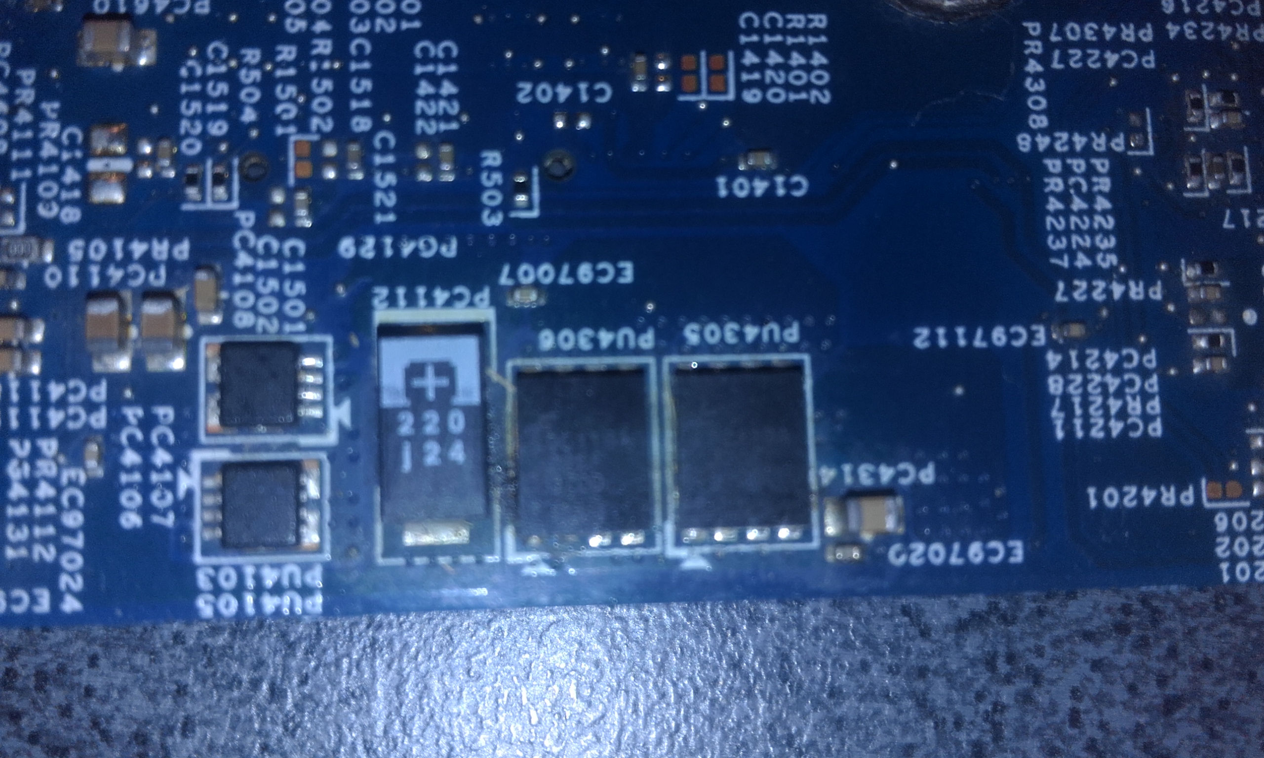

    Hi, This HP Envy DV6 will turn on, fans spin but there is no video output. I have noticed components marked DC11BA 22CF 070D get hot. They are Fairchild mosfets I think. However I can't find any information on them and there doesn't seem to be any schematic available. I would be grateful if someone could confirm what they are and guide me to a data sheet so I can find alternatives on one of my (many) scrap boards. The board had Coca Cola spilt onto it. Could there be anything worse?

    FDMS3660
    https://cdn.badcaps-static.com/pdfs/...5d32ad2b78.pdf

      Re: HP Envy DV6 Kroyer/Yeats 48.4SV01.021
      Many thanks. More power to you!
      P.S. I did see that in my googling but the serial number was different to the one on the board. Glad that you have confirmed it's OK to use.
