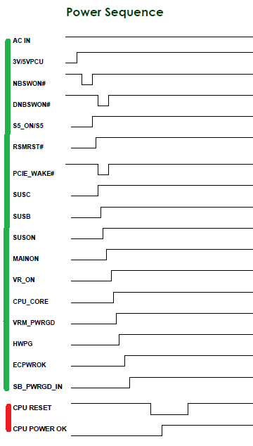

    DA0ZQPMB6C0 REV:C

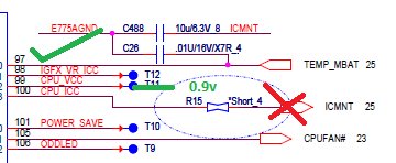

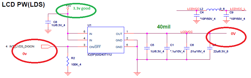

    my acer 4250 is no display. i check all from Schematic sequence (i attach it)
    where can i found CPU RESET and CPU POWER OK..
    look my attachment this is my reading. all voltage is good.
    please teach me how to fix this kind of problem.
    thank you very much..

          No its totaly no other function.its powering on no display. only power LED up.
          Its good now. i decide to cooked AMD CPU. coz that the only not giving right signal.
          now my lappy is fix. i think i need to buy Stencil for that cpu. i know that wont last long now. haha.. thank you sir for help..
