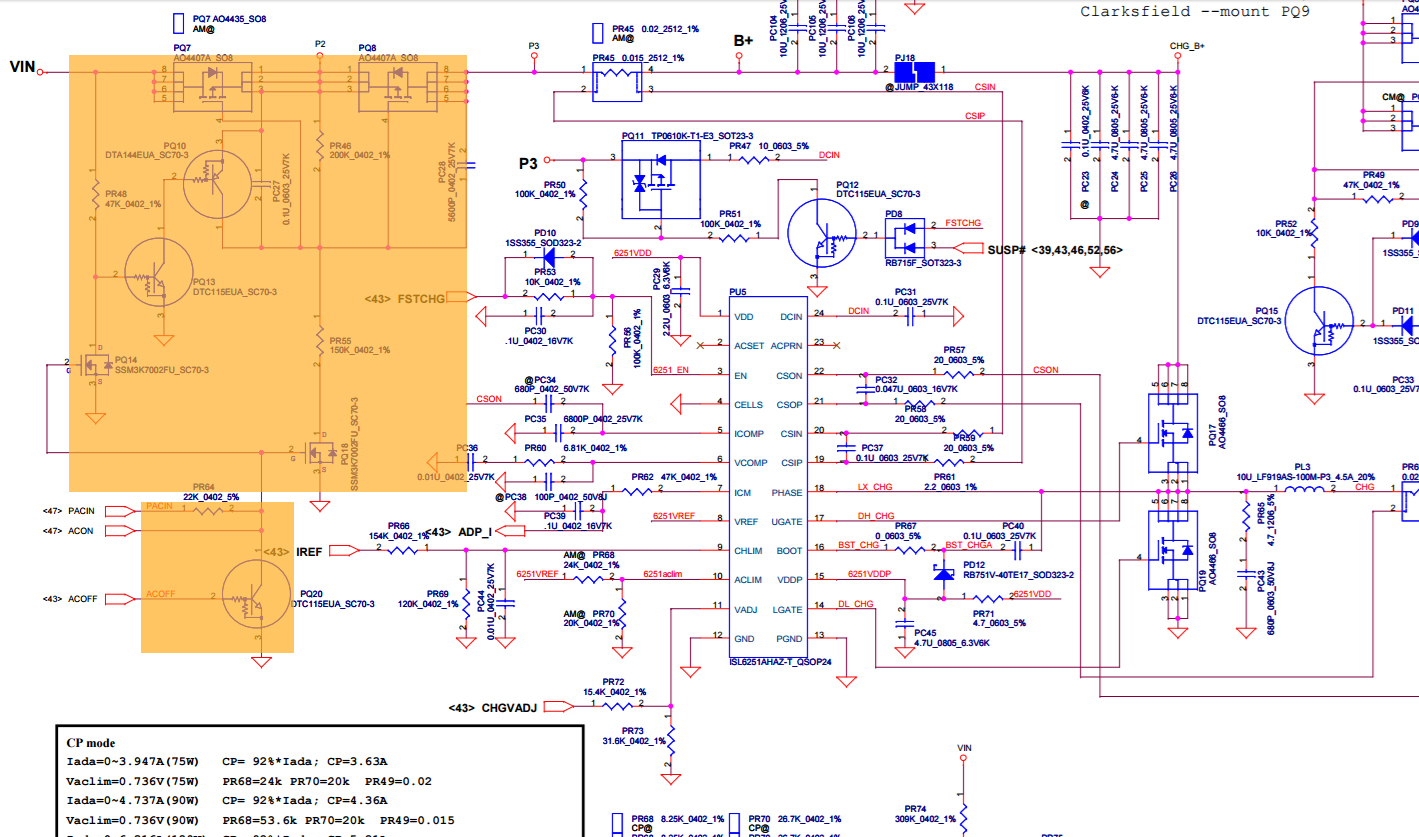

    I have one toshiba a660 with very strange problem... when I plug in charger something on mainboard clicking... I dissasembly everythng and only mainboard with DC port and pluged in charger same thing happening... clicking...
    I use multimeter and something strange happening at PL5 and PL4
    PL5 5.17v and after clicks 4.09v
    PL4 3.33v and after clicks 1.43v
    PL10 0v always
    Laptop won't power on and no battery charging
    Please help

    u have short in some switched power rail. in schematic i dont see pl10.

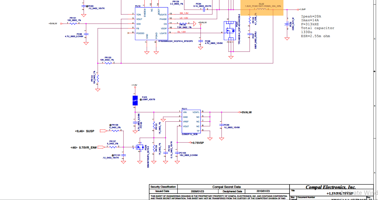

      Here is PL10
      I check mainboard but I didn't find short... I will check again now...

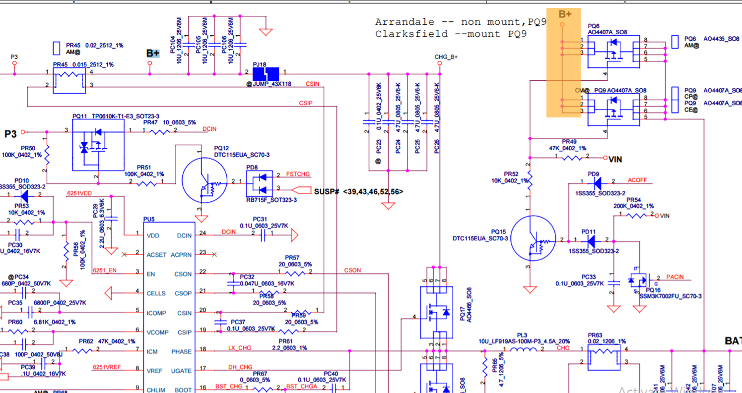

        Sorry, wrong schema....
        Here is right one...
        I didn't find anything in short

          check b+ to all rail... maybe a resistor an open somewhere?!

            as first try another adapter, if making same, than
            inject 19V to B+ line to separate power problem, make jump from dc jack

              Re: Toshiba A660 LA-6062P Clicking mainboard
              I try with different charger... same thing happend
              you mean to put direct 19v here on pq6?
                yes, on B+
                  I try.... put 19v on B+
                  no clicking....now need help where to search for problem

                    power switching part. PQ8, PQ7 and its switching signals
                      Maybe I'm so stupid but I cannot find short on that part... I check all components that I marked with orange...
                      I try to change PQ8 and PQ7 and same thing happening clicking when I plugin charger...
                      When I check with multimetar PC174 in buzzer mod I got 004 value and beeping is that normal?

                        Chec current sensing circuit...PR45, PR59 and PR61.

                          From all the above tests you have short on P2,I would lift PQ8 and retest
                            same thing whitout PQ8... clicking...
                              check gate signals of all trasistors under pq7 in schematic
                                PQ18 0v on gate and when board click after that got 2.16v
                                PQ14 0v on gate and when click got 1.45v
                                  PQ8, pq7, PQ18, PQ14,pq 13, pq10, pq20, pr55, pr64 - all pins
                                    Lift PQ7 and test
