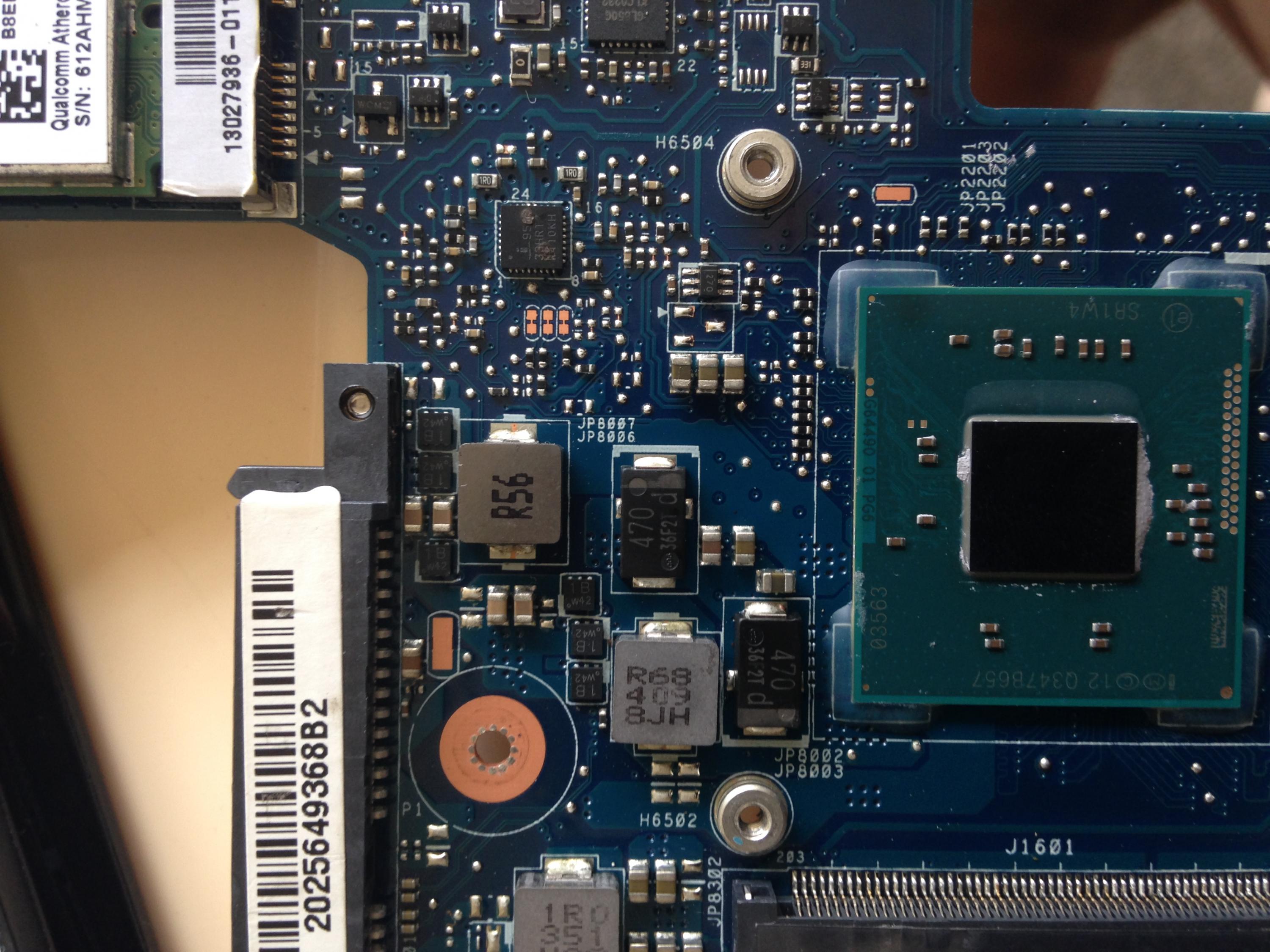

    hi everyone i have toshiba satellite nb10 the problem when i plugged in power button led light steady then after 5 second blink once and steady and so on. so i flashed the bios when here in the forum but still the same problem. i noticed that built in cpu is very hot . what could be the culprit for this please help and advise please thanks in advance

    I noticed also there is no voltage on this inductor near in cpu the R56 coil

          check for resistance on that inductor. and for voltage on it when starting

            No resistance and no voltage on that inductor notebook starts automatically and light steady but there is no display

              if board start automaticly, mainly it is problem with PCH/NB/

                built in cpu is very hot when plugged in it could be bad?
