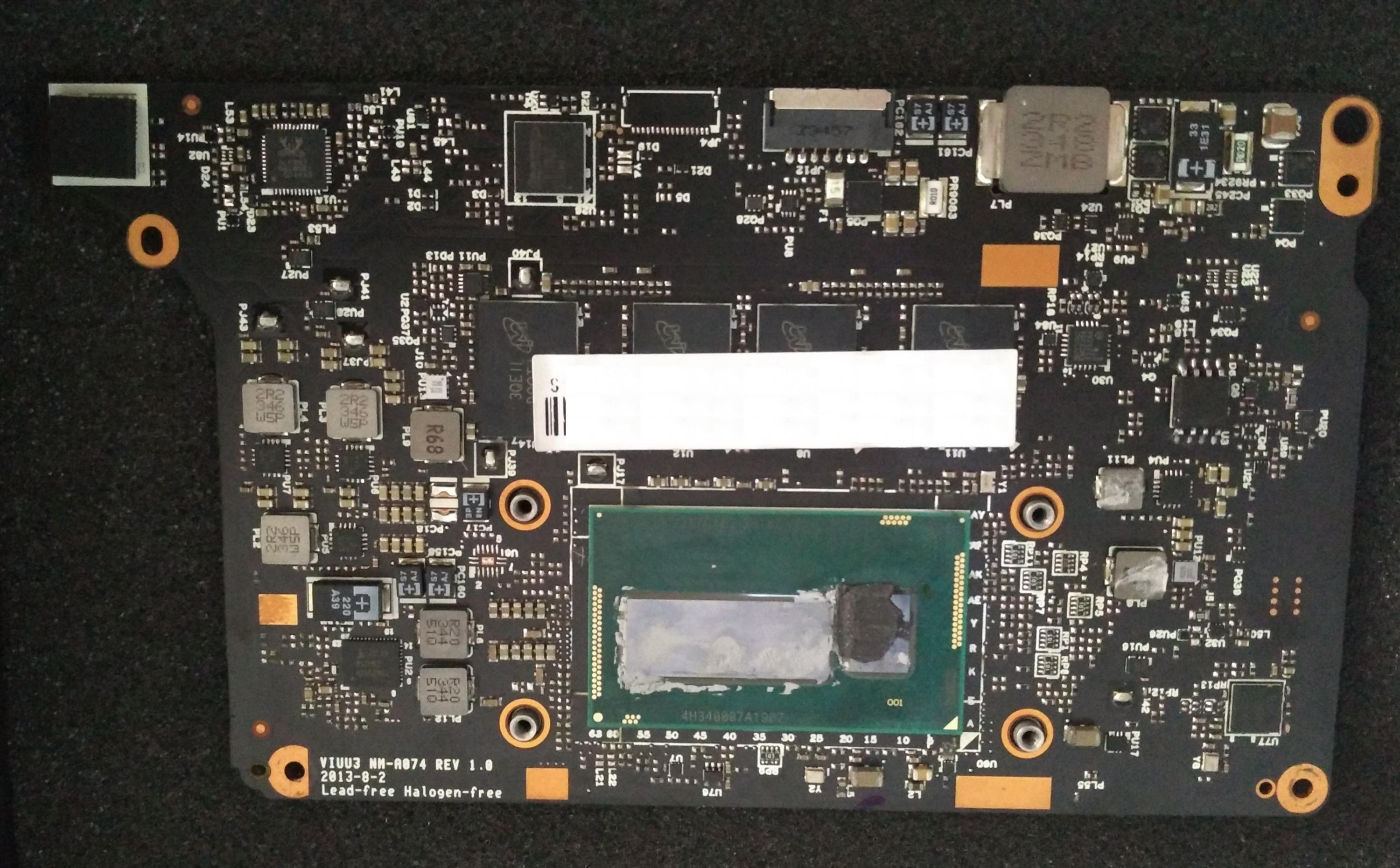

    Hi
    My Lenovo Yoga 2 Pro cannot turn ON. The power Led light and keyboard flashes every 5 secs.
    I search the website, found that its a common problem with this laptop.
    Tried all the fixes but still it doesn't help. I removed the battery, cmos battery and hdd, power it on, still the same.
    could be a mainboard issue??
    Anyone can help ??

      Re: Lenovo Yoga 2 Pro - cannot turn on, keyboard blinking every 5 sec
      Have few of them same issue ,replaced battery charging chip BQ735 i think ,but firs check bios if u can reprogram
        Laptop can't boot at all so cannot reprogram.
        Do I have to remove the bios chip and reprogram it outside ?
        Thanks !
          hi ciki
          i managed to reprogram the winbond eprom with 8Mbytes bin file, by wiring the contacts out.
          but the result is still the same, blinking keyboard backlight.
          I also found an EC file, which chip do i need to program this to?
              You said "cannot turn on", but I had an HP CQ 61 that had a keyboard light blink much like that.
              I would get fan and drive power. Seemed it was reporting a CPU failure...
              Same board manufacturer???
                yes when plug in ac adapter, the keyboard backlight flashes every few secs, blank screen. i can feel the fan is also turning on and off.
                maybe u are right it could be a cpu failure, i also cannot be sure.
                i also cannot find the schematic, to measure the voltage rail
                    i noticed that when i just plugged in the ac adaptor (with battery removed), without doing anything on the on/off button, the keyboard backlight flashes on and off immediately.
                    maybe this is not normal, something is resetting itself.
                      Try replace battery charging chip ,had 2 off them same symptoms
                        i cannot find the chip u mentioned on the board. can u point to me location of this charging chip in image.
