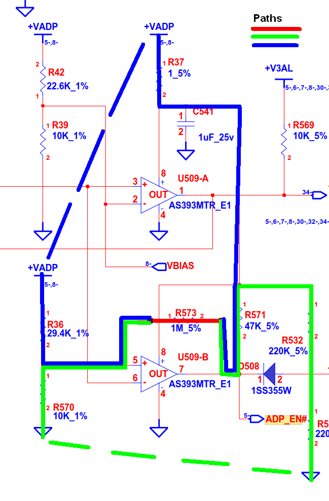

I have a Probook 4515s that will not start. When plugging in power adapter nothing happens. No leds light up. On battery the leds on DC jack starts blinking, indicating low battery.
I have investigated it this far:
Q508 source 19.5v, gate 19.1 v d 0v
-> q508 tested ok
U509 pin 7 = 18-19v (can´t remember)
pin 8 = 19.5v
pin5 = 5v
q508 pin 2 = 9v
r573 = 45kohm (with u509 removed)
Unfortunately I couldn´t find any 1M resistors, will check my scrap mobos when I find them.
Since I don´t have much experience I would like to know if you think I am on the right track?
