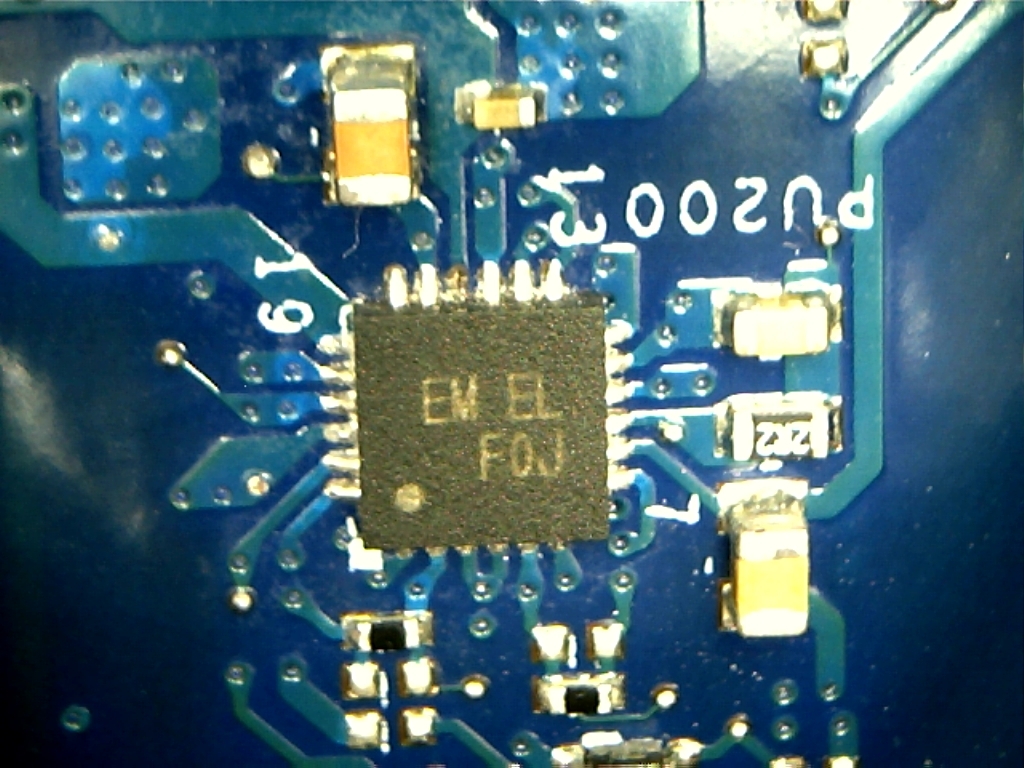

    I have Dell inspiron 15 3521
    MB : VAWOO LA-9104P rev: 1
    On the chip mark EM-EL, what is the right part number?
    On schematic it was RT8205LZQW, is this the right part number?
    I check on it on ebay, the part number was EM-EM, on Aliexpress it was EM-DB or DA.
    Can someone help me to get the right chip.
    Page 47 on schematic

    You are correct, it is a RT8205LZQW. Fairly standard part. EM-xx its marked many different ways.

              I was trying to fix it I decided to remove the ic PU200 when I was doing it I damage
              The pad Is there someone who can help me to
              Fix the pad or what type of cable to
              Do a bridge to fix the pad
