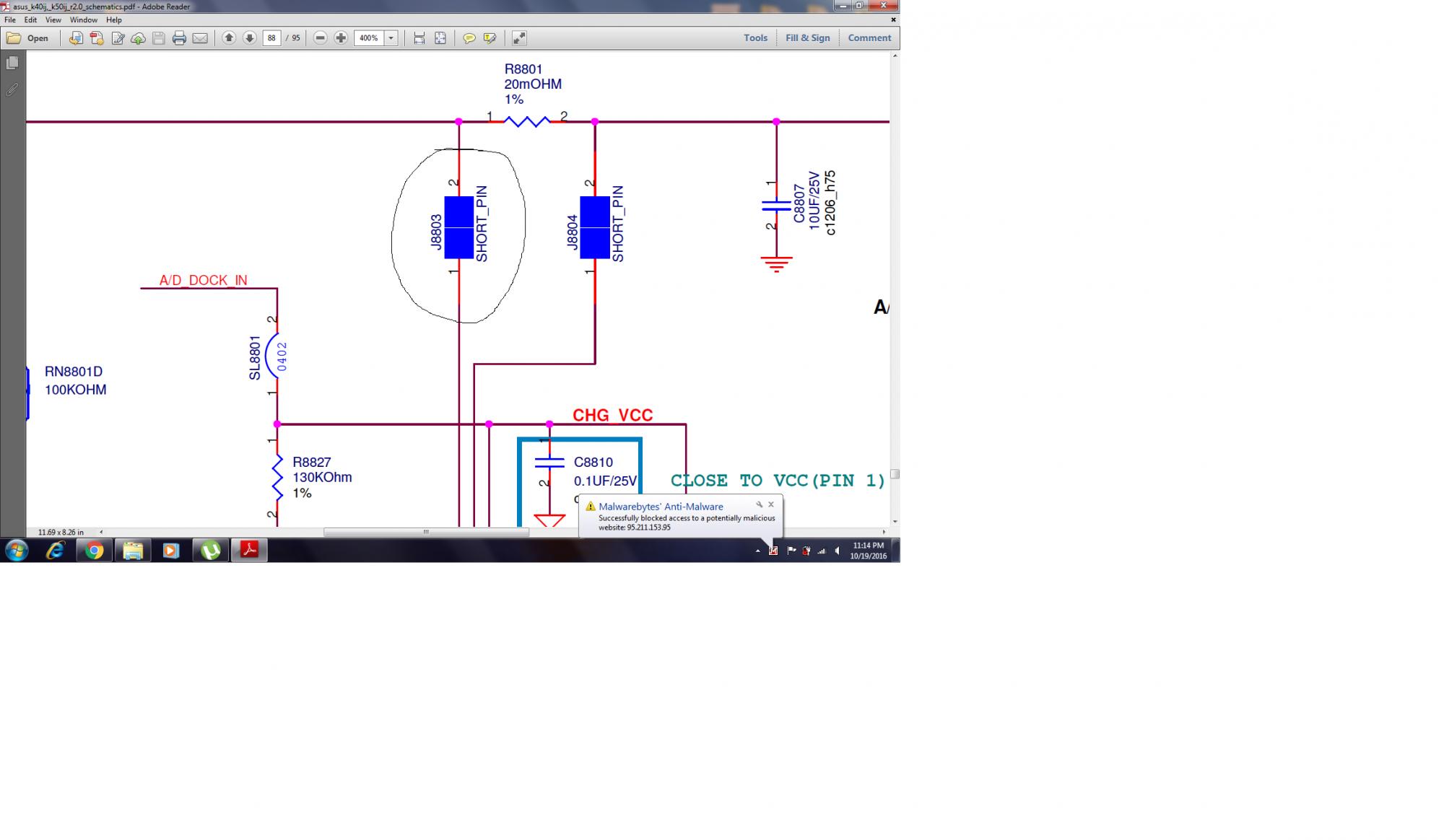

    Asus K501j
    I have found this part burn J88 03
    I looked at schematic and it says SHORT_PIN
    Can someone tell me what is this and how can I replace it.
    Page 88 on schematic

    Re: Asus K501j
    You probably read the wrong marking on the board. J8803 is not a component, it's probably two pads which should be soldered together. You might be looking at R8801, a current sense resistor just next door.
    You should use the boardview to identify the component : https://www.badcaps.net/forum/showpo...69&postcount=3
    You can use OpenBoardView to open it.

      Re: Asus K501j
      I did read the correct marking on the board.It is in schematic page 88 check it.SHORT _PIN I marked with circle see the attachment
