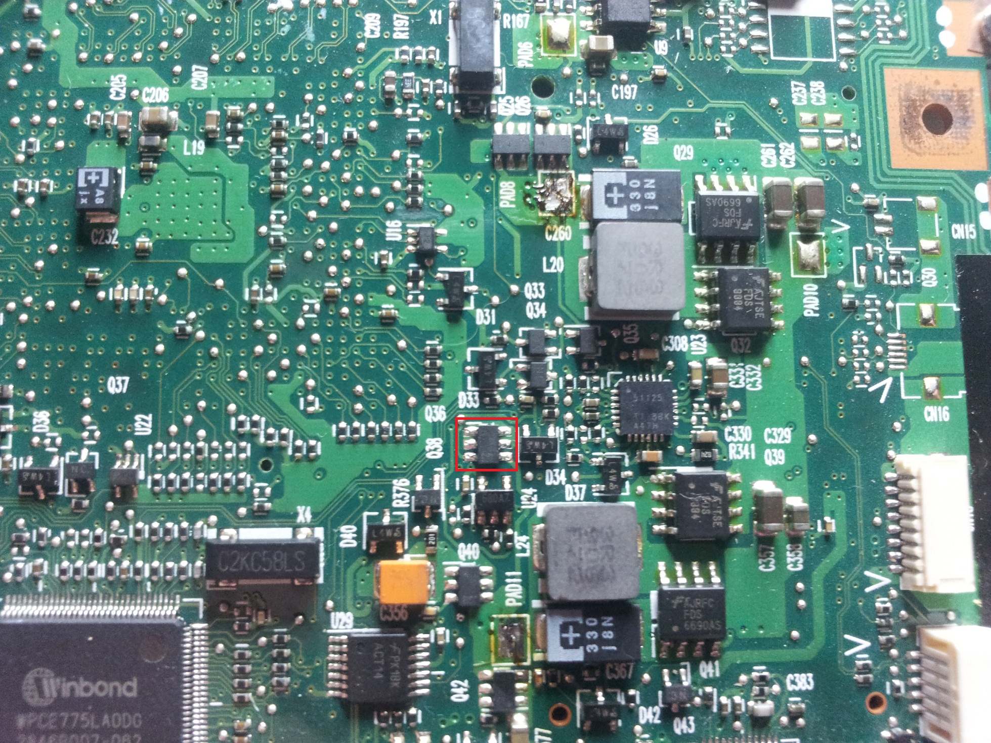

    Hello.
    I have a A300-211 here that suddenly died, no lights, no power on via battery or charger.
    Q802 and Q803 have no output..
    Any advices welcomed

    Switch and U801 miss +V5S and now searching for +V5A that i also miss.
    U23 has the below voltages
    Pin3 2v
    Pin3 3.3v
    Pin6 1.5v
    Pin8 3.3v
    Pin9 4.5v
    Pin13 1.2v
    Pin14 2v
    Pin16 19v
    Pin17 5v
    Pin22 4.5v
    all others 0v.

                    No shorts to the ground on L24/L20 with jumpers removed but i have a intersting clue.
                    With jumper PAD11 removed i get 3.3v at L24 and power on Q41 and Q39, still nothing on L20.
                    With jumper PAD11 soldered i get 0v.
                    Propably a short circuit around there?

                        My fault, with PAD8 soldered or not i get 0v on L20/L24, PAD11 always soldered.
                        Got a little confused with the part writings on the board, 99% sure this is the Q36 that i marked to the picture, has nothing written on it.
                        So in this i measure Pin1-2 0v , Pin3 5v, Pin4 0.8v (with PAD11 removed) / Pin 4 0v (with PAD11 soldered) and Pin5-6 0v.
                        The readings are the same with PAD8 soldered or not.

                            No shortcircuit on Pin1 with ground.
                            Removed Q36, PAD11 connected, PAD8 removed, 5v are still there (pin3) but 3v still aren't (pin4 0v not 0.8v like before) both L24 and L20 have no voltage at all.

                                  Q40 and Q42 (propably this is what you meant) have no shorts to the ground.
                                  I remove the Q34 and 3v appeared as they should to L24. That's a useful clue.

                                    Correct, when i connect the adapter on mains i get 3V at Pin4 on Q36 for about 1 second, then drops to 0v.
