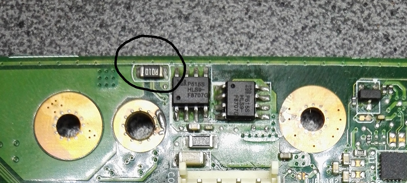

    It seem +AC_BAT_SYS shorted to ground
    There are only 2 pieces resistor on these board. the value are 10 miliOhms
    The one for +AC_BAT_SYS (+A/D_DOCK_IN_Q_Q), and the other for +BAT (+BAT R).
    These part easy to find it which marked R010
    You could remove one to isolate the shorted. then identify goes to where is line have the short

          I assume you 've removed the resistor then put your DMM on the pad which side the resistor is shorted to ground? Do this without adapter plug in

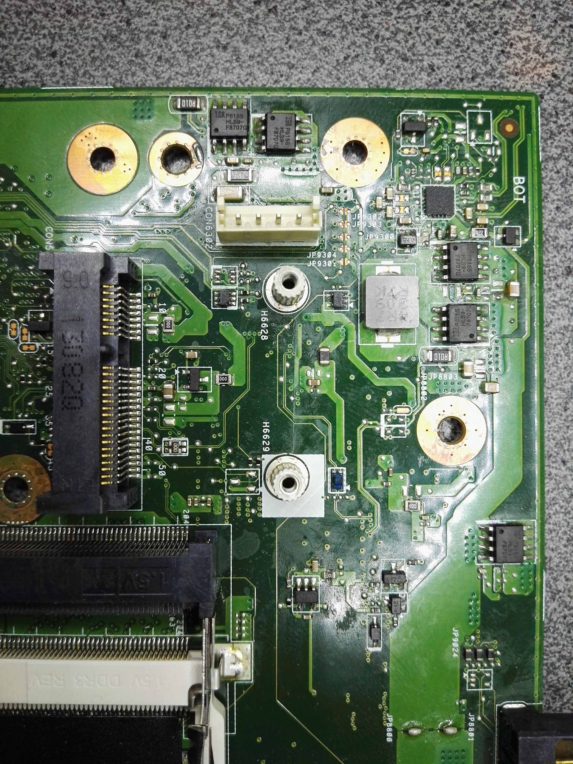

              That best idea is to make photos whole board (top and bottom sides)

                        There are many components that may be the cause short circuits in the path of this ac_bat_sys, not sure 100% just the BQ chip.
                        https://www.badcaps.net/forum/attach...1&d=1474145129
                        I made some screenshots that could be help you trying locating short circuits.

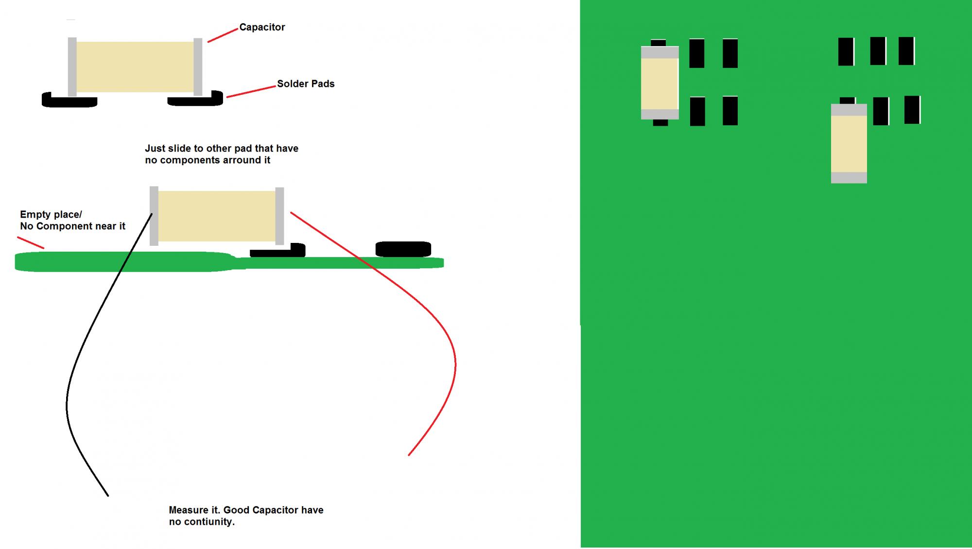

                        Tips from Th3_Un1qu3:
                        Another way of locating shorts (or at least narrowing down on them), is isolating the individual blocks of the board.
                        It is highly recommended you have a schematic for this. It's very hard (but not impossible) to do this without one. First remove everything from the board. RAM, CPU, Wifi, etc. If it is still shorted, follow:

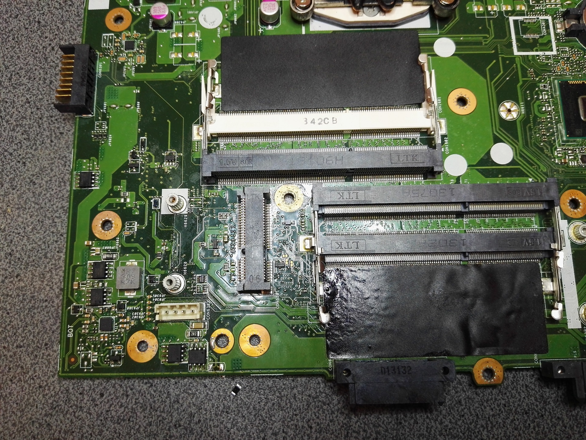

                              I recommend you to remove CPU, RAM, Wifi card first.
                              - Try to measure of All big coils to ground (Diode mode)
                              - Check all HS mosfet if ok
                              - Give focus on all ceramic capacitors that written in "Comp.txt". Try remove one by one with slide technic, would it be minimize risk lose these capacitors. if you put in other places probably you'll miss it. Capacitor would be change color and little crack if them has broken.
                              -If short sircuit still in there, only IC PWM has big chance have been shorted (already on .txt)
