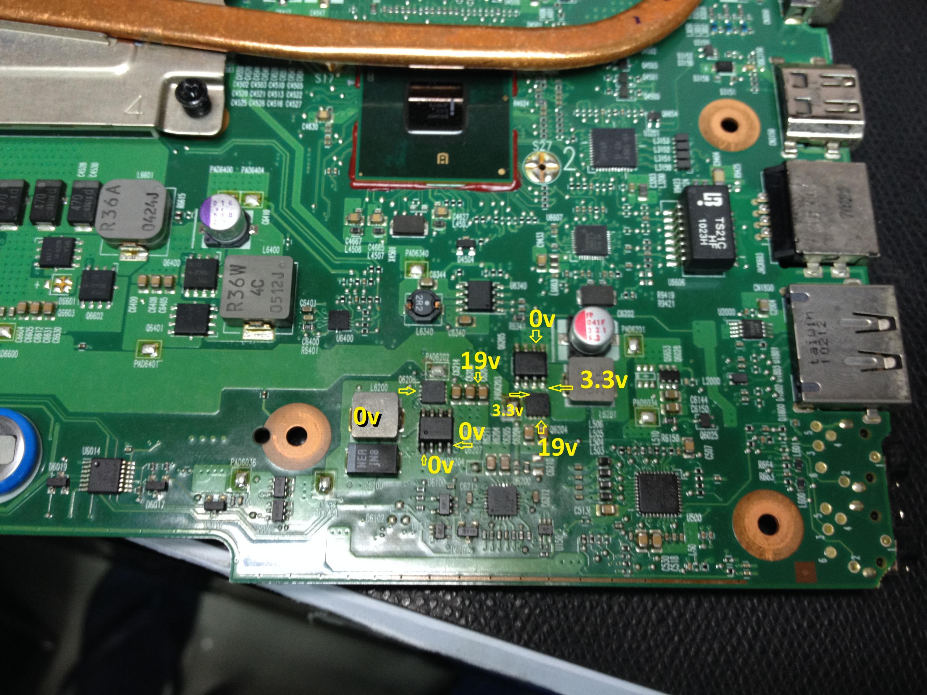

    toshiba satellite L655 no power
    hello everyone... hope u could help me..
    first check was 19v is lo volt it just 2.5v something like that. then i replace one mosfet. then is works its now 19v.
    but still no power.
    checked 5v and 3.3v ic i found 3.3v only...
    here i write down reading of dc/dc ic TPS51125
    PIN
    1. 0V
    2. 0V
    3. 1.98V
    4. 3.3V
    5. 1.2V
    6. 0V
    7. 3.3V
    8. 3.3V
    9. 7.6V
    10. 3.3V
    11. 3.3V
    12. 0V
    13. 1.5V
    14. 1.98V
    15. 0V
    16. 19V
    17. 4.96V
    18. 0V
    19. 0V
    20. 0V
    21. 0V
    22. 4.48V
    23. 0V
    24. 0V

    Re: toshiba satellite L655 no power
    Make sure that 5v isn't shorted.
      yes it was not shorted. i checked coil, mosfets, and caps around 5v area no short.
