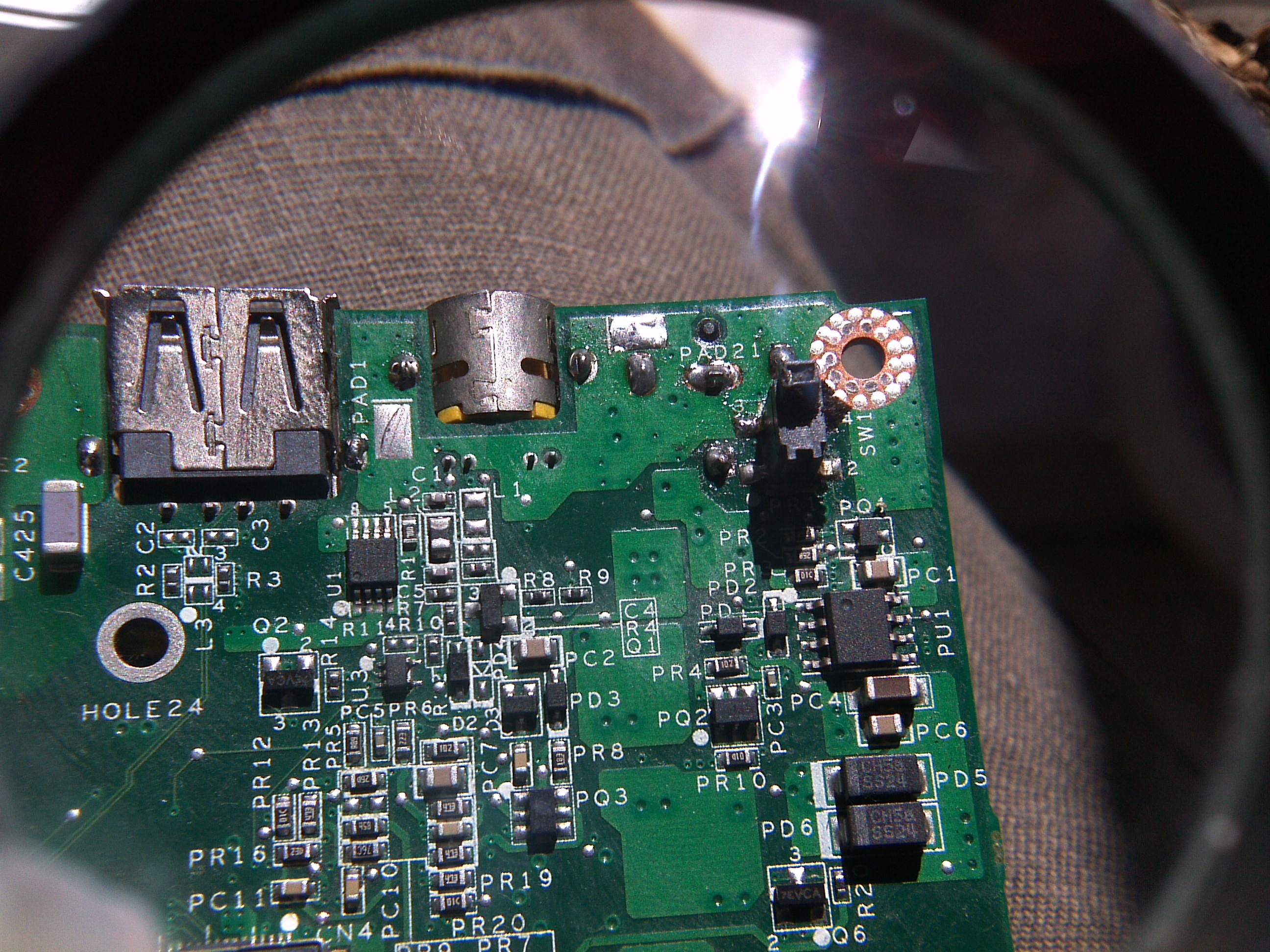

    the ancient TOSHIBA L10-102 SUDDENLY SHUTS AND NO BOOT for a WHILE.
    battery is already dead.
    and LAN jack doesn't work.

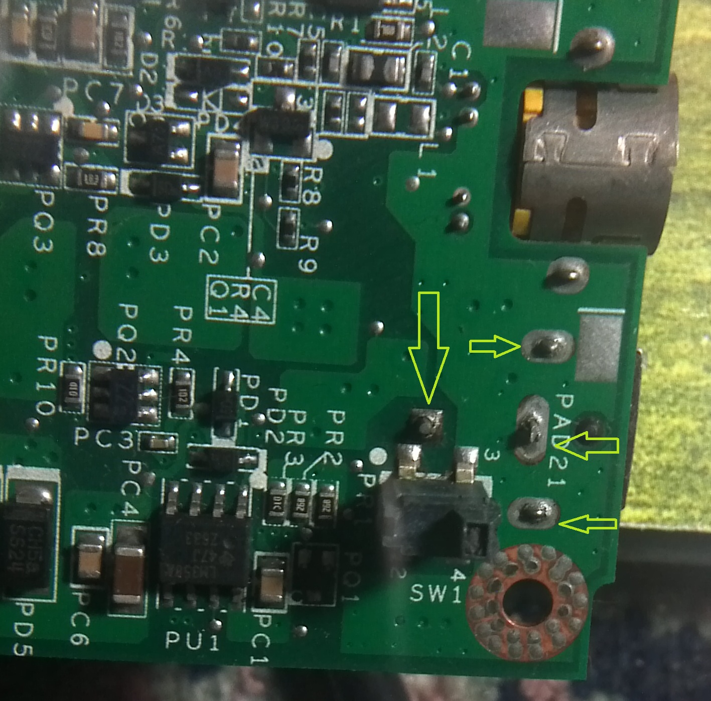

    first i suspect fan. i clean and refresh termal compound.
    and i remember that LAN cable come from upper flat.
    because of rain jack is rusty.
    i fix this board as you seen at picture..No problem at all. No shut. Lan works.. i resolder Lan and adapter jack..
    due to heated adapter jack's hole spreads and no connection no boot .
