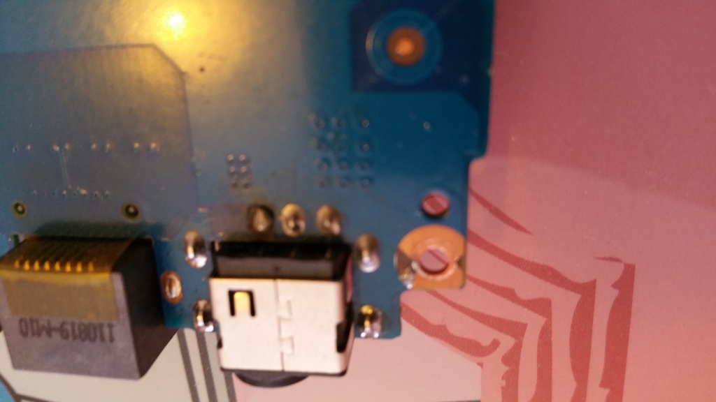

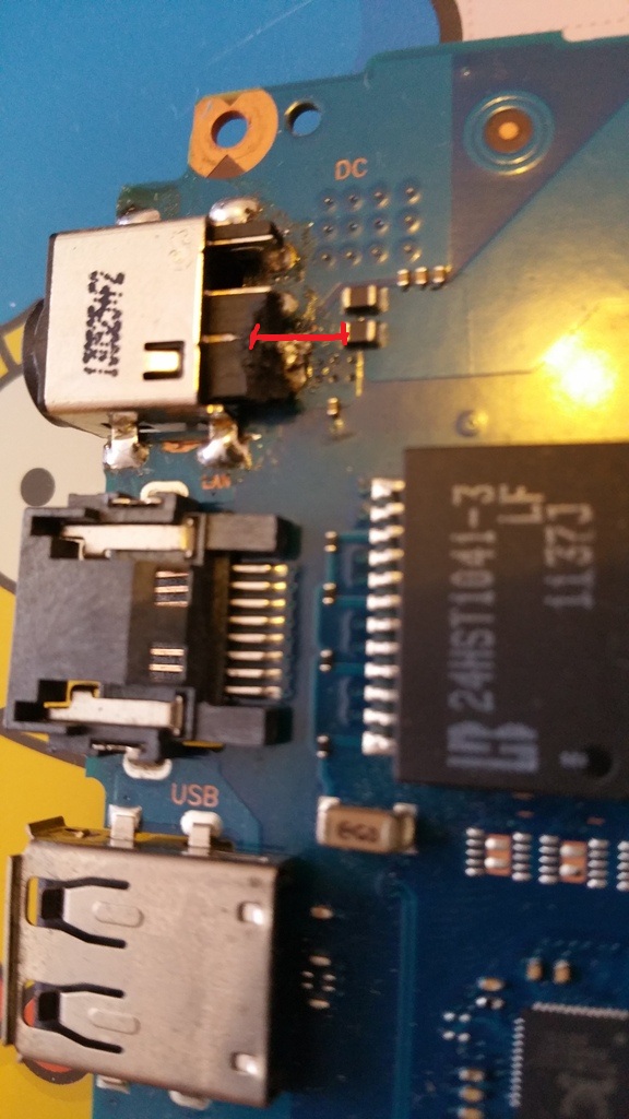

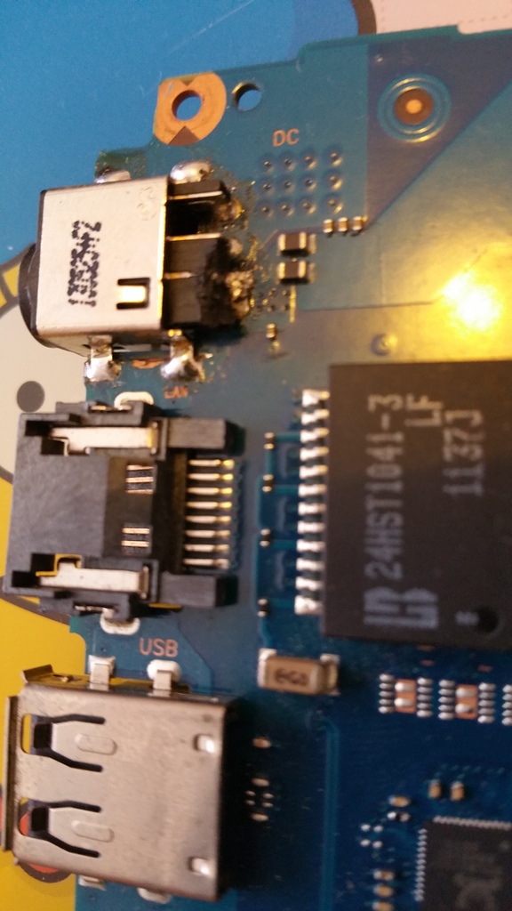

    Hi Guys i do alot of USB socket repacements and also Power Jacks. This one has just come in as not powering lol. some of the screws were missing which i hate but i trundle on. i have posted some picks as the power pin pad is gone oh the joy. so if anybody has any ideas please apart from shooting the not so bright spark who attacked it then i would be gratefull many thanks. i will replace the Jack anyways but need some help as to where to run the power pin to please. the first 2 picks are how it arrived yuk.

    hi any help at all please or a system schematic if possible any help appreciated.

      Just make a bridge with a wire here.

        many thanks i will give that a go i still have much to learn and so little life left to learn it in lol
