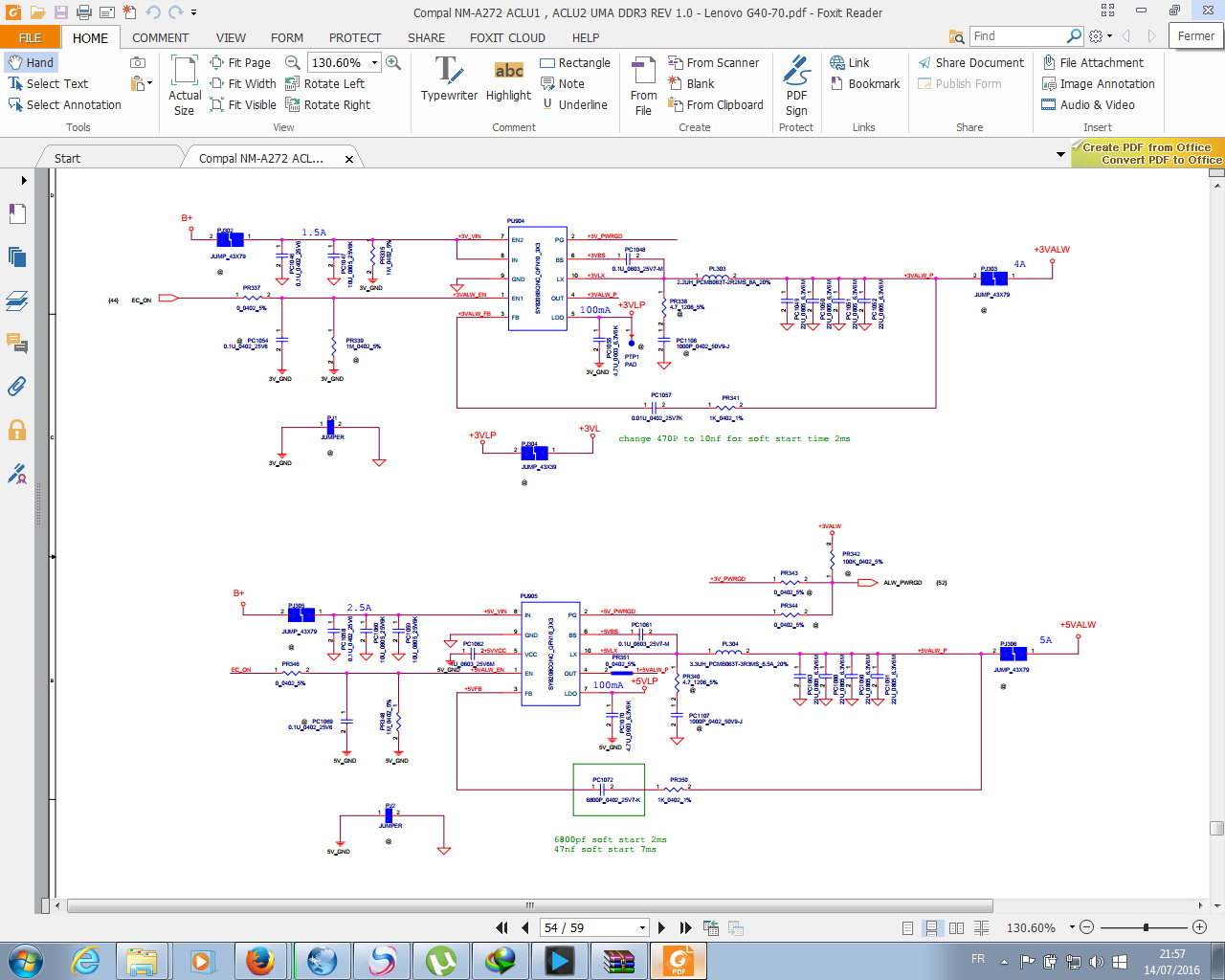

    Hi all guys! I got this motherboard, from a Lenovo G50-70 with a strange problem. When I connect power supply or battery and I push power on button, the power LED lights on, but nothing happens. No fan spin, no signal, no hard disk spin.
    I checked the board, and at first visual inspection I can't see nothing burnt or damaged.
    I checked PQ301 and i got :
    1 - 20v
    2 - 20v
    3 - 20v
    4 - 18.50v
    5-6-7-8 20.40v
    Seems to be normal. I'm going to take some other measures and I will edit the post. If someone can give me some hints will be appreciated. Thank you, and sorry for my bad English.

    PU301 not PQ301
    and what about IT 8586E and PL303 .PL304
