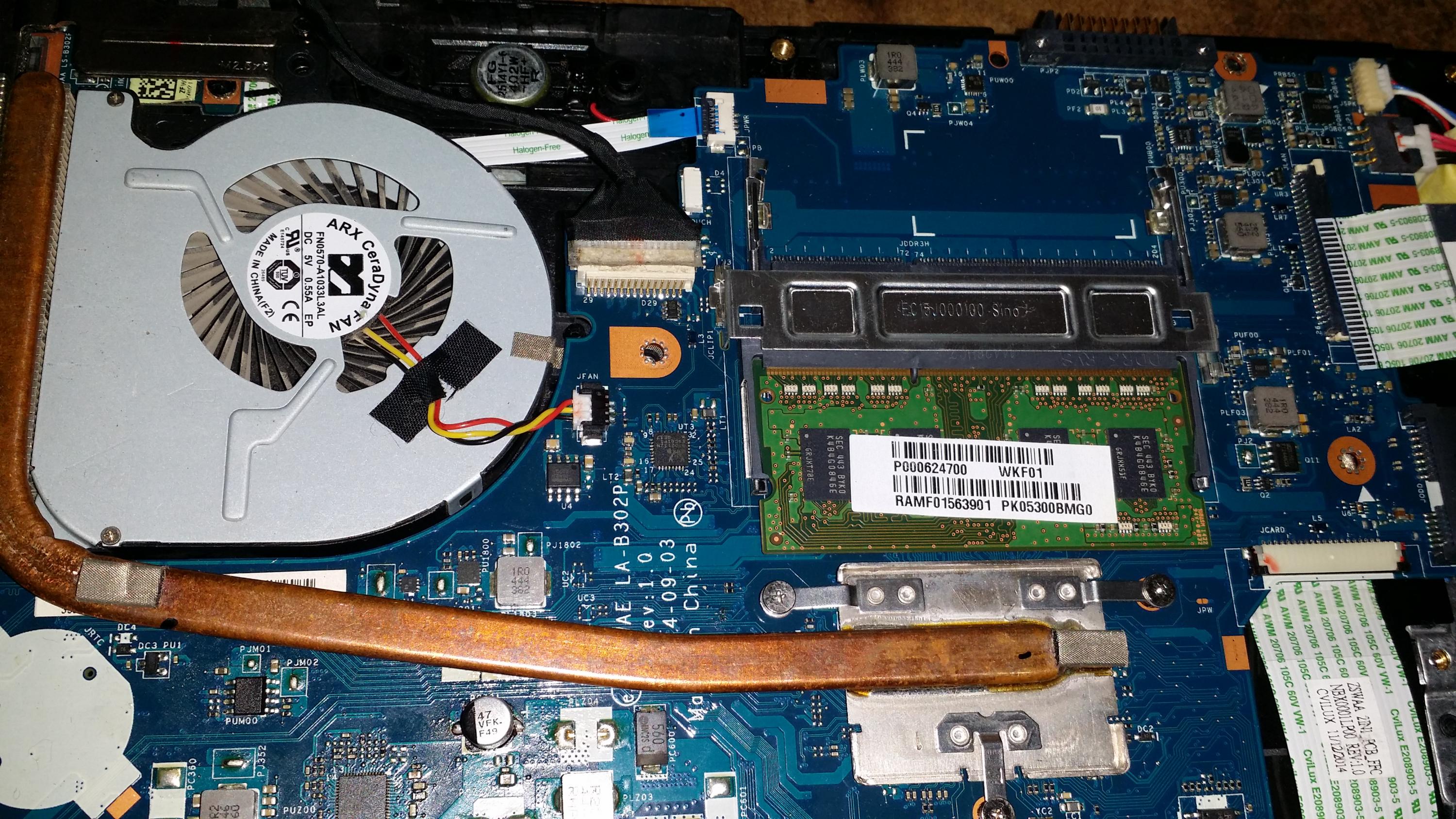

    I salute Brothers, please i need help for this Toshiba Satellite C55D.
    when you connect the signal cable and you Boot the Machine then with some minut it gose off, but when no screen cable then Machine will on but won't go to the main screen

    Its hard to read...
    It sounds like; When you have the signal cable(screen cable) plugged in the laptop goes off after a few seconds(or a min w/e). When you unplug the signal cable(Screen Cable) it works fine?? But it won't go to the main screen? What do you mean by that? Do you have the laptop plugged in on a External Monitor if so it makes sense...
    1. Check the cable end to end with a multi-meter doing a simple continuity test. Direct connection, use the diode test option... make it beep beep :P if that makes sense...
    2. Check the screen, try another screen on the cable.
    3. Re-try on what you are trying to say or experience.
    Extra: I had issues with cables and LED / LCD screens many times causing running issues.
