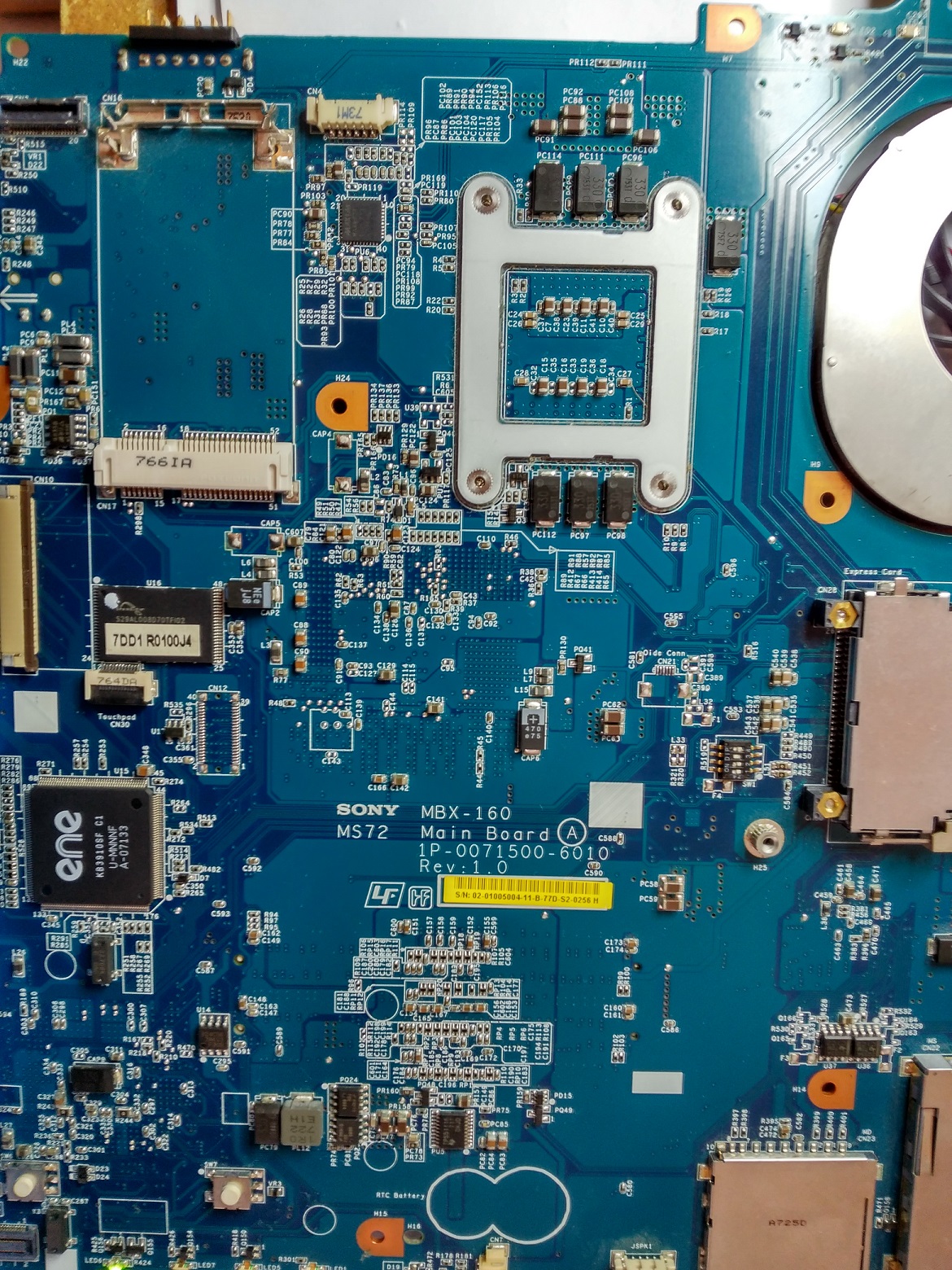

    Motherboard: MBX-160 Rev. 1.0

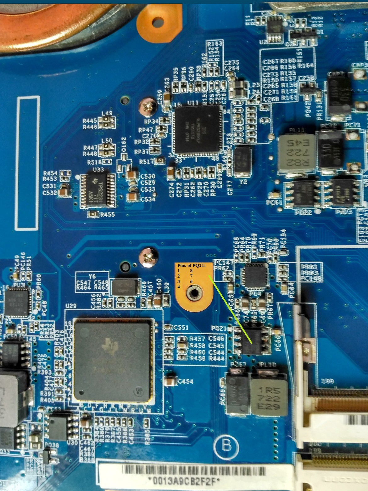

    When visual inspecting the board i found the PQ21 (IRF7904PBF) completly burned out and replaced it but no change on the problem.

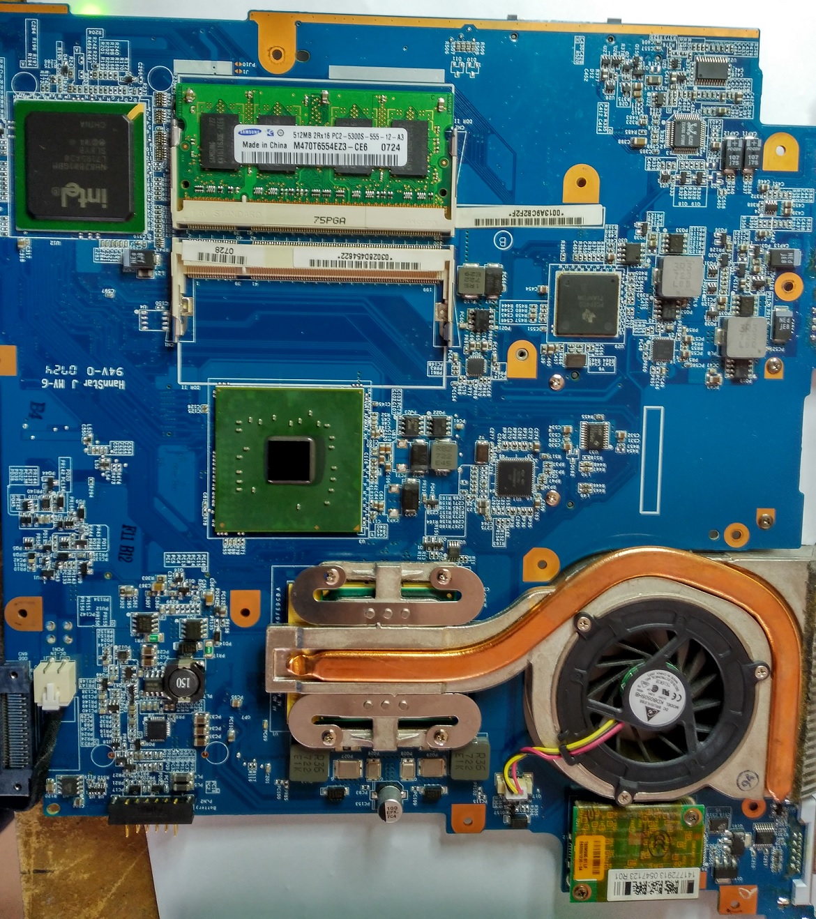

    I've attached some photos of the board and the schematic.

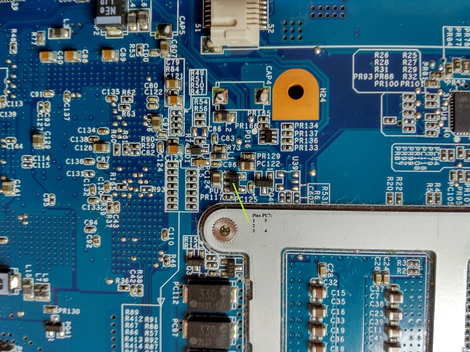

    I've found that the PU7 was getting very hot when i turn on the board. I attached photos of the PU7 and PQ21 zones.
    Here are the measures i made with the board ON:
    PQ21 pins:
    1- 0,11v
    2- GND
    3- GND
    4- 0,015v
    5- 0,09v
    6- 0,09v
    7- 0,09v
    8- 19,6v
    PU7 pins: (this one is hot with board ON)
    1- 3,26v (IN)
    2- GND
    3- 3,3v (SHDN)
    4- 0,86v (SET)
    5- 0,18v (OUT)
    If anyone has an idea what could be the problem.
    Thank you! =)
