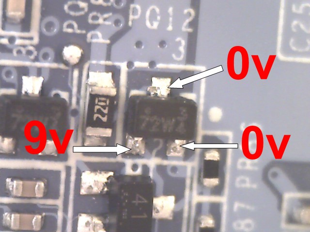

              i check coils between ground it's not correct ?
              VREF, REF IN and PGOOD have all 0v
              PQ12 see photo
              Best regards
              JOVY RE7500

                Re: Sony vaio SVF1521C2EW /DA0HK9MB6D0 REV / doesn't start
                No SUS_ON, Or other voltages at PU4, check VCC, AVCC and VDD at NCPE885.
                But strange thing is that almost all of your coils are with low resistance to ground.
