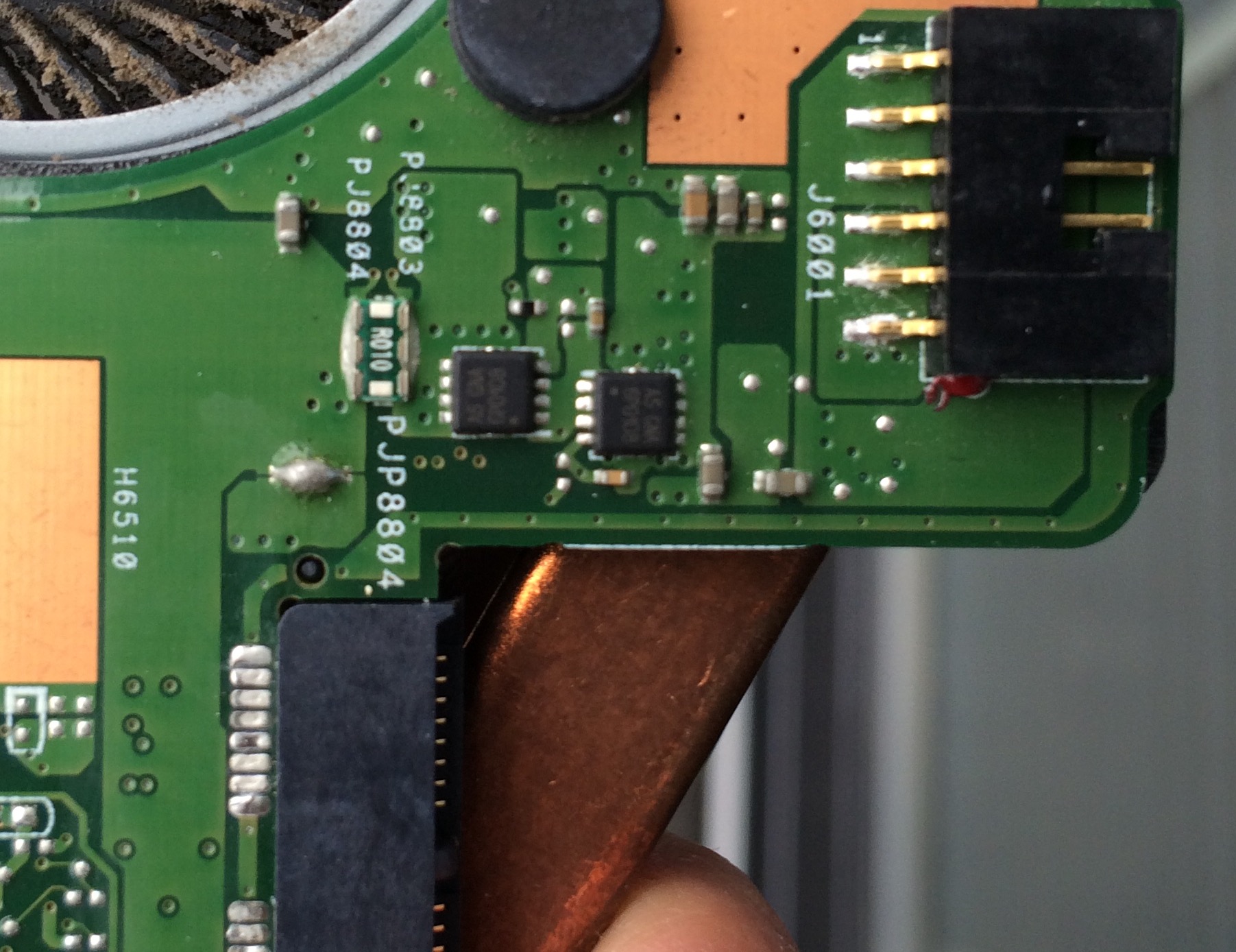

    Hello all,
    On my Asus N76NV I am suspecting a bad MOSFET (near-zero drain-source resistance) but cannot identify the part 100%.
    The part is marked:
    A5 GNA (sure)
    GP0108 (not sure)
    See photo in attachment.
    This is the RBFET that matches the TI BQ24725A reference design.
    Motherboard rev. 2.0.
    Laptop only ran on remaining battery charge, did not charge, did not power-up without battery. It did power-up when I put 19V on the drain of this MOSFET.
    ACOK=2.87V
    ACDET=2.57V
    I would like to find a proper replacement locally (.eu / .nl), any help appreciated to identify and find a replacement!
    edit: might be PJ8804 according to the silk screen, I am interpreting this right?
    Thanks all!

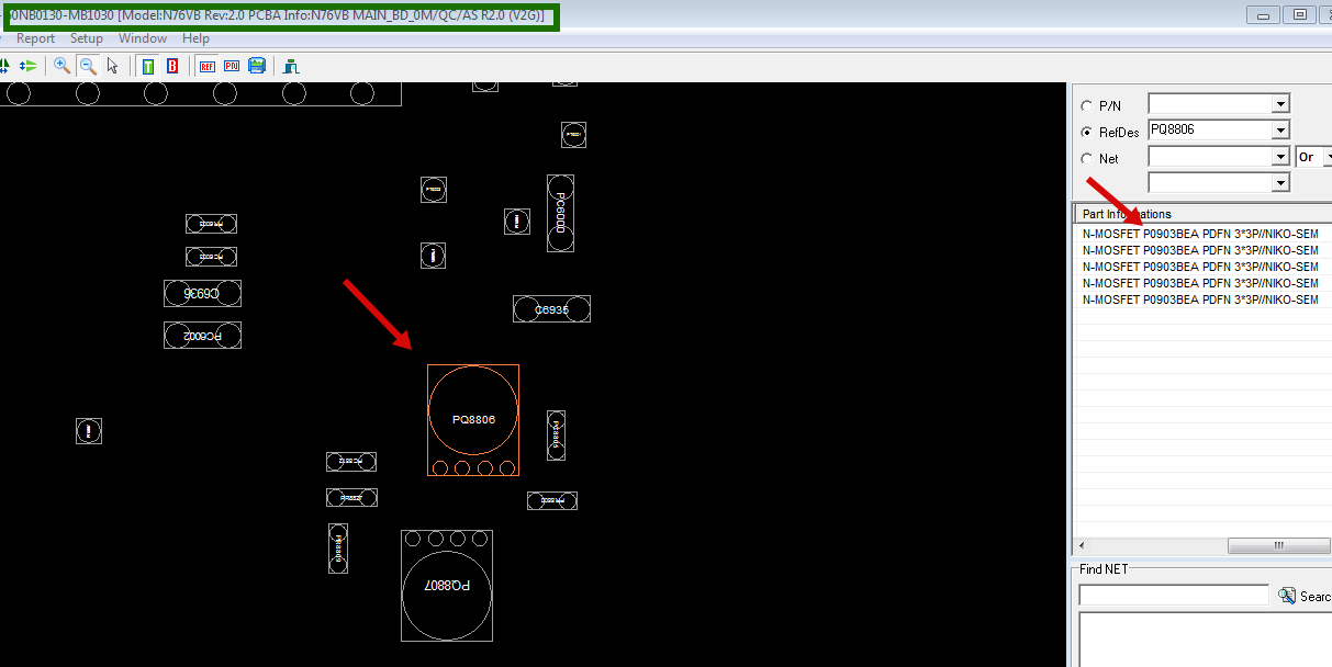

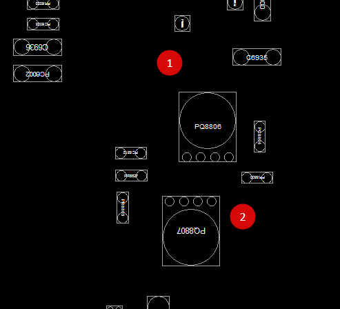

    1 - pq8806 - n-mosfet p0903bea
    2 - pq8807 - n-mosfet p0903bea
          you say it's N-mosfet based on boardview, right ? did you ever measure it? It's P-Channel mosfet.

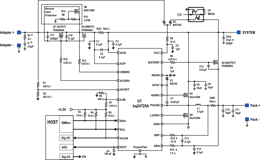

            How would the (schematic) design differ from the bq24725a reference design, where the datasheets specifically mentions it drives N-channel FETs ACFET and RBFET?
            Can someone explain why there are two identical MOSFETs placed with a common source, in opposite directions? I'm trying to understand how this design works.

                  Re: Asus N76VB identifying 'A5 GNA'
                  this is what shows ASUS N76VB (60NB0130-MB1030) REV 2.0 - BoardView
                    In your screenshot there is "N-MOSFET" in front of "P0903BEA".
                    Also, the datasheet of P0903BEA mentions "N-channel MOSFET".

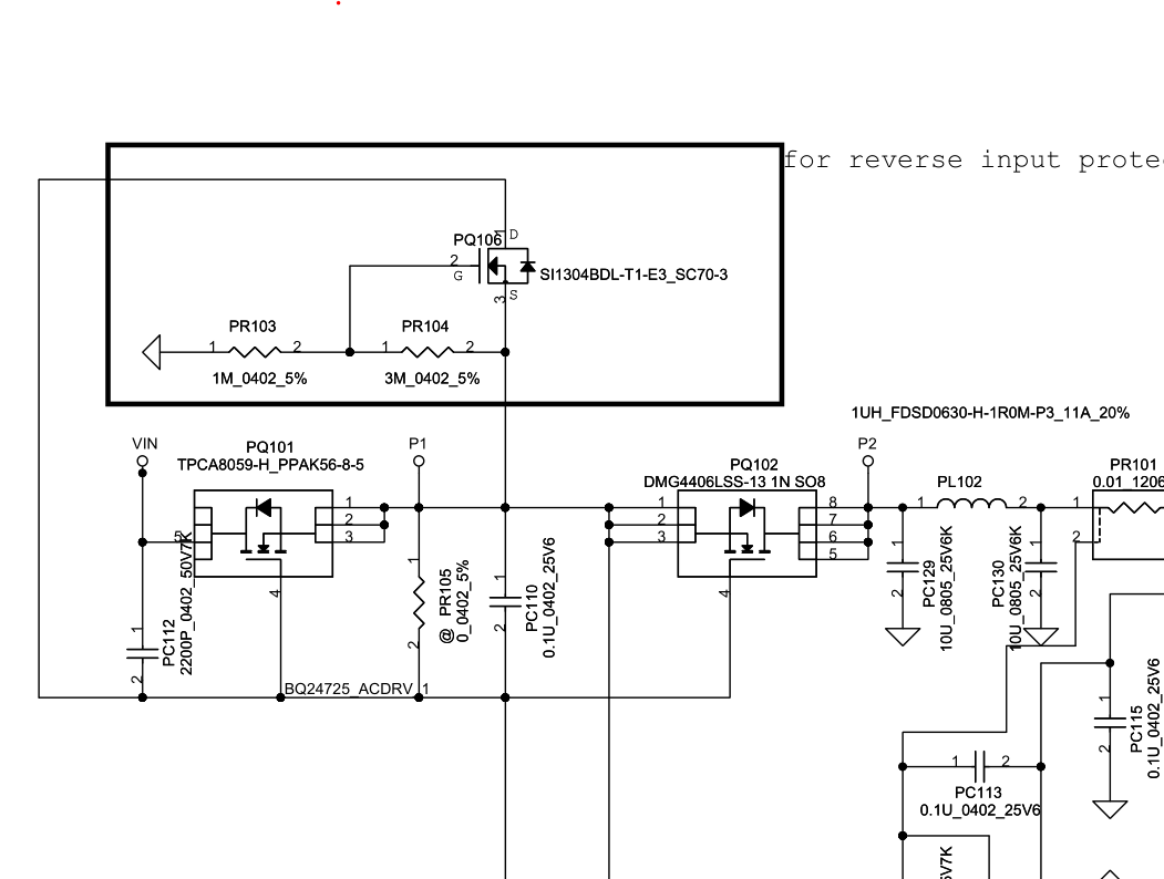

                              an example of the circuit
                                    I do not understand why you guys think the A5 GNA is a P-channel MOSFET. I have not seen any evidence in this thread. On the contrary the BQ charger IC datasheet specifically mentions it drives N-channel type ACFET and RBFET.
                                    I have therefore replaced the 2nd jack (RBFET) with a Microchip MCP87130T-U/LC MOSFET, N-CH, 25V, 54A, 8PDFN.
                                    Laptop works again.
                                      That's an N-channel symbol it seems to me. I do not understand why it is depletion though.
